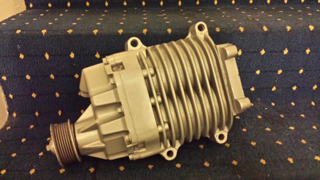

Just thort id start a thread for my project! Ive not done much so far but ive already done the m50 conversion and its runing sweet. Ive bough a gen1 Eaton m90 twinscrew charger from a jaguar xkr and ive just rebuilt it.

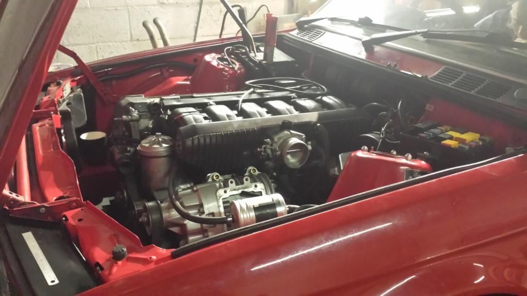

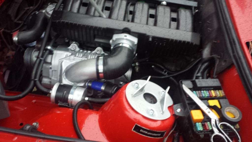

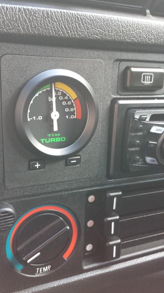

Eaton m90..custom brackets..custom belt & tensioner..custom intake & re routed afm and icv. Needs some 440cc injectors and a miller war chip. Adjustable fuel reg. Yeah..she runs now aha need a custom boost pipe making and a fitting for the forge 007p valve. Running no cooler as of yet due to around 9psi. Im also aware my boost guage says turbo....

hi mate looking good :) i am in the process of twincharging my 325 turbo using a eaton m62 'charger..got it initially mounted up, and am using a m50 serpentine crank pulley instead of m20 a/c pulley to get everything running before getting custom pulleys made for more boost-how did you line up the s/c with the crank pulley? is a straight edge across both enough to get the belt running true? cheers, cant wait to see yours when it is done :) ash

Yeah ashton a straight edge is what i used..got it sat against the waterpump pulley and pas pulley then when by eye..made my brackets adjustable too so i fine tuned it from there. Also made a custom alternator bracket and tensioner system for the alternator to run from as thats where the AC pump used to be. The alternators gona be running from the Ac pulley from the crank too. Nearly done now tbh..just need to weld a fitting for a recirc valve onto my charge pipe then fit an adjustable regulator for the time been. Can you post vids on here from mobile? If youve got fb pm me your name and il tag you in the vid if not. Sounds iimmense haha

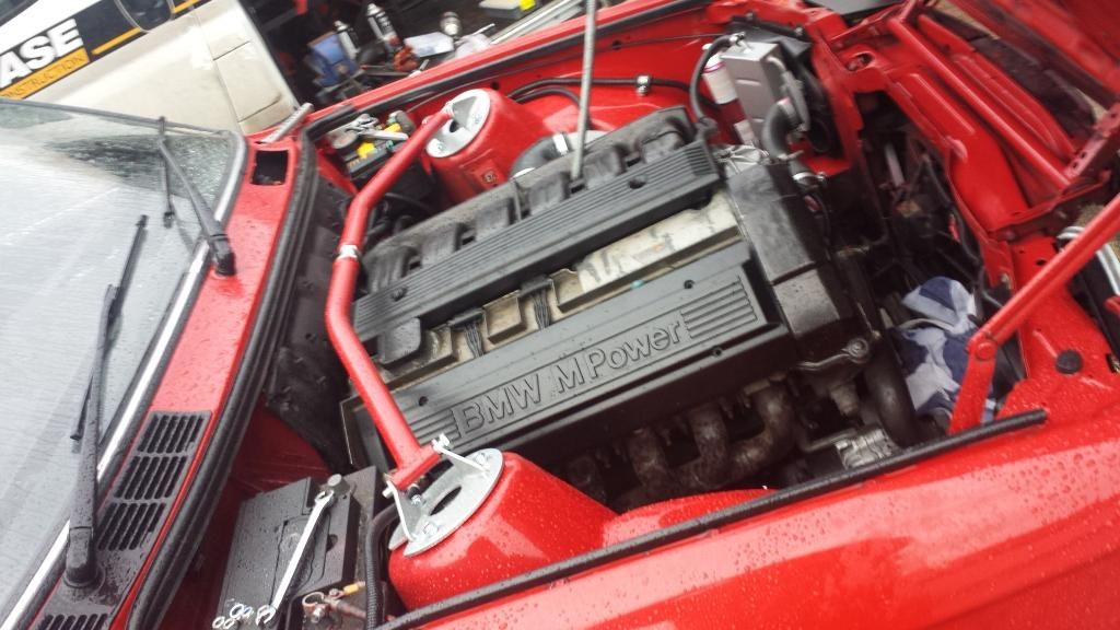

trying to retrofit an s50 m3 coil pack cover on lol
got my new radiator for it, need to make some new brake pipes up and plumb in the hydraulic handbrake and some other little bits then shes good to go!
running bosch 440cc green giant injectors and a miller war/402 ecu with a base charger map/330cc injectors, so il fine tune it with my wideband and hopefuly make some good power!
