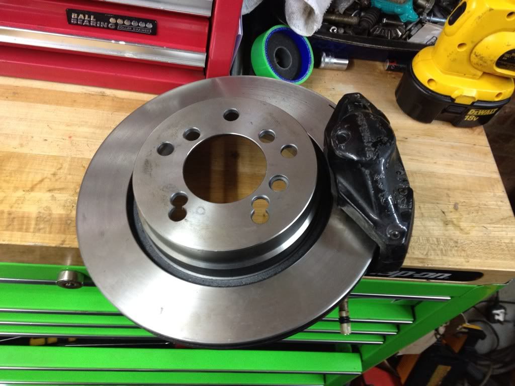

Also managed to get some rear brakes sorted, E46 discs with some nice porsche 2 pot calipers. Just got the bracket to make.

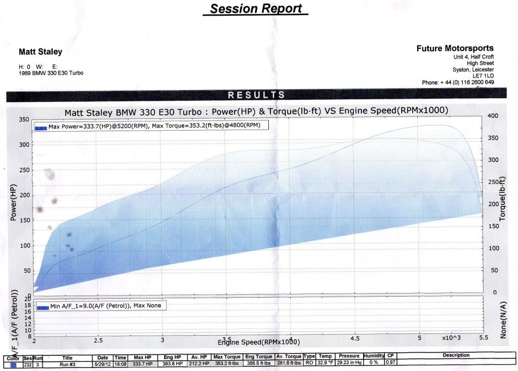

This is from the start of the week. Hes done quite alot since.
350 is a good start. Its going back monday for some tweeks.

To squeeze 100bhp per litre from an old boat anchor is pretty miraculous - congratulations!

You must cross 400/400.
It´ll be a freaking blast like that.

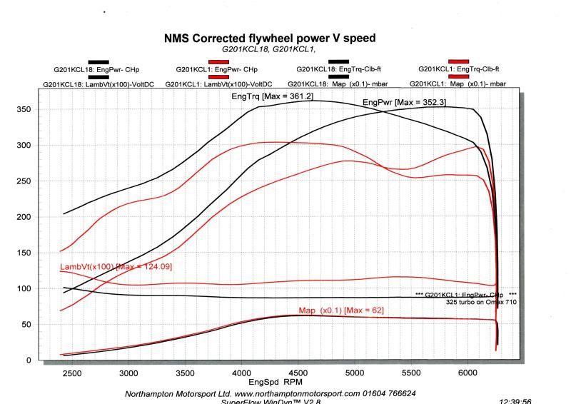

You can see the lambda "dip" just after 5k, This is the fuel pressure reg failing. I have an FSE fpr and I wouldn't recommend them for injection systems. I ordered a turbo smart one as ive heard some good things about there products. With this fitted and maybe a little more boost I think more power is quite easy. Although there's not a lot of grip

New frp fitted, and another day of mapping. The fuel stabilized, but there still is an issue with the fueling that needs to be investigated.
The bhp has gone down to 304bhp, and stays there from 4k all the way to limiter. Torque had gone up to 536nm

A loss of 48bhp - just down to the FPR change?

So there is an explanation for the loss of power from the last map. Basically very poor mapping.
Please - if your going to get anything mapped give area 52 a miss.
Anyway, we spent a few hours on Friday night going up and down the M69 and the results are great.
I took it for a power run tonight, results -
Up to 333 Rear wheel ponys. I think that's a massive improvement and it feels like a different car!

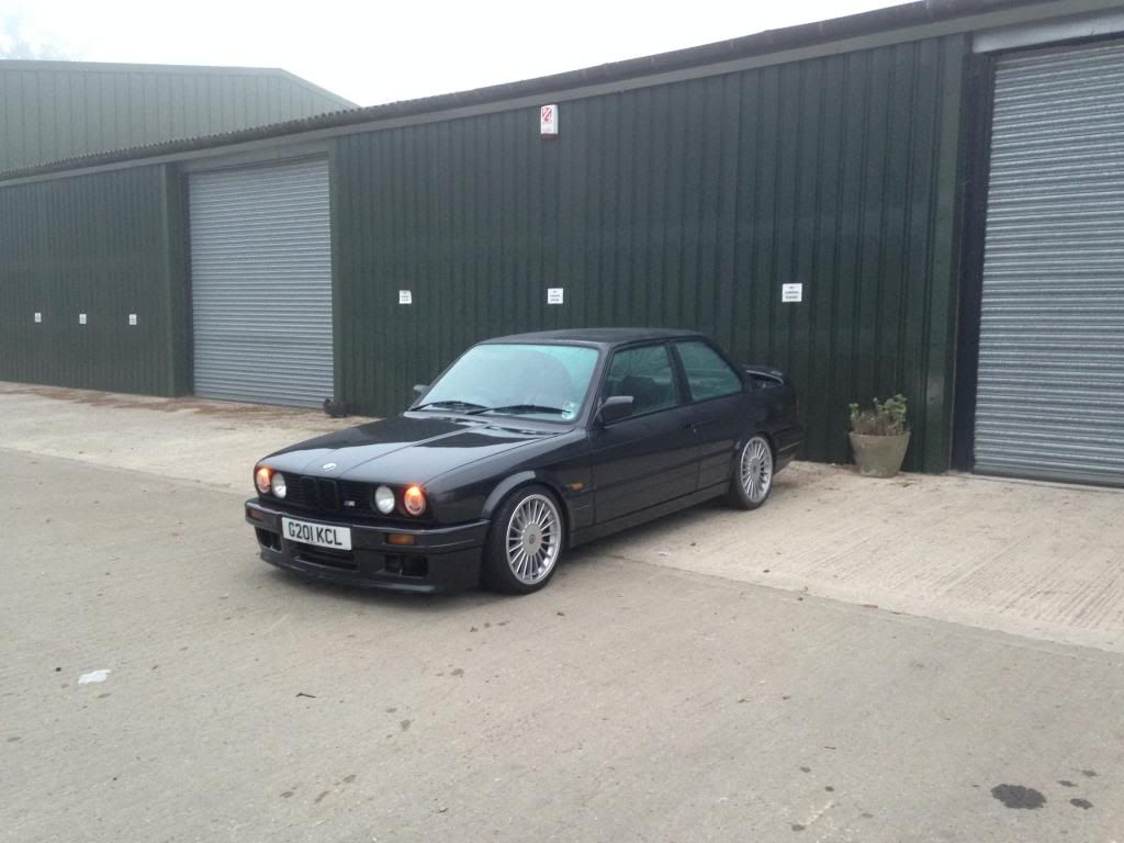

Few pics from curborough. Had a great day and had the track to ourselves
The 30 was excellent and very funny!

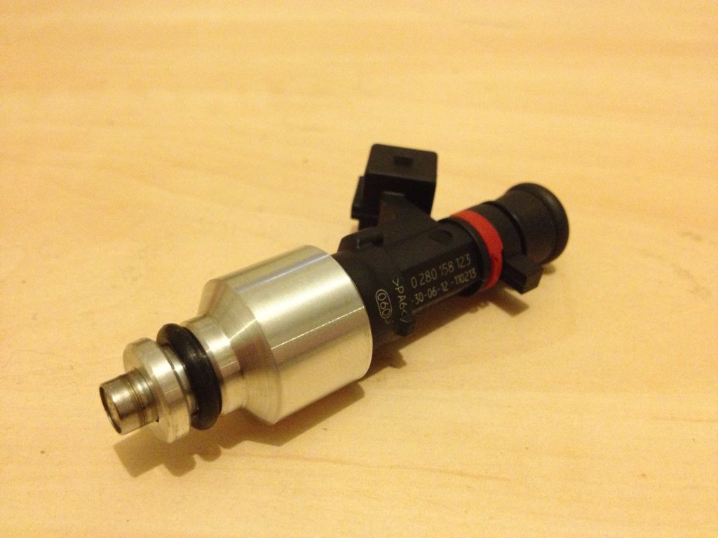

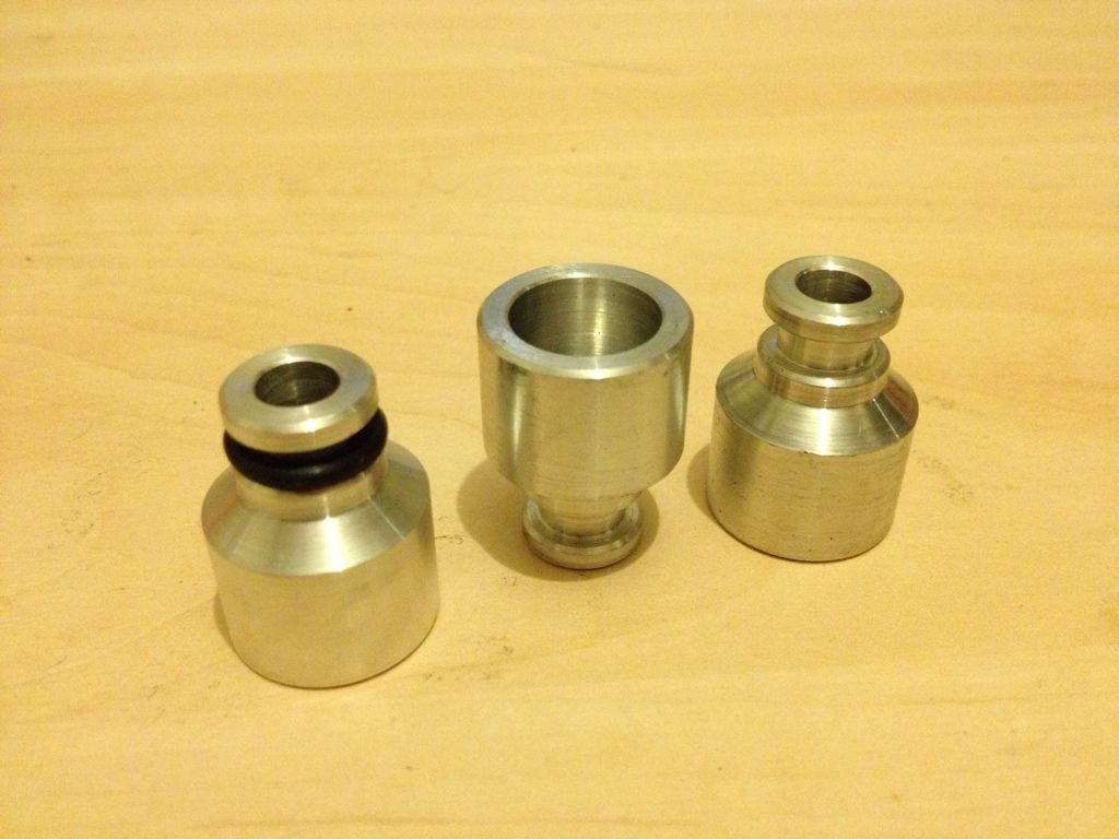

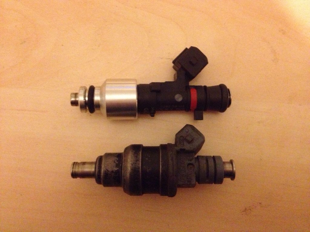

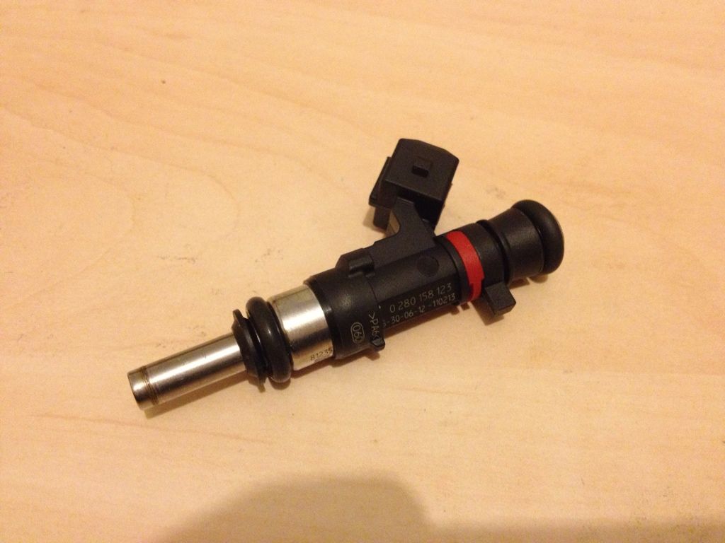

New year new start. Need to get this moving again.

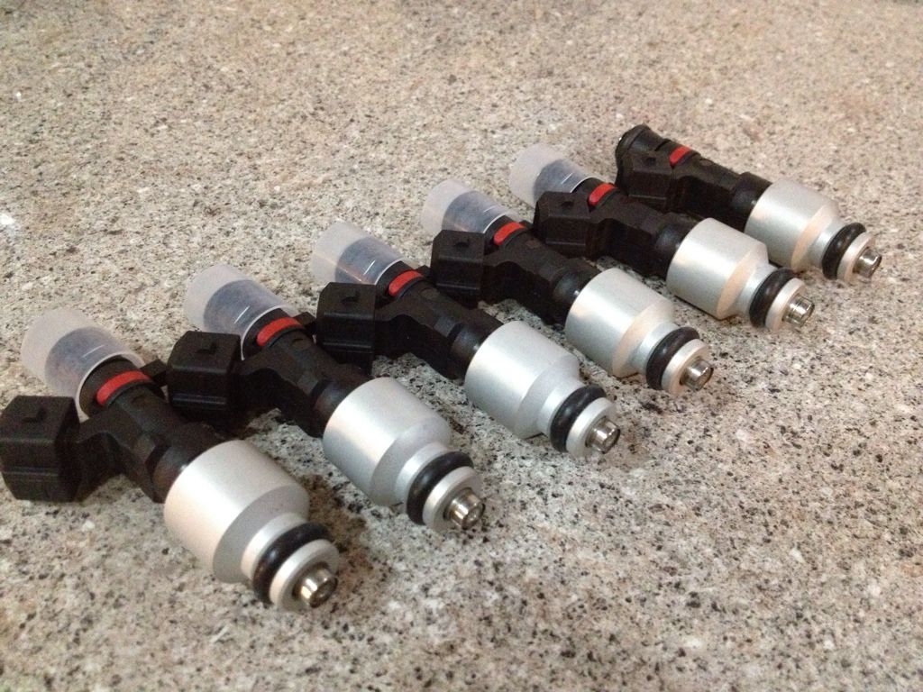

First thing this year is some new injectors. These are the correct injectors for the omex and are rated to 550cc iirc.
These are the newer Bosch style ones.
These are slightly shorted than the old Bosch with a long thing that's designed for the new card with the injectors mounted direct to head etc. So some spacers where needed.
Putting the O rings back in position.
Now need to sort fitted these along with mapping.

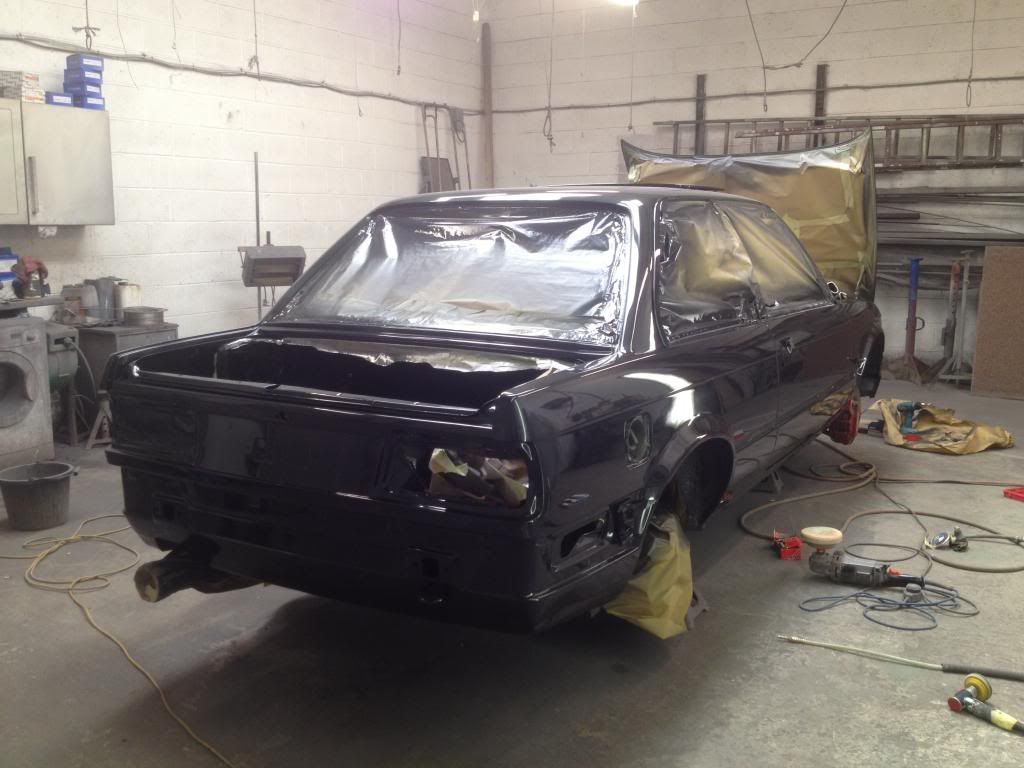

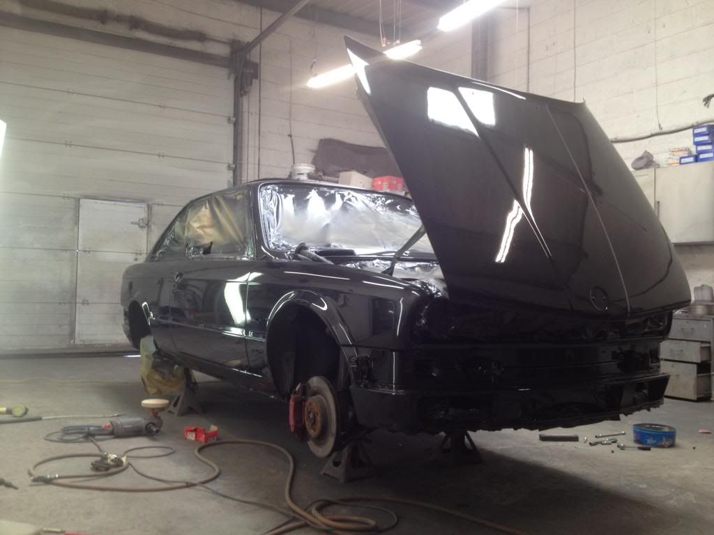

Clear anodised and ready to fit tomorrow.
- E30 Zone Meets/Events Team
- Posts: 27978
- Location: Mad mad mad
Updates Matt??
staley_turbo
- E30 Zone Camper
- Posts: 1391
- Joined: Tue Jan 19, 2010 11:00 pm
- Location: Leicester
tomislav
- E30 Zone Squatter
- Posts: 1633
- Joined: Thu Nov 29, 2007 11:00 pm
- Location: Faversham, Kent

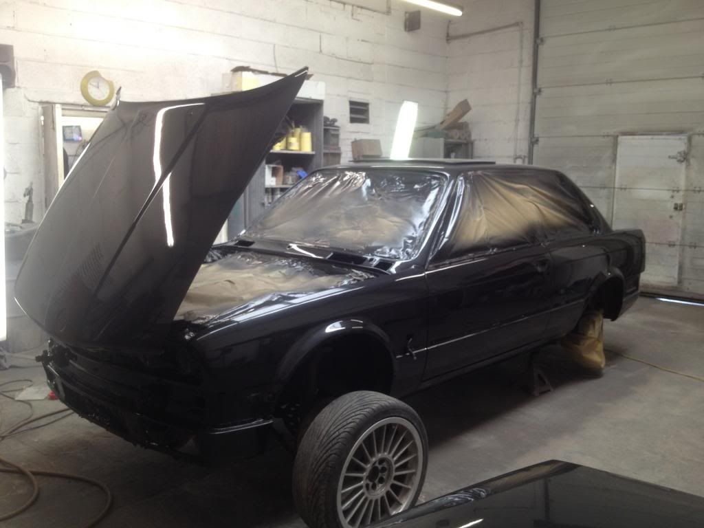

How much does that amount of bodywork cost to have done out of interest?
The problem i find is finding someone that will do the work to a high enough standard that i'd be happy with
- Posts: 27978
Looks good so far Matt.
staley_turbo
- E30 Zone Camper
- Posts: 1391
Cheers Rav,
It took months to find someone who i thought would it to the standard i wanted. And its not cheap

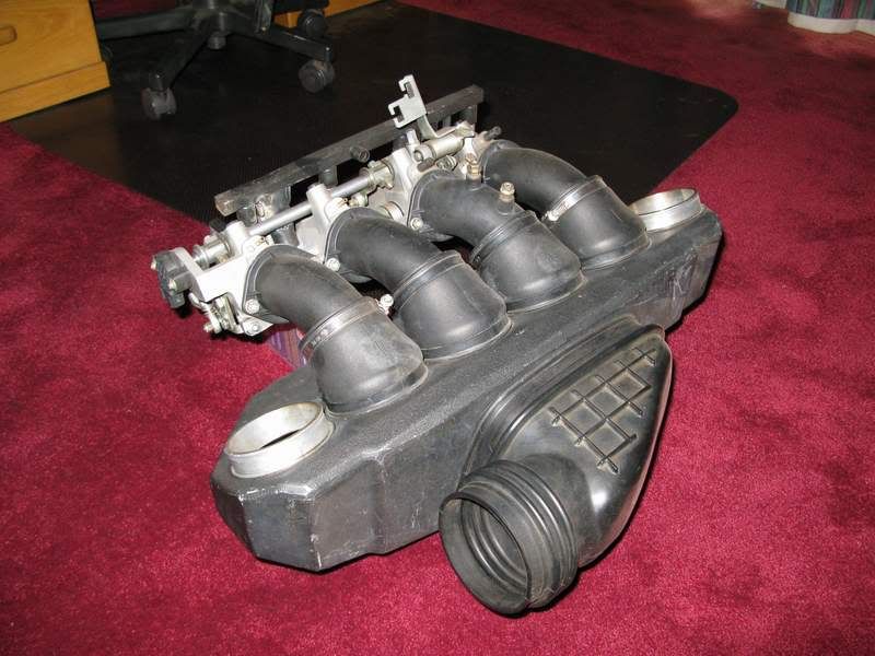

Amazing thread! I love how you had set backs numerous times and never gave up and just pushed on untill you had it right! Alot of respect to you mate
I have the same throttle bodies and these adaptor plates i bought from german ebay with the ravmans recomendation:
I just cant for the life of me find an airbox to mate up to this! is it only the airbox that you have (the m5 one? ) and if so where did you get this from and how much should i be expecting to pay for one? ( if you dont mind me asking) >>
Its either these or going down the custom airbox route which would be a last resort as id prefer an original BMW part in there
Any advice would be appreciated mate
or could i adapt something like the e36/ e46 one to mate up? -->staley_turbo wrote:Will do - it looks mega cool when its all on.
