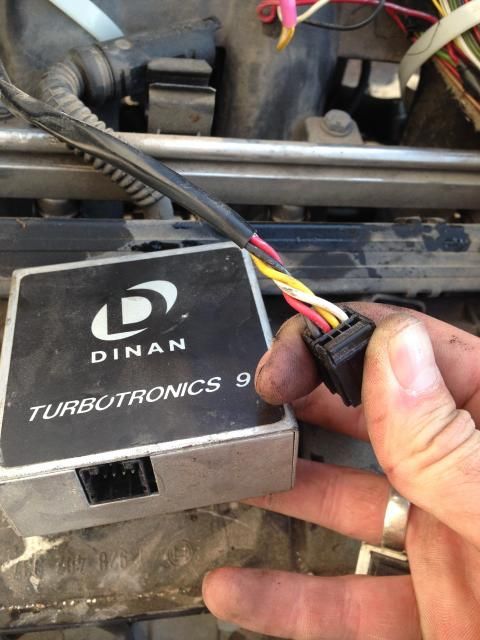

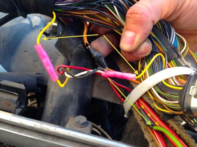

(On the Dinan unit)
Yellow- Goes to yellow towards the MAF (consistent with yellow at MAF)
Black- Goes to brown/orange (consistent with brown at MAF)
White- Goes to yellow towards ECU plug
Red- Goes to thick green wire in main loom
The problem Im having is that I have damaged a couple of MAF's so the engine is running without any air metering. Not exactly ideal with forced induction! When I plugged in a new meter the engine bogged down for a second (as it should) but eventually it stop working. A diagnostics scan reveals a fault code for the AFM.
My question is what does this turbotronics do and do I have to run it?
