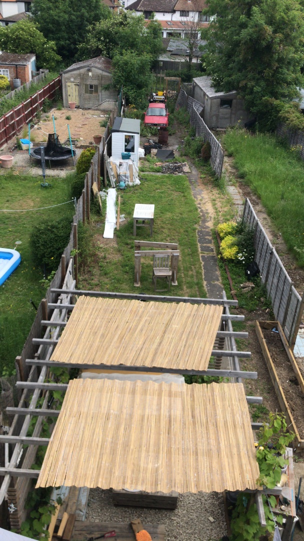

I’m planning to build a garage for nursing my e30’s.
Would like to be able to fit two cars lengthways which means I would need minimum 9meters long to accommodate.
My garden is thin and long 150ft approx and 14ft wide at narrowest point.
Without planning permission I can build upto 30sqm which would be 4.2 x 7.1m with a max height of 2.5m.
Ideally would like to have a two poster 😁 and go bigger at 45 sq meters 4m high with a dual pitched roof but this would mean going through planning application.
I live in Bromley, Kent borders of London anyone have any advice on doing something similar or where to start etc.

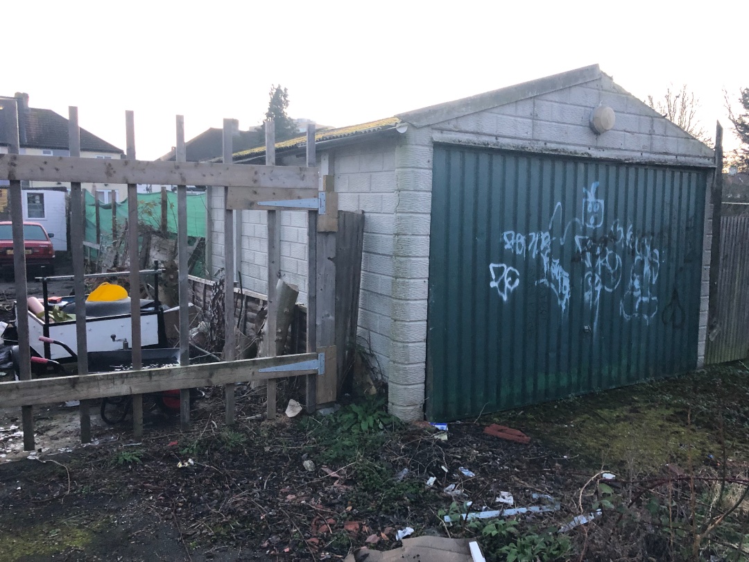

I added pics from the rear of the house and garden hope that helps.
Would be greatly appreciated πŸ‘πŸ».

I wouldnt be too worried about breaking the rules a little bit, government and councils continually prove this is ok!
A large door front and back is ideal, if you build to allowance and fit a canopy to extend you could then build up the sides of the canopy with a 'temporary structure' which would give you a lot more space once the door is open :D

No planning application means 2.5m high = no 2 poster πŸ€¦πŸ½β€β™‚οΈ
The temporary structure is a good idea to extend working areaπŸ‘πŸ».
Wondering if anyone else done this before
