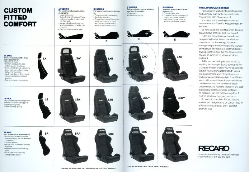

Marek does replicas of the original BMW covers for the seats and a lot of parts, so if you supply him a correct LX or LS of any make he will be the best person to make them look the same.
I am waiting to find originals but If I do not I will be getting the replica covers from him.
This might help you identify the seat

That's a massive help thanks, it looks like an LSC to me
Now to try to find one or more for sale...
