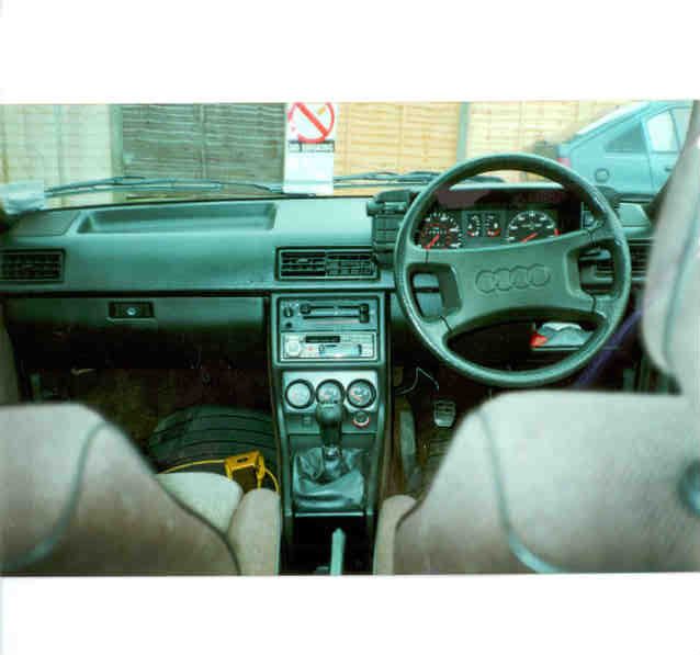

Sorry only just seen this
I had an '86 2.3GT ( non quattro ) a few years ago
rear brake calipers stick on
Mine had a noisy thrust bearing
Distributors wear out leading to intermittent starting and eventually breakdown
Clutch reservoir is a single plastic moulding and they commonly break/leak and are stupid money from Audi - you'll be pleased to know that an E30 reservoir and clamp can be fitted in its place
Galvanised so shouldnt have any rot issues even now.
IIRC I had to run mine on super unleaded too.
Mine wasnt very fast and it was a 2.3 - I can imagine the 2.0 needing a fair stab of the loud pedal to get decent performance
