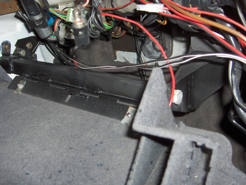

The final test fit. I'll take it back out again as I'd a) prefer the heater matrix pipes to exit the bulkhead somewhere else, and b) I need to sort a location and bracket for the ECU somewhere behind the master cylinder. winkeye
I cut down the back of the glove box and fabricated a hinge mount which doubles as an extra brace for the master cylinder/servo mount.
The glove box needs a back on it yet (otherwise my fags will keep falling on the floor :wink: ) but it shuts at least!

Clevis pin (in there somewhere!)
This was taken from seat level:
And from eye level. There's plenty of clearance for all but the biggest tootsies :)
8)
Let me know if there's anything else that would help. :D
