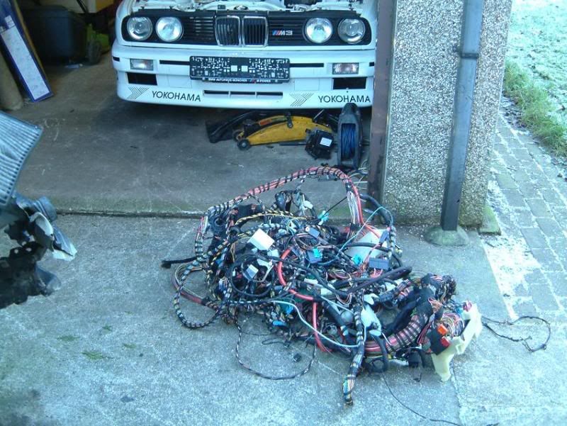

i thought i'd throw a few pics up of my latest project.
i missed the 'ol V8........ so i thought i'd do it again.

Bloody hell glenn. That wiring looks like a right challenge, is it an easy conversion electrically wise?

that wiring looks truly horrific, respect to anyone who can unpick that and still have a car that works! 8O

Cook318IS wrote:Bloody hell glenn. That wiring looks like a right challenge, is it an easy conversion electrically wise?
are you crazy paul? :lol: it's a nightmare !

there was me sweating over the wiring needed to fit a 16V 106 GTi engine in a 205 rallye track toy for my brother... that looks truly horiffic!
i take it that's the whole car/engine loom sat on the floor?

yes, the wiring can be a ball-ache, but that's mainly from keeping track of what i've cut.
i dont want to use an aftermarket ecu,
a- i already have an ecu
b- because i believe the factory one is best
c-it's additional expense
one of the big problems with this though is, if the ecu doesn't receive all the information it needs, it will go to 'limp' mode, which limits the rpm to 5500rpm.
two ways around this is,
a- to give the ecu all the information it needs, which is the way i want to do it this time.
this mainly involves keeping the 'dsc' (dynamic stability control) system active.
this is taking information from the dsc/abs module, steering angle sensor and abs sensors.
if the ecu detects the car is out of control (one wheel spinning more than another, outside of its preset parameters), it limits rpm. the e39 takes it's speed information from the rear n/s abs sensor, so to keep the speedo/cluster working (which is what i want), i need to use that sensor, and it just so happens that the e30 m3 and e39, both have 48 tooth abs rings!
b- if i get it wrong, or cut the wrong wires by mistake, i have something to fall back on...
the ecu has a 'dyno' setting, which allows the car to go on a dyno. this setting ignores the different wheel speeds and allows the full 7000rpm. so i could, if i need to, get the ecu re-flashed to stay at this map.
