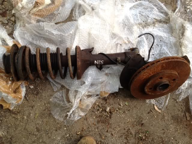

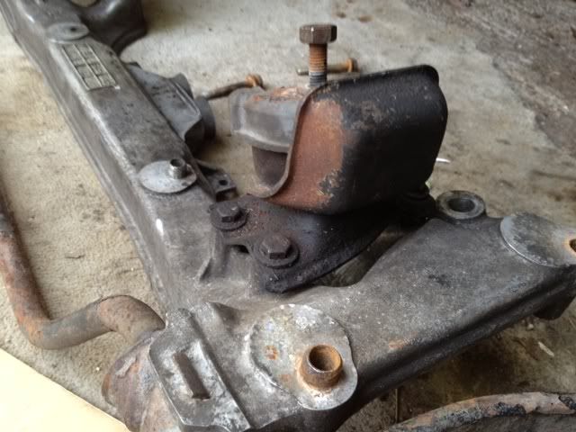

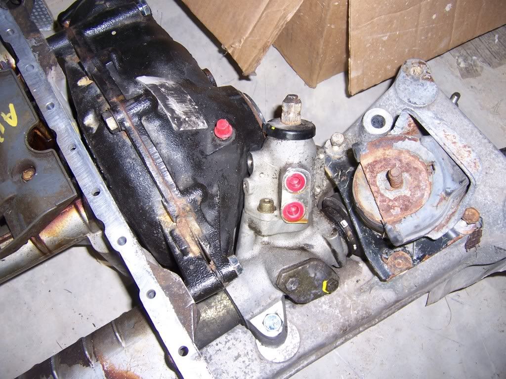

Thanks to DaveTheGoat for coming and finishing off my welding today! Looking forward to returning the favour when it comes time to wiring up your car ;)

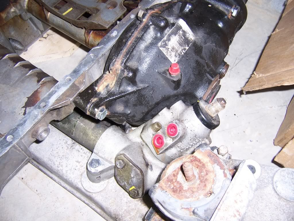

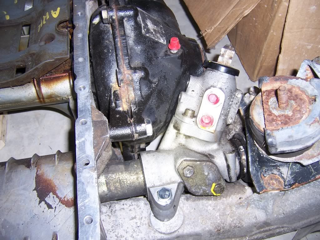

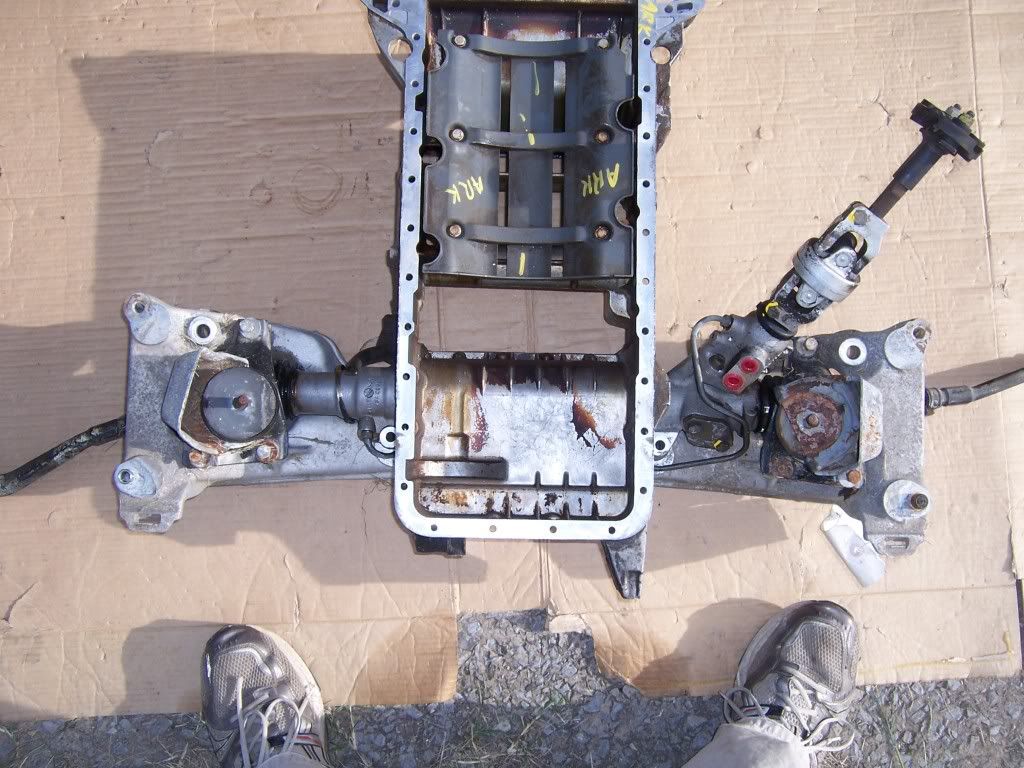

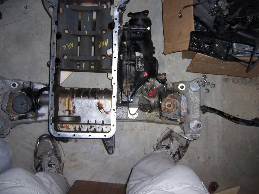

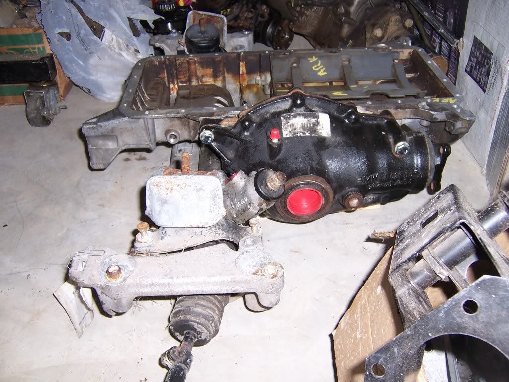

Some pix of the x5 diff Courtesy of Will: (cheers mate!)
Mocked up the gearbox, bellhousing, clutch etc.
Need some help:
Does anyone have a number off an e30 m3 S14 engines gearbox spline bearing? (Behind the flywheel) Pix or part numbers much appreciated.
The bearing on the s62 is different to the s14 box so will need a custom one made.

The pics are of TheDarkSideOfWill's build mate. I asked to use the for reference for people to see and offer advice.
But it is getting there slowly slowly

turk wrote:The pics are of TheDarkSideOfWill's build mate. I asked to use the for reference for people to see and offer advice.

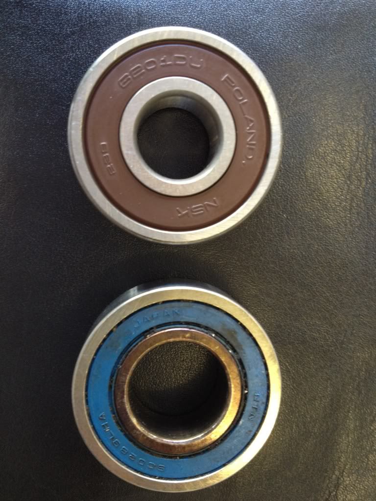

does anyone by any chance have the Bearing number itself imprinted on the side wall? I need a combination of the e39 and e30 one made.
The E39 one is SC 0289 LHA Im told with this and the e30 number a custom one can be made.

Custom bearing - no way (if you don't want it to cost 100000000000 €)...
Think it throught - S14 (as almost all other older BMW's) has 12 x 32 x 10 bearing (inner hole x diameter x width), whereas S62 has 15 x 32 x 10 bearing. So the only difference is in the "clutch shaft diameter", which is 15mm with the newer cars and 12mm on the older ones..
Online-ETK, such as www.bmwfans.info is really useful, better to learn to use it ;)
So, what you need to do is to buy normal S14 bearing and smash it on place - "problem" solved.

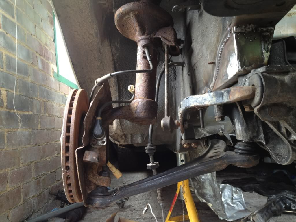

FINALLY these arrived. I need some decent adjustable top mounts, and once test fitted will have them blasted and painted.

If I do that the bearing will be snug on the spline shaft but flap around in the engine end surely?Jonsku wrote:Custom bearing - no way (if you don't want it to cost 100000000000 €)...

Sounds like it'll work to me!Jonsku wrote: S14 - 12 x 32 x 10 bearing (inner hole x diameter x width),
S62 - 15 x 32 x 10 bearing. So the only difference is in the "clutch shaft diameter", which is 15mm with the newer cars and 12mm on the older ones..

I got one now.
£12 suitable for 22000 rpm.

You're welcometurk wrote: Some pix of the x5 diff Courtesy of Will: (cheers mate!)
As you can see, it's going to be pretty snug on that side of the engine...
