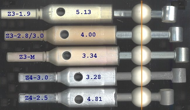

Whats the comparison to the famous Z3 1.9 shifter Andy?

Depends whether it is a 2.5 or 3.0 Z4 The 3.0 will have a much shorter throw
