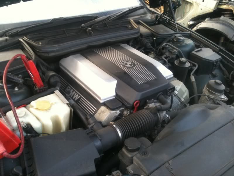

Right, I've trawled the forums until my eyes bled, and knocked up this:
M6x Engine Swap
If you have a quick read you'll notice to immediate gaps: Exhaust Pipes and Loom. I couldn't find any specific info on these, so if anyone can point me in the direction then it'd be appreciated.
As for the rest, if you've got 5 mins then please take the time to read it and point out any errors. As far as I'm aware, this will be the only RHD-specific installation guide on the 'net so it's important that any mistakes are picked up and corrected.
My thanks to everyone who posted in the forum, as that's where all the info comes from.
excellent write-up, as usual.
the s62 uses the siemens dme, not bosch motronic :thumb:
also, the engine pic is a m5x :lol:
Grrrmachine
E30 Zone Wiki / Team Member
Posts: 8043
Location: Warsaw, Poland
Thu Apr 11, 2013 6:10 am
Cheers for your comments guys.
Ben: Talking about searching and using google doesn't help much. I'm not doing this swap myself, I'm just trying to compile the Zone resources into one handy page. So any links you can provide would be useful.
Glenn: What M50? :o: My current plan is to put the S62 swap on a separate page because it seems there are enough differences to warrant it. But cheers for the ECU info.
