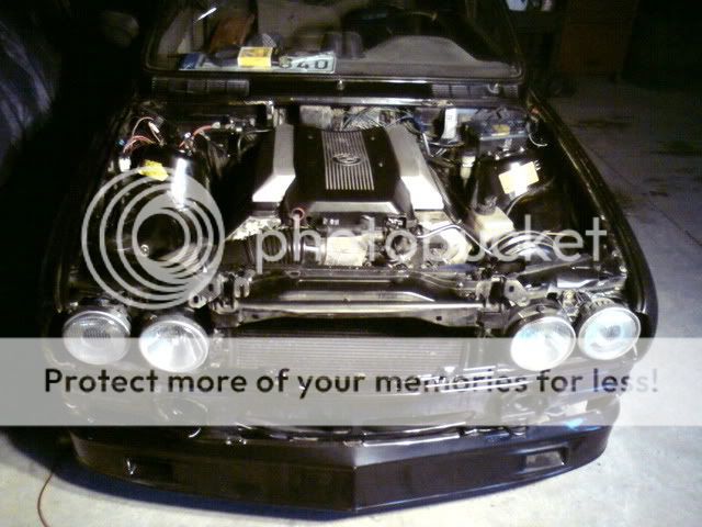

There are couple of examples @ e30.de
Remote filter assembly would be nice, as the original filter housing does indeed sit on the "wrong" place.

i've moved mine to the place where washer fluid tank used to be

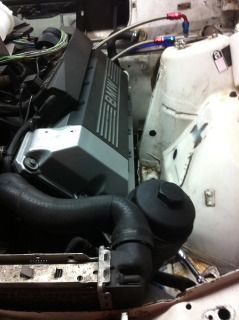

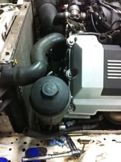

well acouple pics of how far iv angled the oil filter housing over.

I moved mine right over to the wing, the lines can be sorted by a hosing company as they can use the original fittings, sits nicely and gives you better access to the top rad and looks 100 times better
