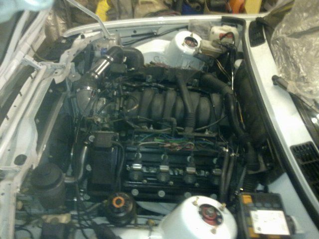

Hi Will and Ben, thanks very much for all the great info!
Sorry for the delay in replying, I've only just regained access to the site.
I think I'll initially use standard rear E30 discs and calipers, just to get the car on the road, then perhaps try Will's suggestion of using the E36 discs re-drilled, with E32 calipers. I may have been getting carried away with my desire for a non drum handbrake set up. I mean, it'as not like I'm going to be doing handbrake turns every 100 metres....... I'll be spending most of my time leaving number 11s.
Work has commenced again on mine, so more updates to follow.
Got a date for your exhaust booking Ben?

E36 1.8Ti COMPACT Rear Axle, will give you 5 bolt conversion and 276mm rear discs, for the E30...

Thanks Das_BMW_E30 and Will. I had my opportunity to convert to 5 stud all round at the beginning of the project, but didn't.
Perhaps 5 studs will grace my car in the future....
This is what a big project is all about - good decisions and bad decisions.

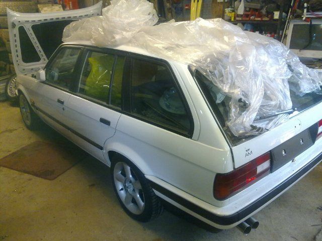

Just a quick update; I won't be going to Gaydon this year.
Two reasons, first one being that the car is very very unlikely to be MOT'd by then and I wanted to drive it there this year and the second one being it's very near to my birthday and my wife has 'arranged' for me to be away that weekend, which over rules the 1st reason anyway....
On the bright side, there's a 99% chance of the engine being started fairly soon.
I'll do another update when this has happend.
How's yours getting on Ben? A good mate of mine with another E30 touring has had problems with his handbrake, because the back plates are disintegrating, so he's bought some BMW Mini rear calipers and will be using these to give him a mechanical handbrake. I can get more info off him if it sounds good to you?

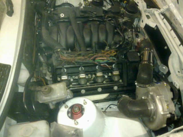

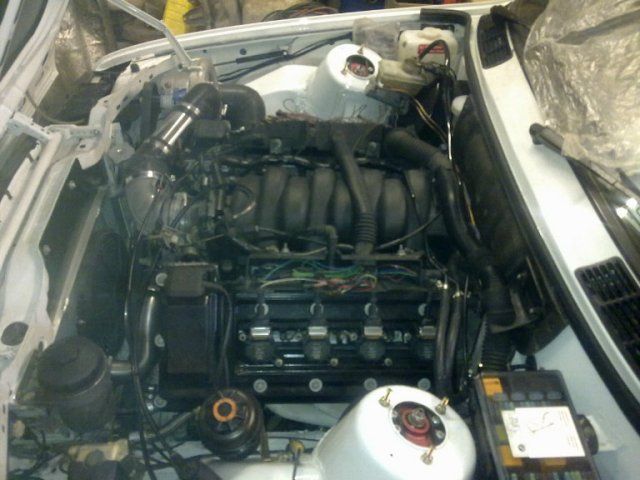

Hi Ben, It's still a work in progress, but so nearly there. The exhaust is done, the water methanol is fully plumbed in, the cruise control is in, there's water and oil in the right places but she just won't fire up. It's got to be down to the timing, because we have spark and fuel, but 925rpm is all we're getting on the starter! It may have to go straight to Emerald and then be MOT'd after.
The guy working on it now is the man I should have had on it from the beginning, had I known about him.... He's basically had to do about 80% of the project, which he's done at absolute bargain basement cost.
I've gotten rid of the steels and have got 15" BBS with my trackday Hankooks on. Also, it sits too low to be driven practically on the road with its H&R coilovers on max height, so they'll be going up for sale sometime......
I bet you're enjoying yours though? Plenty of trackdays etc? Are you staying in the UK for the forseeable?

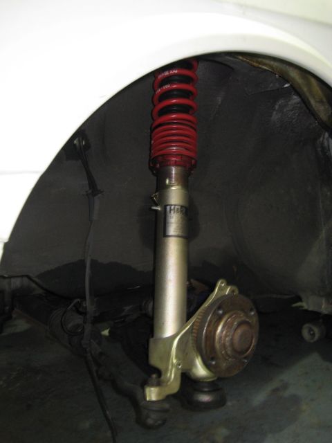

There's a second-hand h&r kit on a well known auction site - 5 days 21 hrs left......

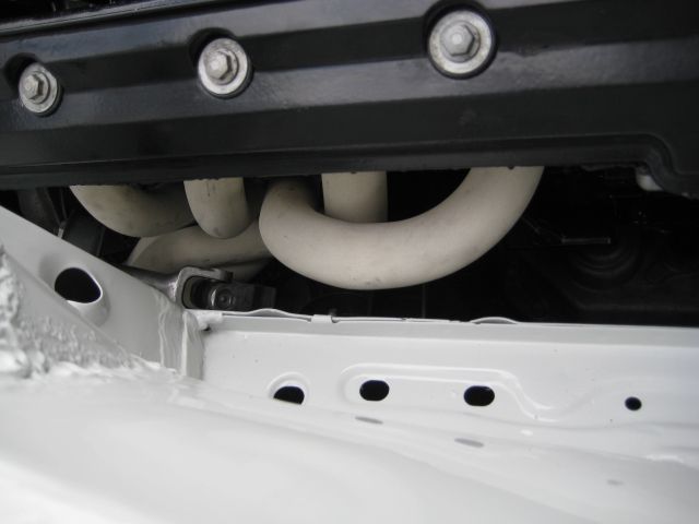

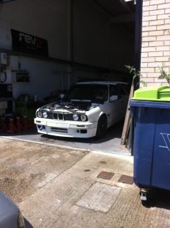

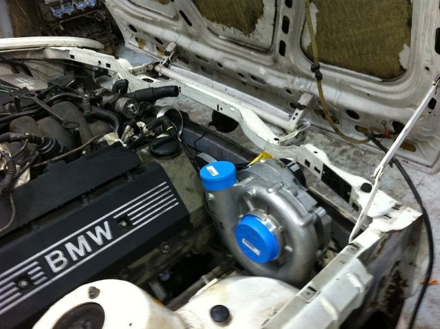

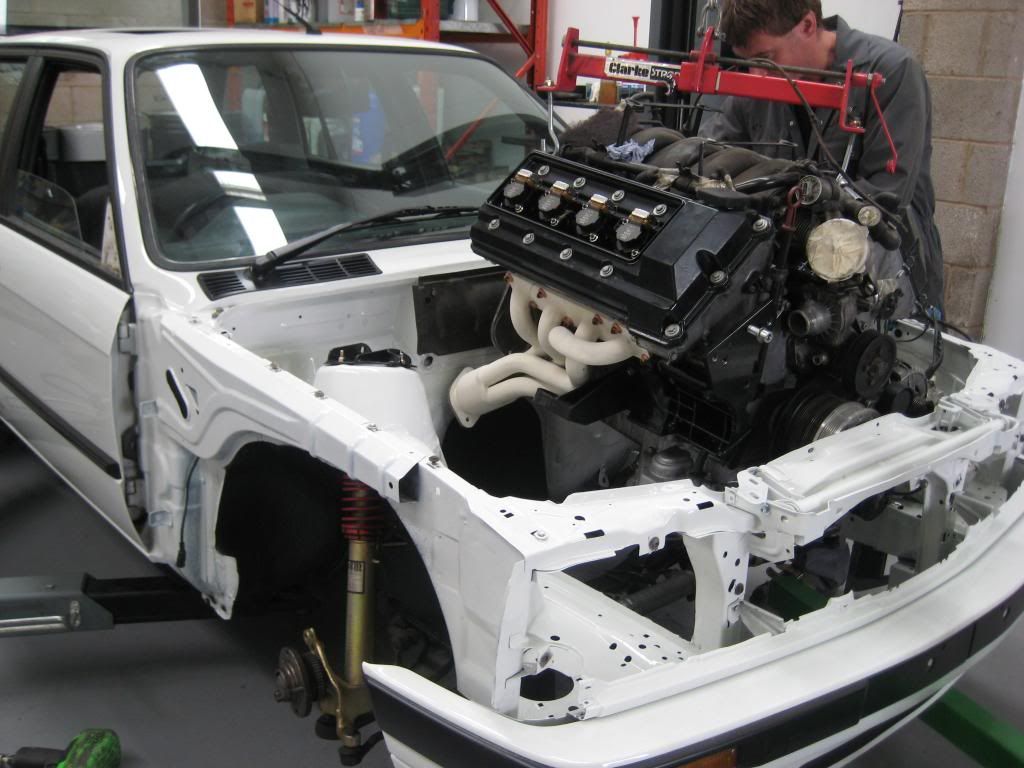

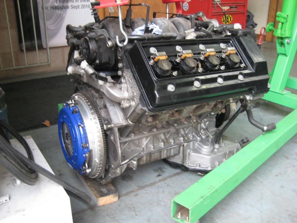

But, on the plus side, I have some photos for you, and anyone else who's interested, to enjoy:
Where the TCS throttle butterfly would have been is where my water methanol is plumbed in. Between the oil filter housing and the pas reservoir is my cruise control motor. Sorry about the mobile picture quality!
Don't worry about the 16" 5 spokes, they're my 'getting it to and from MOT' wheels!
As it was, at Gaydon 2011;
Quite a nice shot of the mk1 manifold (now re-done to clear the E36 rack);
The infamous clutch and flywheel combo, which I won't be seeing for a long time, hopefully;

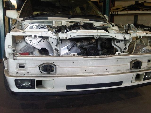

This shows the height issues faced with this installation;

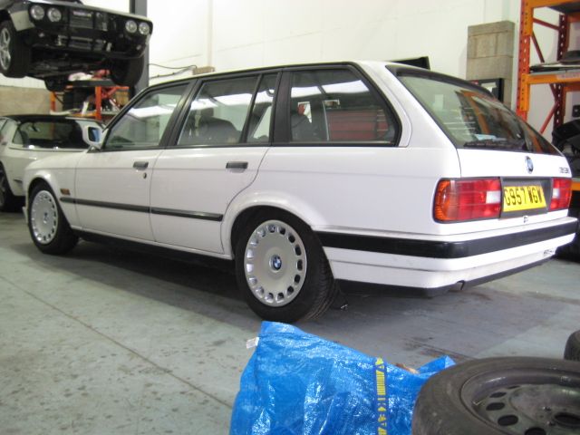

Apart from the mini wheels and E34 trims, this is just as I bought her, in Aug 2010;

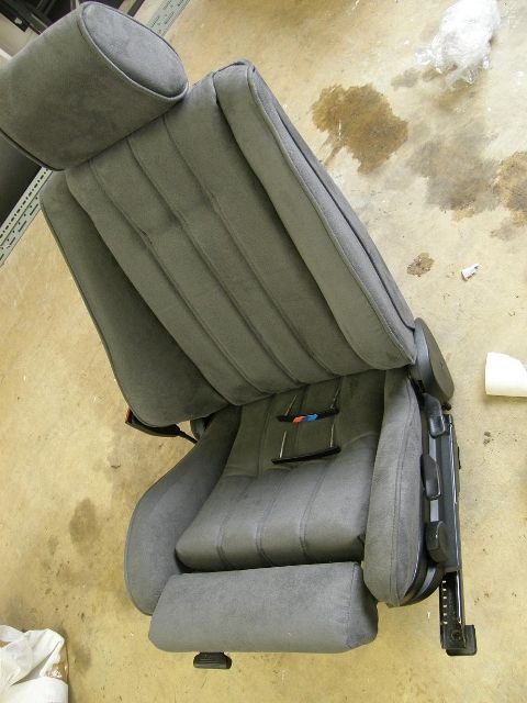

Re-trimmed E28 M535i 'recaro' style seat, in alcantara;

Cheers Will!

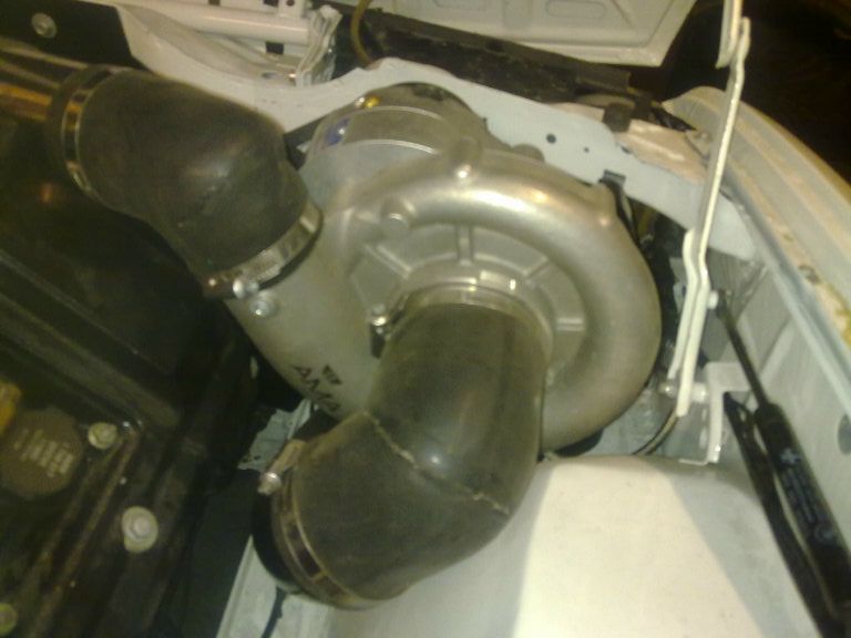

Do you happen to have any pictures on the S/C bracket? Did you fabricate your own or use some readymade bracket?

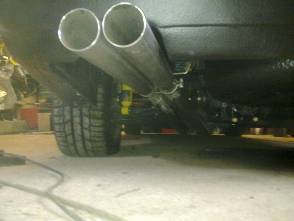

I will tell you know that your exhaust is going to be metal loud, I have just a back box on mine it's its super loud haha. Can't wait to see it.

Hi there, the s/c bracket is exactly what came with the ESS kit, designed for the E39 the M62B44 came out of. It's quite a nice bit of metal, but then it should be, given the price of the kit!Jonsku wrote:Do you happen to have any pictures on the S/C bracket? Did you fabricate your own or use some readymade bracket?
I don't have any photos of just my bracket and I can't find any on the internet either. Sorry.

I wonder if the supercharger will make it a little quieter? We have 'designed' the exhaust system to be fairly easy to change, if it is too loud, boomy etc.
