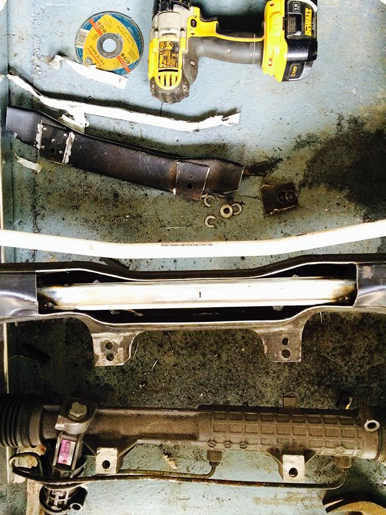

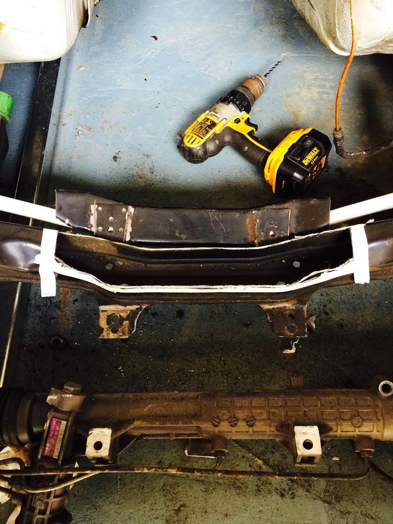

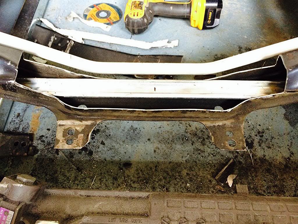

well here we go i went head and started it,
i have cut the top part off the subframe and intend to strengthen the inside
I'm also going to sort the steering rack brackets out as well to do away with the spacers needed to fit a E46 rack.
