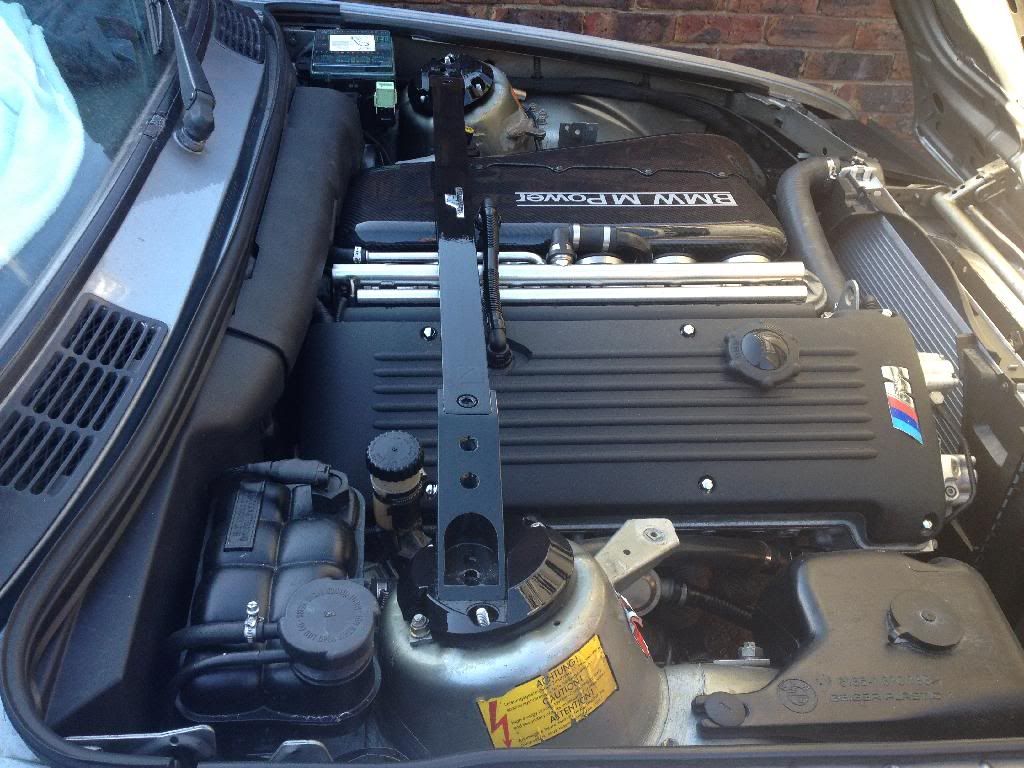

I've just completed my s50b32 conversion and would like to know what trim cover is used to hideaway the wiring against the bulkhead. I've seen a few pics on google images and it seems a non-e30 trim is used, any ideas?

all are e30 M3 or 318i

if you got a 6 pot shell some mods for the bulk head part will have to maked bit of drilling and trimming to make it fit to bulk head nothing major you will know what i mean once you start it

The M40 wiring bulkhead cover and the M3 as pictured below, make sure you get both halves of the M40 cover ( back plate bolts to the bulkhead and the cover clips over).
