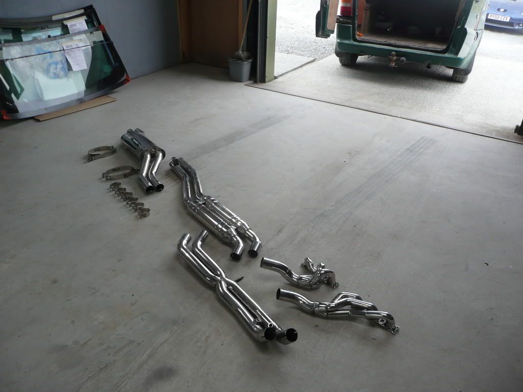

my exhaust turned up today from predator. looks really good.cant wait to get it on to car and see how it fits and sounds.i know the manifold pipes are not all same length but not really bothered if lose a few horses :) got a 100horse nitrous kit i can put on if i wanted haha:)

shiny:D

I like it alot.

Am I right in saying thats the Dave/predator system? If so Dave keeps trying to sell me one of these everytime I go and see him 8)
Ive had a good look round these and the quality looks great. Ive only heard one on an M50, but it really did sound good. It wasnt overly loud on idle or part throttle (Dave wanted to keep it subtle) but it had a nice bark once the taps were opened :twisted:

jmc330i wrote:Am I right in saying thats the Dave/predator system? If so Dave keeps trying to sell me one of these everytime I go and see him 8)
completely agree with everything you say there james (including trying the trying to sell me one bit :chuckle:) it does sound gorgeous

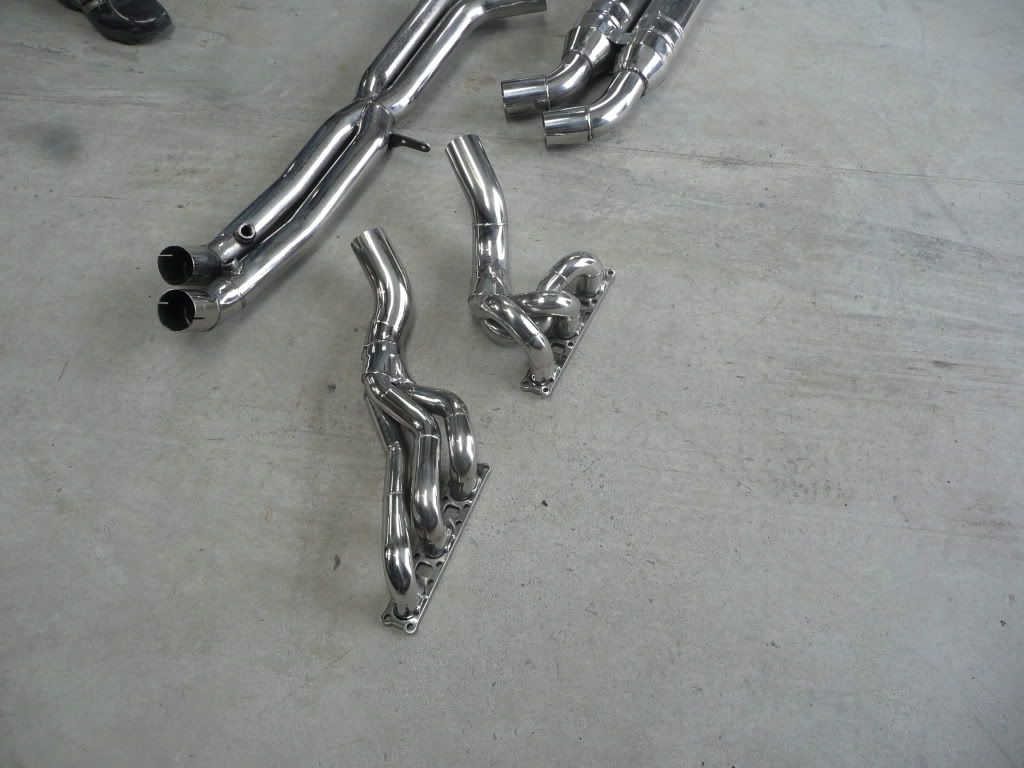

got the system fitted on today fits on good but very close to steering uj's but got it all sorted now. it sounds great not to noisy. not had it for a drive yet tho. need mot etc

Glad to here its not to noisy so atleast you wont be turned away at track days for going over the 108db ristiction most tracks have.
Have you got any pics of the manifold position in relation to the uj? I am thinking of buying one of these systems wanna make sure under hard cornering the manifold isnt going to fowl the uj.
Fri Jun 11, 2010 8:15 pm
Nice tubes 8)
If you dont want contact with the steering joint on hard left handers (using rubber engine mounts) you need to have around 20mm clearance between the tubes and linkage
There is 10mm minimum here and hits the linkage on hard lefts, this is an ally engine BTW so much lighter than an S50

I notice you have done away with the rubber bush/coupling how has this afected your steering?
I was going to do the same but was advised against this and told the steering would be notchy.
I dint use the combo of e36 and e30 on my car to fit the z3 rack, I shortend, sleved and tig welded the original colum.
Losing the coupling would give me much needed clearance to get the manifold in the right place, witch is driving me mad as my field is bodywork not mechanics!
Fri Jun 11, 2010 10:47 pm
Hasnt affected the steering at all, feels fine on both of my E30's with solid linkages

is there any kind of polly engine mounts available?? think i have about 10mm.i have also use the same splined shaft as in the pic above to do away with the rubber coupling.

bottom of the page you will find the s50 polymounts that a number of people completing this conversion swear by,
Should greatly reduce/eradicate coupling/shaft to manifold contact in hard cornering
HTH :D
Sat Jun 12, 2010 10:37 am
Yeah the $200 mounts, the only other option IMO is to mod the crossmember to take straight mounts and use some poly, the AKG ones are angled so the engine arms sit on straight

Dan is that a s50 or a m50/52 in your car? The manifold in the pic looks like a m50/52 these manifols fit the s50 quite neatly but look very restrictive so i have decided not to use em on my car.
Sat Jun 12, 2010 12:35 pm
Its an M52, you dont want to be bolting those mani's to an S50 :)
Sat Jun 12, 2010 11:30 pm
e92mirro wrote:Dan is that a s50 or a m50/52 in your car? The manifold in the pic looks like a m50/52 these manifols fit the s50 quite neatly but look very restrictive so i have decided not to use em on my car.
8O
These are massively smaller than the S50 manifold's bore!

Thats why i decided not to use them winkeye
