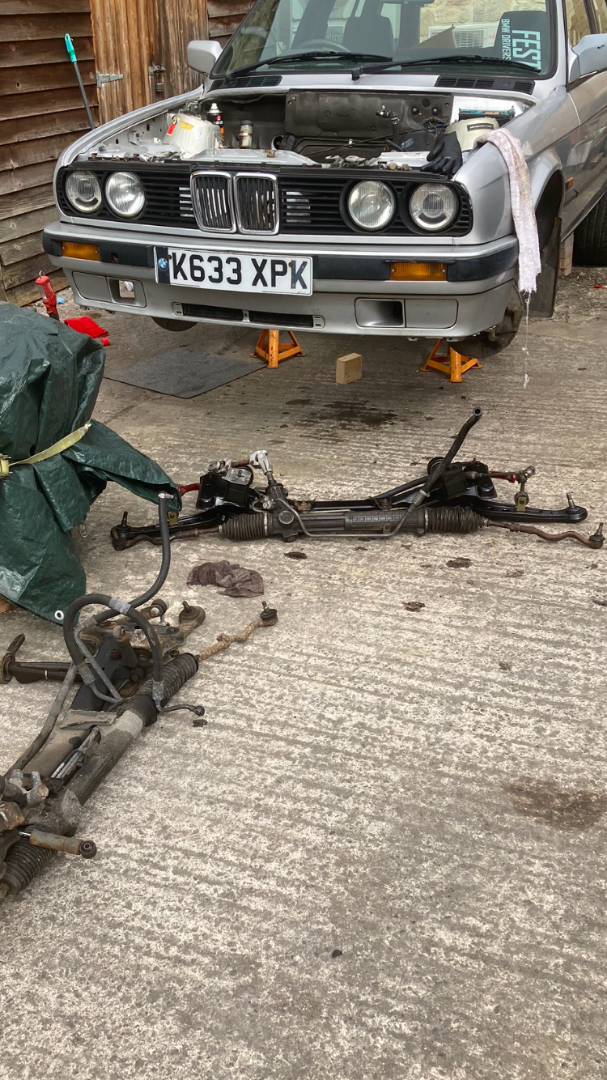

So thankfully some nice weather at last and some progress
My good mate Nick kindly offered to help me out with getting this thing back on the road, hes owned plenty of e30's in the past, so a perfect helping hand
We got her back up on axle stands to give her a proper once over.
I had fitted a set of WMS brakes maybe around 5 years ago, that I'd got second hand off here. My efforts had been a bit half arsed.... The disk was rubbing the back plate, and the back plate was rubbing the track rod end. I hadn't fitted the proper 2 or 3 mm spacers behind the wheels. A bit of a pigs ear, shall we say. So some angle grinder action on the back plates and the correct spacers located in the many boxes of "spares" and it was looking a bit better. Wire brushed the disks and a quick once over with some emery paper and they were looking good as new
During this messing about with the front brakes we discovered a significant amount of play in the front right suspension/bearing. Didn't take long to find the culprit, a totally knackered control arm bearing on the bottom of the strut. Thinking back, these are the same ones I think used while racing in the PBMWC and they weren't even new then!
So a few new parts to order there.
Moving on. The exhaust was almost sitting on the floor as all the rubbers had perished and split. So we got it back onto its hangers with some jubilee clips. I think I should have done it this way the first time round, we got it fitting much better within a few minutes, but an extra pair of hands with this sort of thing makes all the difference. I can remember laying under the car with the exhaust laying on me, swearing at it for many hours. Didn't work!!
Few more bits to order.
Obviously 9 years has taken its toll. There are many rust areas to deal with etc etc but I'm still hoping it won't take too long to have her back on the road.
Replace the front control arms and book it in for an MOT and see what they say I need to do, is the plan, I guess.

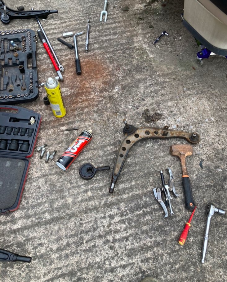

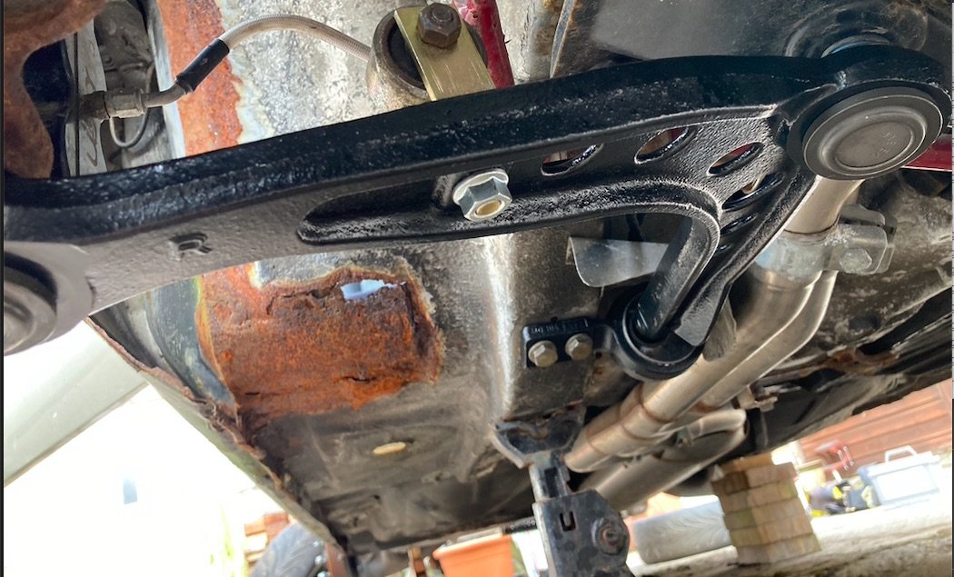

Not the most interesting of updates. The new control arms arrived yesterday, and it wasn't wet today, so a few hours in the cold and got the old arms off and mainly swapped over.
(here is a rusty control arm, I forgot to take pictures of the new ones, but they aren't really interesting? Are they?)
I snapped one of the bolts on the control arm for the anti roll bar bracket. So a new set of brackets is on order.
Managed to remove the old lollipops with the m3 bushings intact fairly easily, but I have also ordered a new set of them too as they're over 10 years old now.
Thanks to Danthe ;) I'm also replacing the wheel bearings, track rod ends and pretty much every bush now. That should take care of next weekend if the parts all arrive in time.
Few other jobs I've spotted. The rear copper brake lines need replacing and probably the solid fuel lines too. One step forward, two steps back.

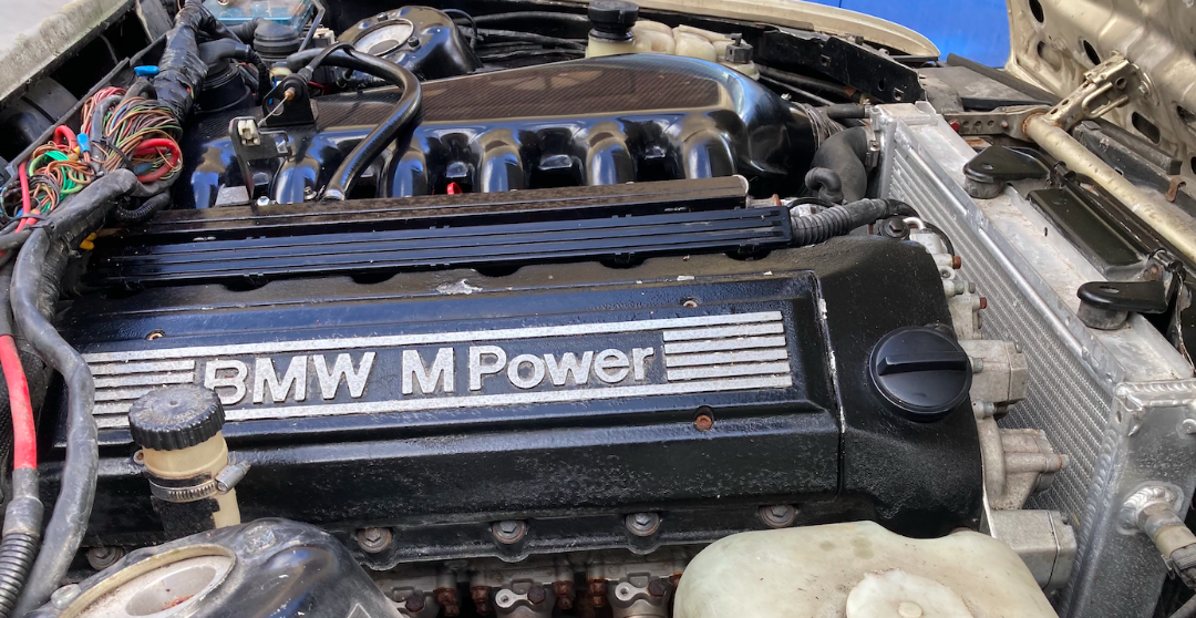

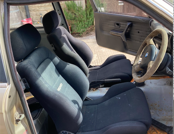

So not a bad weekend for getting some hours in on the motor.
Put in some fresh anti freeze, ran her up to temp and changed the oil and filter. No dramas.
The interior fan wasn't working
, and my memory was that in the past it had only worked on speed 4. I don't think it would be possible to get the fan out with the engine in place, taking the engine out in not an option at this point, so, some patience with a long screw driver moving the fan back and forth with the help of a can of wd40 and she is back up running again, and now on all 4 speeds
Decided to check the clutch and put it into gear while on the stands. Gave it a tiny amount of throttle and there was significant knocking in the transmission tunnel. The centre bearing rubber was completely gone. It was brand new 10 years ago and has never been driven. WTF!!! So now the exhaust and prop has to come off
Some new bits arrived and got bolted on.
(mmm rust)
Gave the engine a clean. With an oily rag. Got the passenger seat bolted in too. Mounted on standard e30 rails, using adapters from massivebrakes.com Steering wheel needs some attention. Anyone know what's good to make it black again?
Fuel guage reads half full when its empty so I must have the guage designed for the m3 with the long range tank in the boot, so that needs swapping to the standard item. Might get one of the euro ones that tells you the amount in litres.
Anyone know what I need to do to make the oil temp gauge in my cluster work?

That looks like a standard fuel gauge for an M3 not the version for the extended range so the fault will more than likely be with the sender/senders depending on what tank you have fitted
Oil temp gauge is easy, the terminals on the back of the clocks tell you what signal they need and the S50 will have a temp sender fitted in the oil filter housing

The confusion continues with this fuel guage..... That is what I thought Dan. But it will show the red light on and half a tank. Car is a 318i and has a standard 55l single sender tank, which the M3 should also have.
Well you make that sound very easy. Do I need to swap the temp sender in the filter housing?
- Posts: 28649
- Location: Staffs
Easy to test the sender by removing it refitting the plug and tipping it up while watching the gauge, you can also short the sender wire to earth which should give a full reading on a working gauge
The S50 oil temp sender will run the gauge fine

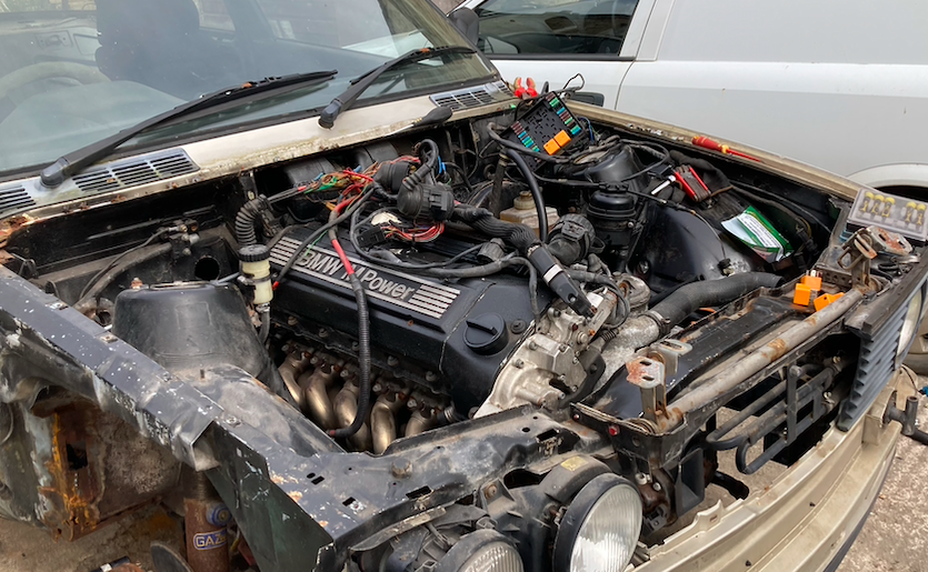

Sooooooo..........this arrived on Thursday. Bought unseen on Sunday night after seeing an ebay advert with 5 poor photos, for the princely sum of ........ONE thousand pounds...
(advertised as having oil pressure issues)
Anyone recognise it?
Anyway. The last few weeks have made me do some very hard thinking about this project.
10 years ago I wanted the best track car I could build for my budget. 10 years on, I haven't driven on a track once in that time, and now I just want a car I can use and enjoy on a daily basis, with maybe a track day thrown in, once in a blue moon.
Was a lovely day today, and got the engine out by 2, just before it stopped being a lovely day.

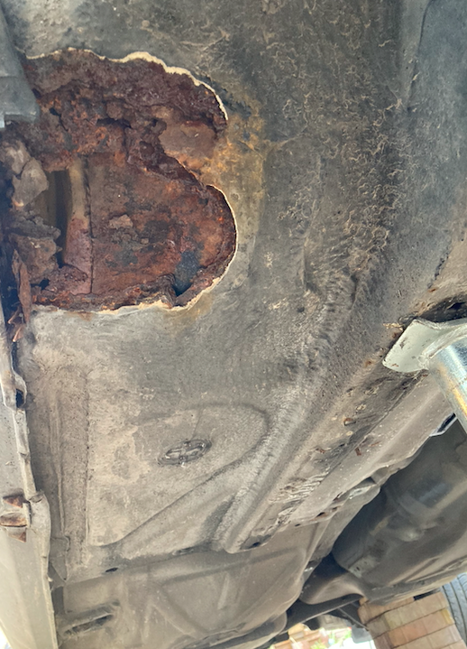

Few more hours on it today, removed the exhaust, heat shielding, prop shaft. gearbox and selector linkage etc. Gave the engine bay a once over with some degreaser a brush and hose.
I presume the yellow stuff around the strut towers is waxoil. I'd like to clean it off. Petrol and a rag?
Found some more of the dreaded brown stuff, but so far, these are the only two bad areas I've found and both are repairs I feel confident doing myself, so those are jobs for tomorrow.

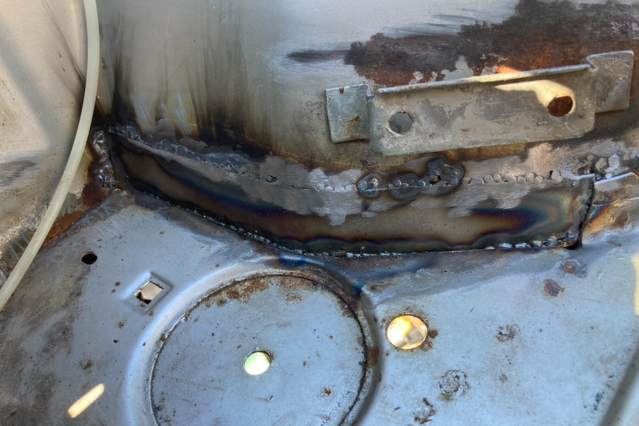

I got this bit cut out and replaced today. I'm self taught, be kind

Spent the day removing everything from the 2 door, in preparation to remove the engine. So, airbox, exhaust, prop, gear linkage, wiring, radiator, power steering, oil cooler, electric fan wiring, fuel lines, etc etc
I got the oil cooler fitted onto the touring after fighting with a slightly bent front valance, which got unbent with a length of 4x2. Then routed the wiring for the electric fan. Which is now going to be swapped over to the SPAL fan I've had sitting here for years. Still needs connecting into the fuse box. I managed to remove most of the connections from the old fuse box after some good advice from Dan, but after faffing with a couple of them for 5 minutes or so I just chopped them off and will remake the connections. Dan can I buy two of the special push spade connectors please
Lots of other general meddling and at the end of the day got my mate round for a helping hand, and it was removed.

Thursday was spent removing the front subframes from both cars.
While I had it back off the car, I decided to give it a bit of tlc. The Eibach anti roll bar was rusting all over the place (wasn't new when I bought it) and the powder coating on the subframe was also bubbling and rusting in places so it was rubbed back, rust treated, primed and painted. All very roughly. It is under the car afterall. It'll have a bit of clear waxoil too when I buy some.
Friday I mustered the enthusiasm to tackle the rust in the front footwell. It was worse than I'd thought. But it got chopped out and patched back in. It is by no means perfect. I wish I had the time and skills to do this better, but it is solid now and who in the hell is going to see it anyway.

Another long day of it today.
Removed the front struts from the touring. Took the disk and calipers off the struts and refitted them to the 2 door to keep it in a rolling state.The front subframe off the touring had already been refitted to the 2 door.
Refitted the front subframe to the touring and while it was all easy to get at, I upgraded the front section of the steering UJ. I bought this thing from the states and it took forever to arrive, so it didn't get fitted all those years ago. But I'm glad to be able to use it now as it gives quite a bit more clearance from the exhaust manifold. Then it was the dreaded job of swapping the diffs over...... If this diff ever has to come off again I"m changing it over to studs..... Then for a final hurrah we dropped the engine back in. And had a celebratory can of cider.
