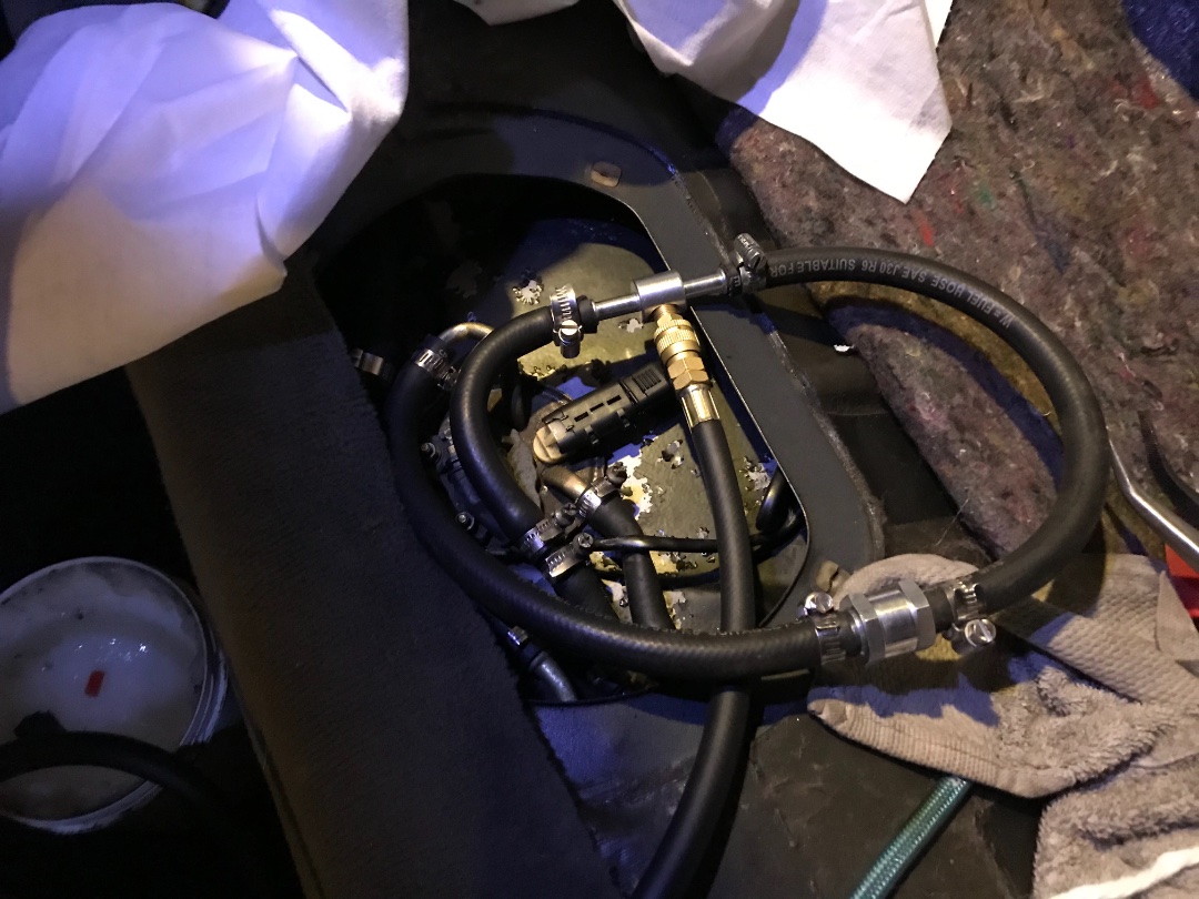

Finally got my arse in gear today to try and find out why I have hard starting on warm engine. Got a fuel pressure gauge and connected in the boot on pump outlets. Switch on pump and get solid 5 bar. Switch off and it drops quickly to around 3bar and after an hour it’s 0 bar. Activate pump again and clamp feed line. Same results. Repeat and clamp return line. Same results. So concluded that injector/s leaking. Removed fuel rail and run pump, same results and the injectors aren’t leaking. WTF.
Clamped the return line just after the FPR and switched on fuel pump, holy shit 7 bar. Switched of pump and released the pressure. This time switched on pump got 5 bar switched off pump and clamped at FPR. It’s been 2 hours now and pressure has only dropped to 4.6 bar. My conclusion at the moment is that clamping return line at the pump end just allows the return line to fill up and allows the pressure to leave the rail. So the fault is with the FPR.
I’ll see what it like in the morning. I’m hoping for at least 3.5 bar left after an overnight sit. As I’m in no hurry I’ll probably buy the "o"rings and see if that fixes it and if not get a FPR.

Yes, my understanding of it now is that the pump is capable of way over 5 bar and it’s the pressure regulator that maintains the fuel rail pressure at 5 bar so there’s always a fair bit passing through it and returning to the tank. Mine did actually hit 7 bar. So obviously the 3.5 bar pump is capable of pumping in excess of 5 bar. Just having to work at the top end of its ability.
After 4 hours last night it was at 4.2 bar and this morning it was 3 bar. So ordered the 2 "o" rings to see if that sorts it, if not I’ll get a regulator. At BMW they’re £147 but the same Prieberg elsewhere is £47. The bloody "o" rings are £11 must be made of some special material sent back from Mars.

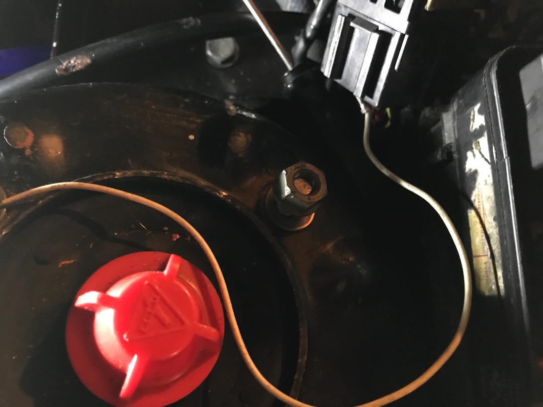

On the electric side I’m confused. This first pic is the earth wire for the fuel pump relay.
If I do a continuity test from where I’ve bared the wire to the relay I get a reading of .450. If I add an earth to the relay I get continuity and the buzzer. With the added earth the fuel pump runs every time the ignition is switched on/off. Which would probably solve the hard start problem. Won’t know for definite till I fit the new FPR when it arrives. Can anyone tell me why or is there a reason why I get a reading of .450 on the multimeter. As you can see there are two earth wires joined and I don’t know where the other one goes to or what component it earths. Would I potentially doing the other component/s harm by having a full earth to the fuel pump relay.

Dan, I just looked at a wiring diagram and see that the earth at the relay is triggered from pin 69 on the ECU, problem is that it switches the earth on at cold start, pump primes, engine starts. If you switch off and try to start it doesn’t trigger the pump again till you start cranking. I’m reluctant to replace the ECU earth with a chassis earth as that would have the pump running permanently the ignition is on. I assume the cold start prime is linked to the coolant temperature sensor. Perhaps if the new FPR holds pressure for a while it will be enough to do the job, maybe, should do, I hope so, fingers crossed, etc etc.

Pull the plug off of the temp. sensor to check. Disconnected sensor = very cold engine, as far as the ECU is concerned.HenryM3 wrote: ↑Sun Feb 28, 2021 7:39 pmDan, I just looked at a wiring diagram and see that the earth at the relay is triggered from pin 69 on the ECU, problem is that it switches the earth on at cold start, pump primes, engine starts. If you switch off and try to start it doesn’t trigger the pump again till you start cranking. I’m reluctant to replace the ECU earth with a chassis earth as that would have the pump running permanently the ignition is on. I assume the cold start prime is linked to the coolant temperature sensor. Perhaps if the new FPR holds pressure for a while it will be enough to do the job, maybe, should do, I hope so, fingers crossed, etc etc.
