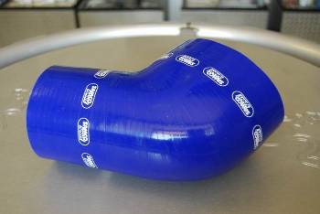

If we have to go with a cone then so be it, the amount of squish on the inlet boot tween MAF and plenum probably isn't going to be too good...
Hopefully the spare plenum will be finished for tuesday,
Thanks for throwing up the pictures Penton!
Fri Jun 22, 2012 10:53 pm
Ideally you need something like this to move the box back far enough
