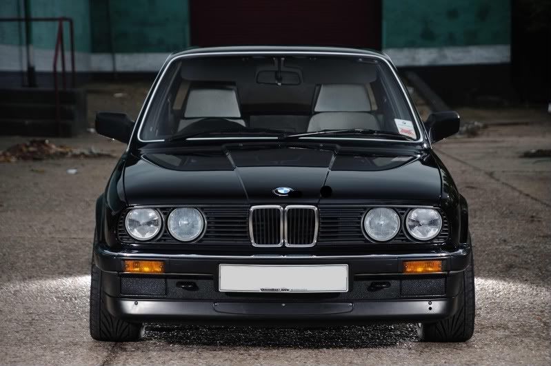

Mine gets hot in summer with the AC on if im not moving at reasonable pace, the fan struggles to cool it down. But, I dont have the lower cut-out in the valance or even the one thats meant for the oil cooler, I really dont want to change the valance so im going to try and get a thicker cored rad made which will hopefully help
Tue Jan 03, 2012 10:55 pm
Cut the grills out a little where they are blanked off..?
Tue Jan 03, 2012 11:18 pm
Yep, had that in mind for a while, will practice on my track car first though :)
Also going to try and duct the air at the rad properly as im sure loads is going straight past it out the sides, maybe chop up an old standard duct that usually gets binned when fitting an elec fan
Tue Jan 03, 2012 11:21 pm
M3 Grilles needed Dan there's a lot more air passes through the slats, is that an Aircon kidney?
DanThe wrote: Image
Dan, I want to bum your car
Tue Jan 03, 2012 11:23 pm
There was a plate for the M3 that covers the gap between the slam panel and the rad, forcing air through.. Could be worth a look. X-Works made one up..
Tue Jan 03, 2012 11:39 pm
No gap there on mine mate, the E36 rad is up against the front panel.
M3 grille would be better, about 20% more airflow I reckon?
I think its just a standard kidney Steve, AC just has the top blanks chopped out innit :)
