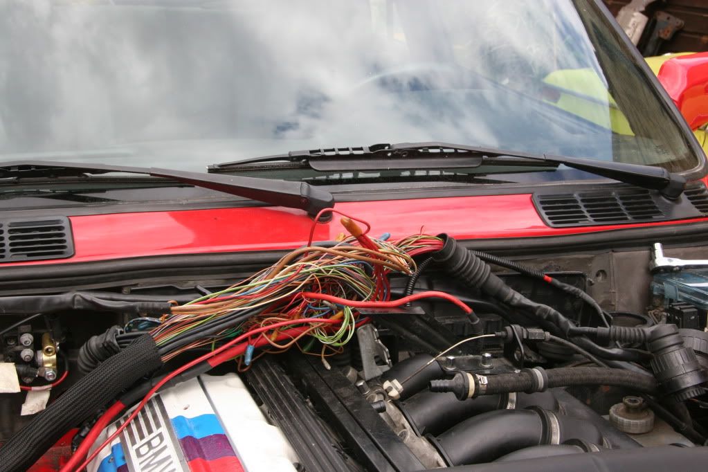

Thanks for the advice. I've tried stuffing it into the s14/m40 covers without much joy, it seems a z3m loom is a better option but for the time being a load of loom wrap some zip ties and some "I don't give a ****" attitutude, is working fine.
Here you go Pete
Here you go Pete
- Posts: 18168
MrBenn wrote:Thanks for the advice. I've tried stuffing it into the s14/m40 covers without much joy, it seems a z3m loom is a better option but for the time being a load of loom wrap some zip ties and some "I don't give a ****" attitutude, is working fine.
Here you go Pete![]()
That looks like a nice shiny turd !

I used the ZM wiring loom in my RHD car and it worked fantastically. The ECU sits in just the right location (where the 325i ECU was). I see yours is a LHD (M3??) so couldn't tell you which loom is best. Getting it under the S14 wiring covers was a complete pain in the rectum but nothing complicated, just shortening wires where possible and going nuts with cable ties and nice low profile soldered/heat shrunk joints.
Get some more pictures up dude.. I do love a nice S50'd E30...

Cheers Jai, I hadn't really thought about just chopping out the unnecessary lenghts of wire that are in there. The ECU lives in the same place for all e30's. At the moment the ECU is only just inside the cabin and won't reach the standard position bit its fine for the moment.
More pics in the photo gallery.
