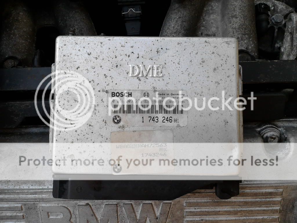

Had a look on real oem and typed in numbers off ecu an its come up with this...
You Have Selected: 03/1995 E36 316i 1.6 Compact M43 Europe Right hand drive Manual
So not sure wtf is going on now :roll:

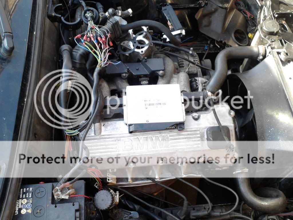

Engine and ECU pic needed matey!
http://www.pelicanparts.com/bmw/techart ... Repair.htm
Have a look down the list and see what Bosch P/N you have on the ECU, should tell you what it's from.

Wed Mar 28, 2012 5:40 pm
Having properly looked at the M42 sticky it`s quite clearly NOT an M42!
Although it does have four coils but in a straight row as opposed to a cluster.
But my obviuse(spelt?) mistake was.. no twin cams! :o: :x
I`ve deffo decided to rip it out the poxy 1.6 and start again with my M50.
Thanks for your time an help mate 8)
