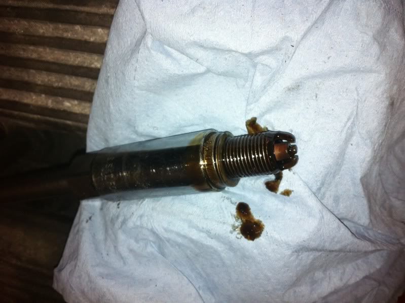

Mystery problem identified, and quite simply actually. I finally got round to doing a compression test, which turned out to be completely irrelevent as when I removed the first spark plug it was dripping in oil:
Must be piston rings or perhaps a headgasket leak between oilway and cylinder.

It doesnt look like this oil is from inside the engine (in the cylinder). The rocker cover probably leaks a little oil from the inner edge of the gasket, which will collect arround the top of the plugs. This is confirmed by the oil tide mark around the bottom of the socket in the picture. As soon as the spark plug is loosened and removed this oil that has collected on top of the plug flows down, coating the threads and the electrode, exactly as per your pic. If you had a plug this wet in the engine it would have a serious missfire at least.
I have not posted this to diss-prove your theory by the way, just dont want a potentialy good M42 off to the scrap heap when it could live on!

Ok thanks, that makes sense. I wish I'd continued with compression test now. It may have saved me an engine swap. Oh well, all will be revealed when I strip the engine down.
