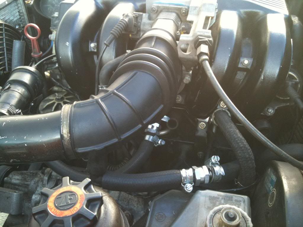

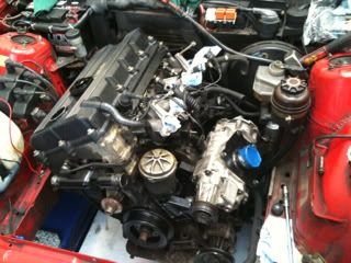

I HAVE JUST FINISHED THE CONVERSION BUT CAN'T GET THE CAR TO START UP AND IDLE CORRECTLY.
The first time i started the car it idled and started but after a minute or so it started chucking oil out of the filler cap.
i realised the pressure was pushing through the rocker cover from the supercharger via the plastic pipe just after the air flow meter.
I will post pics asap!
appletree if you read this i think your're my man!! lol
your name seems to be popping up everywhere
thanks people
thanks people

TamTom
- Posts: 181
- Joined: Thu Sep 24, 2009 11:00 pm
is this a one way valve which connects from the plastic flexi pipe before the throttle body and connects the the idle control valve?
i have it connected up this way with the valve flowing towards the ICV but not back obviously.
Worked out that the factory piping was connecting the rocker breather pipe to the throttle body, when the car is idling with the supercharger it sends all the charge through the bottom pipe coming from the throttle body to the rocker cover which is charging the rocker case with air and blowing out oil from the filler cap!
Really baffled?
i have the BOV connected just before the throttle body circulating back to the inlet of the supercharger.
i was told to take the vaccum pipe off a t piece from the feul regulator, is this correct?
Really baffled?

TamTom,TamTom wrote:is this a one way valve which connects from the plastic flexi pipe before the throttle body and connects the the idle control valve?
Really baffled?
The Eaton M45 is what’s known as a roots pump. If not familiar with roots pumps I suggest that you read up on them. Lots of books out there and plenty on the net.
The basic problem you have here is that a Roots pump pumps a constant VOLUME of air per rotation of the pump shaft. Hence, at idle speed, your Eaton is trying to supply your engine with more air than it actually requires to idle. Since you have connected your ICV (if I understood your explanation correctly) to the rocker cover, it is logical that all you will do at idle is blow oil everywhere.
And, at a guess, I’d say the only reason you started blowing oil after about a minute is because that’s about how long it took for the one way valve in the hose to the rocker cover to fail under pressure. They really aren’t designed for that.
To counter the problem of making boost at idle, all superchargers must be fitted with a bypass valve, what you are calling your blow-off valve (BOV). However, by the sounds of things you have your BOV incorrectly plumbed in. The BOV diaphragm requires VACUUM from the engines inlet manifold (AFTER the throttle body) to literally SUCK on the BOV diaphragm and thus open the BOV so that the excess air from the pump outlet can be circulated back to the pump inlet. The fact that your BOV isn’t opening accounts for the fact that you are effectively making boost at idle, except that in your case you are pumping this excess air into your rocker cover!
First off, lose the hose from the throttle body/ICV to the valve cover. At least then she’ll stop blowing oil everywhere. Second off, get your BOV working properly. Check that it’s opening as it should by sucking on the line that goes to the BOV diaphragm.
Oh, and technically it’s a bypass valve on a Roots pump, not a BOV. BOV’s are really only required on turbochargers. The root of your problem is that you need a proper bypass valve to vent the excess air pumped by the pump each time you close the throttle down, such as when at idle.
HTH
Regards
Geoff

TamTom
- Posts: 181
Thanks for the help Geoff!
Tested the recirculating valve which opens under vaccum, where is the best place to buy one of these if i were to put a better one in its place?
Also is it important that the vaccum pipe for the bypass valve to be after the throttle body or after the butterfly?
I have a vaccum line running from the throttle body to the feul regulator this is where i have been told to pick up the bypass valve vaccum from is this correct?
Your help is much appreciated!!!
Tam.
Tam.
GeoffBob
- Forced Induction Specialist
- Posts: 1843
- Joined: Tue Apr 28, 2009 11:00 pm
I haven't a clue Tam, unless of course you're also down here in South Africa?TamTom wrote:where is the best place to buy one of these if i were to put a better one in its place?.
After the BUTTERFLY, extremely important!!! The point is, when the throttle (butterfly) closes down, the air pressure in the inlet manifold falls lower than atmospheric pressure (meaning a partial vacuum forms). Anywhere BEFORE the throttle body (butterfly) could still be at a positive pressure (boost) because of the supercharger. There is, therefore, a substantial pressure drop over the butterfly when it is almost closed. It’s this pressure drop that sucks on the BOV diaphragm (causing it to open) and the fuel pressure regulator (FPR).TamTom wrote:Also is it important that the vacuum pipe for the bypass valve to be after the throttle body or after the butterfly?
Should be fine so long as that line from the throttle body originates from AFTER the butterfly. If not then both your BOV’s diaphragm and FPR will be feeling pressure at idle and not vacuum!! I’d check that carefully if I were you. My line to my FPR comes from a connection that is tapped into the manifold so I KNOW that I have vacuum in that line. A connection to a throttle body can be deceiving since you are not sure if the source of that connection sits before or after the butterfly.TamTom wrote:I have a vacuum line running from the throttle body to the fuel regulator this is where i have been told to pick up the bypass valve vacuum from is this correct?
Get that sorted and I think you’ll come right for sure. And lose the breather from the rocker cover for the time being if you haven’t already.
Best of luck
Geoff
PS: And if you don’t yet have one, get a pressure gauge (one that reads both boost and vacuum) connected to your inlet manifold as well. That way you’ll know your intake pressure. I have no idea what your pulley ratio’s are, but you’ll want to know your intake manifold pressure lest you blow your engine up!
"It is amazing how many drivers, even at the Formula-1 level, think that brakes are for slowing the car down." - Mario Andretti

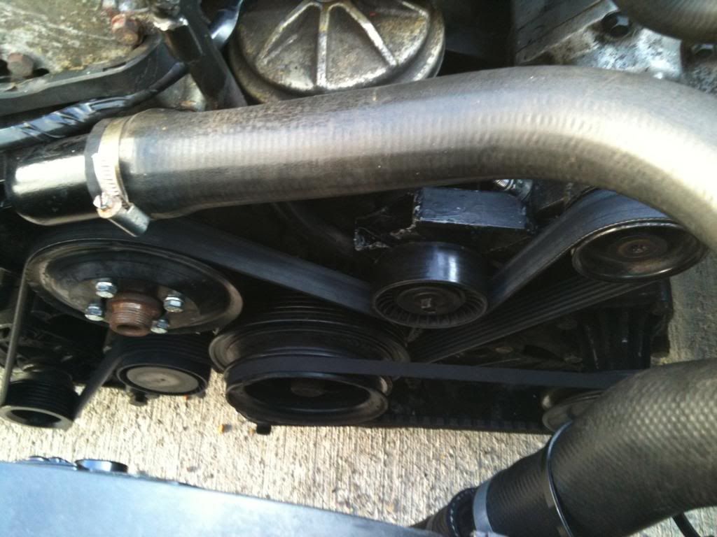

TamTom
- Posts: 181
tried to get the car running again using 1 way valves and switching pipes from and to various places all at no avail!
Tried connecting the idle control valve to the the inlet duct just before the throttle body so the pressure from the charged side would be flowing through to the ICV when at idle bypassing the butterfly and throttle body completely!
Also connected the pipe which comes from the throttle body before the butterfly to the rocker breather, which originally ran to the ICV.
tried many things using 1 way valves etc and trying different combinations etc!
Getting very disheartened!!!!!!!!!!
The pulley is around 10cm diameter on the charger and then run on 1 ribbed belt to all other ancillaries water pump, alternator etc which is turned by the crank!
Power steering is run on a seperate pulley!
Need to get through this rough patch,
Could i be running too much boost?
GeoffBob
- Posts: 1843
You'll need to tell me the exact dimensions of your crank pulley and your Eaton pulley if I am to tell you if you are spinning your Eaton too fast (thus pumping too much air).
Tam, I think you may be confusing how some of these parts are intended to work, and you may not be aware of the fact that they won't work the same on a supercharged engine the way they do on a stock normally aspirated engine.
Any idle control valve functions to bypass the throttle body. That's its purpose in life. It allows a certain amount of air to escape around the throttle body (as opposed to passed the throttle butterfly) in order to control your engines idle speed. The fact that your engine is now supercharged means that your ICV absolutely MUST bypass air from BEFORE the butterfly to AFTER the butterfly. It cannot (MUST NOT) draw air in from any line that goes to the rocker cover or any other emissions control device on your engine - else you will blow oil everywhere! If you can't get it to work this way, then you have a problem.
Point of fact: If your bypass valve (your BOV) is not opening at idle your Eaton WILL try to supply too much air to your engine (its an air pump for goodness sakes, that's what it does - it pumps air). Hence, your engine will either idle fast or (if you have connected your rocker cover to somewhere between the Eaton and the intake valves) it will simply pressure your crankcase and rocker cover causing it to p!ss oil everywhere!
So, for the last time:
1) Disconnect your rocker cover breather hose from your system. Leave it hanging for the time being. Your Eaton must in no way be able to pressurise your rocker cover or crank case. Are we clear on this?
2) Block off any outlets on the line between the Eaton and your inlet manifold that may now leak air. We don't want your Eaton leaking air anywhere, except for when your bypass valve (BOV) opens.
3) If you are going to use an ICV then for goodness sake, it needs to work so as to bypass air passed the throttle body butterfly. That's it's job in life.
4) If your engine now idles high (because your Eaton is trying to pump too much air into it, which it probably will do) then get your bypass valve working properly. So long as your bypass valve is open it will prevent the line from your Eaton to your throttle body from becoming pressurised, thus allowing your engine to idle normally.
If all of the above fails then check the operation of the throttle butterfly and the idle control valve. If the throttle or ICV are open too wide then it's no wonder you are pressuring your inlet manifold (keeping your bypass valve closed) causing your engine to make boost and rev high no doubt.
As a last resort, unbolt/remove your bypass valve (BOV) so that your Eaton can't build ANY pressure whatsoever. Your engine will now be normally aspirated once again. Get her idling properly while running normally aspirated, and then you can look at reconnecting your BOV. Once the BOV is back on, if the fast idle returns then, clearly, your BOV isn't working as it should. Probably because either:
a) You don't have the BOV diaphram connected to the correct place (should operate under vacuum from the manifold, AFTER the butterfly), or
b) Your butterfly/ICV are just too damn wide open to allow a vacuum to form in the manifold in the first place. Without the required vacuum (suction) from the manifold the BOV will simply remain closed. In which case, remove the ICV (blanking off the holes left behind) and adjust your butterfly manually until she idles properly.
TamTom
- Posts: 181
will i run too much boost if i use the e36 crank pulley directly running the standard eaton 45 pulley which is about 7cm i think ?
GeoffBob
- Posts: 1843
Have you tried what I suggested above? If so, please give feedback. Very difficult for me to suggest a solution if you don't provide feedback on the status of your problem.
Your Eaton M45 pumps 750cc of air for each rotation of its pulley. Your M42 motor, on the other hand, inducts 900cc of air for each rotation of its crank. Hence, with your pulley ratio of 2.2:1, your Eaton will effectively pump 2.2 x 750cc = 1650cc of air per rotation of the crank.

[img]http://s1080.photobucket.com/albums/j33 ... oto2-1.jpg
[/img]http://s1080.photobucket.com/albums/j33 ... o-1.jpg%26
[img]http://s1080.photobucket.com/albums/j33 ... 3-1.jpg%26
[/img]http://s1080.photobucket.com/albums/j33 ... 4-1.jpg%26
[img]http://s1080.photobucket.com/albums/j33 ... 5-1.jpg%26
[/img]http://s1080.photobucket.com/albums/j33 ... to8.jpg%26
does anyone know what the pipe with the bolt in is for on the supercharger?
Also any advice on relocating components and piping like the swirl pot and feul lines etc.
GeoffBob
- Posts: 1843
Would help immensely if the pics were visible.

Anyone know what the blanked off hole is used for on the eaton 45 supercharger?
This is just covered by a bolt!

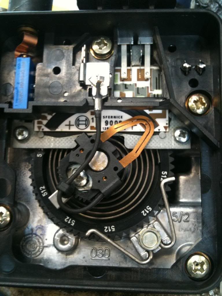

anyone know the co readings i should be aiming for too?
I am getting 9.06 co and HC 462ppm
got a second reading of 6.76 and 385 after fiddling with the afm!
not sure what does what on the afm.
there is the circular spindle and the small blue screw on the side?[/img]

The bolt in the red hole is normaly for the brake servo iirc, that's what I used it for anyway, real oem might give you a drawing go it I'd you have a look.
In you application though it can just be blanked off properly with a bung

The blanked off hole with the red push fit goes to the bypass valve on the mini but they run the throttle before the charger un like your set up.
