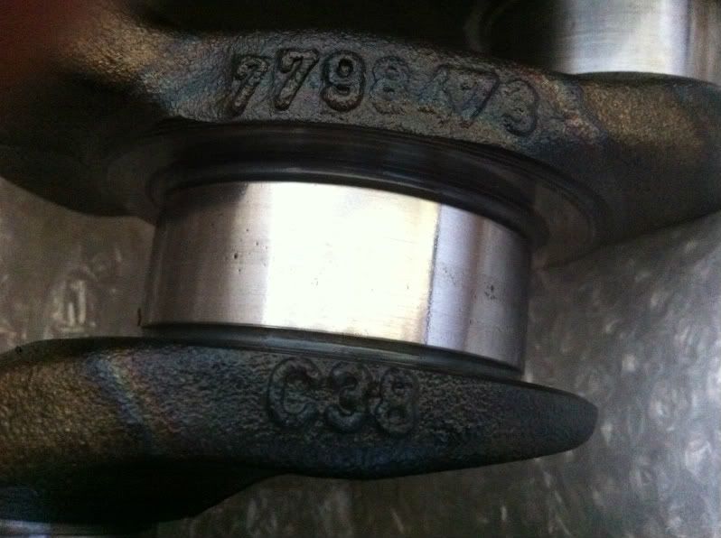

Not doing very well on the stroker build either! Second crank got lost in the post, so the seller sent me "another one" which is a another bloody stubby nose!
Here's its cast number:
Anyone got cast number number for the correct 'long nose' crank. Either the 88mm or preferably the elusive long nose 90mm!

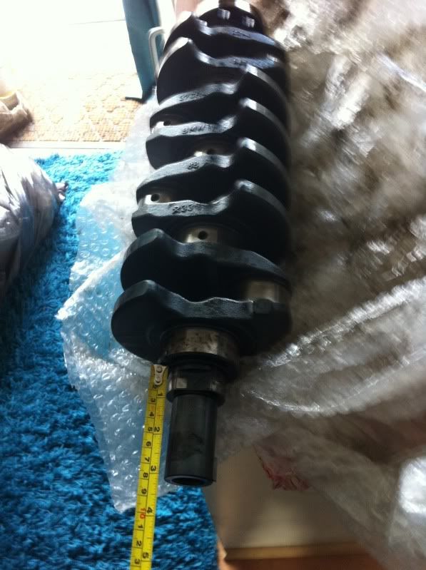

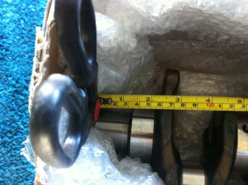

YEESSS! At last I have the right crank, 76mm nose 88mm stroke:
