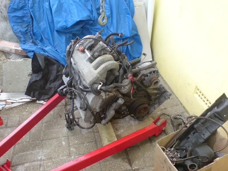

Right folks. Today I picked up an E30 318is engine, loom, ecu, manifold, inlet, afm and even the brackets that weld to the wing to fit the coil pack to. So the twin cam conversion is now back on the cards, but from a much better starting point!

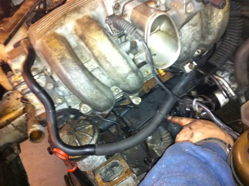

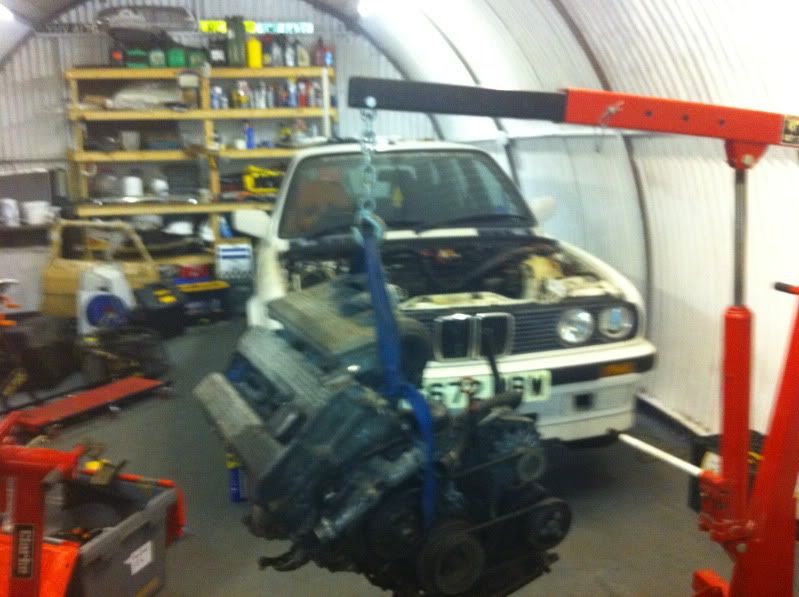

Well after a couple of days hard graft, it's done - ish. Old m40 engine is out and New m42 engine is in:
No real drama's - just my own stupidity waisting a couple of hours trying to get the engine off the gearbox with one bolt left in - doh!
I have found out tho that you can either use the round type engine mounts (from the IS) or you can use the diamond shape block one's (from the 318i) by simply turning them upside down!
It is ready to go and I have had it running briefly but it sounds like a tank at the moment because the exhaust isn't back on...
... and this is the only real issue, my friend and another BMW specialist garage have looked in three exhaust books and I cannot find where you can buy a new front section for a pre 1990 (non cat) 318is. Anyone got any ideas?

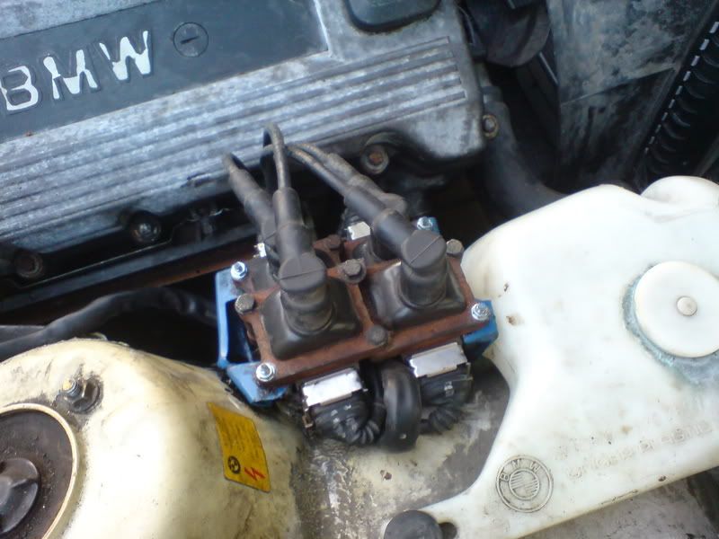

...and yes the coil pack is tied on with string, I'm just waiting for my painted brackets to dry. lol

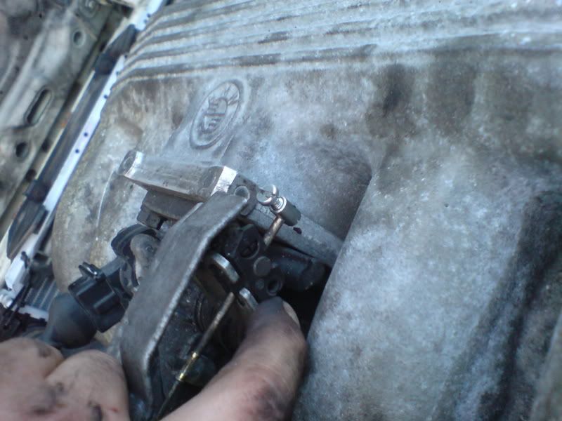

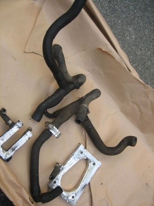

Thought I'd touch on some of the things I encountered doing the conversion incase it helps anyone considering it. Firstly, the IS has a bigger rad and you'll also need it's px side lower rad mount, it's longer top hose and preferably it' cowl. But I made a simple little bracket up to use the 318i cowl:
As mentioned before you do need the coil pack brackets from a donor car (see below), unless you want top make your own.
The accelerator cable also has a different end on it (which I lost- doh) so I cut my 318i item down to fit in the bracket and used a solderless nipple to keep it in place.

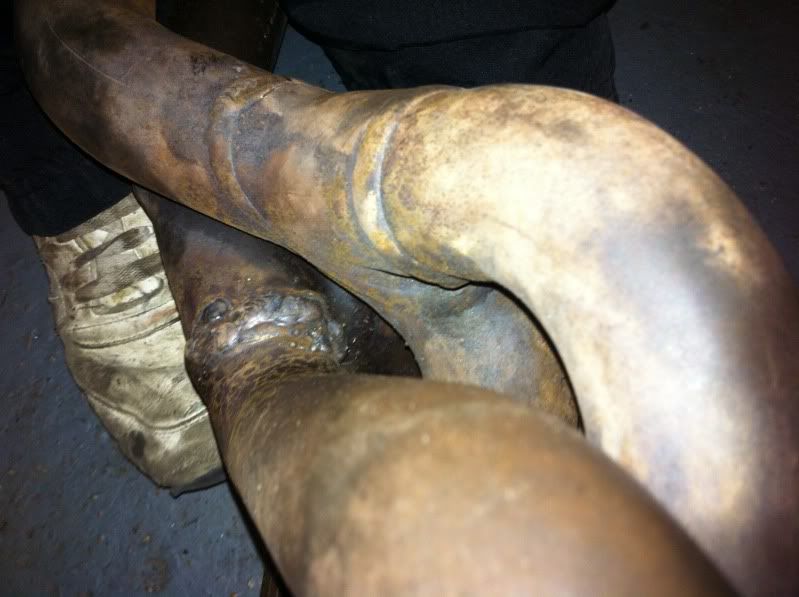

The 318is exhaust front section was too short and didn't meet the rear section on my touring, so I cut off the front silencer and extended the pipe. Perfext excuse for a home made straight through pipe.

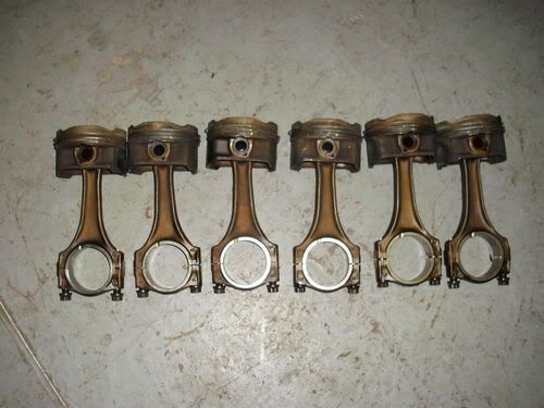

Parts Acquired so far:
BMW E36 M3 3.2 Evo S50B32 conrod and piston set of 6. Pistons are 86.365mm!
Got them very cheap. 5 are in very good condition, 1 has ultra fine marks where 1 big end bearing started to ware, although this is very fine and would probably polish out. But Ofcourse I only need 4!

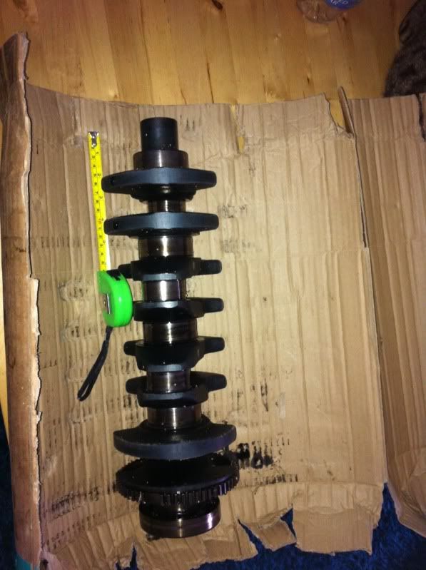

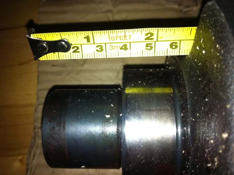

Right, who's gonna give me the bad news then. Is this a stubby end? Looks short to me, compared with the pics on Metric Mechanics. Its M47R 88mm. Its 34mm or about 60mm measured from the start of the collar.

tim_s
- E30 Zone Squatter
- Posts: 1661
- Joined: Thu Feb 03, 2005 11:00 pm
- Location: Bristol/London

Bugger. Can't find a 88mm 320d one anywhere!

They are like buses these M47 cranks I now have found two from pre facelift e46 320d's. Just confirming the details, but i will be buying one. And the bloke who sold me the stubby 88mm M47R is willing to swap it for a 90, so I'm gonna do that too. Then I can persevere with the 90mm and if that is too expensive/complicated I'll have the 88 as a backup!

Good news! I'd personally not bother with the stubby nose 90mm and just use the 88mm - what rod length are you going to use? The m4x struggles for block height to pull off a decent rod ratio with them, for the tiny increase in capacity it's just not worth it to go 90mm for the potential increase in wear. Also there's a long nose 90mm you can get too...

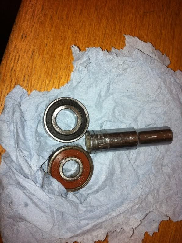

Well interim standard(ish) m42 engine is in, just needs fluids before I start it. But everything has been a bloody struggle. A couple of rounded off allen bolts on the old clutch had to be cut off. The spigot bearing was too small and engine wouldn't go on m40 gearbox. For those that don't know it is located in the end of the crank here behind the clutch.

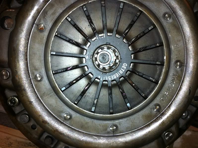

I got the pilot / spigot bearing part number off realoem but all the parts places computers said it was a clutch release bearing, but I ordered it anyway to see and it is the correct spigot bearing, so don't worry if you end up in the same situation.
Part number is: 11211720310
Sach's part number is: 1863869036
old one and new one
I can only assume it's the bearing to suit an M10 gearbox?
Anyway it's all back together and fingers crossed new engine isn't a piece of shite.
I also took the oppurtunity to take some pics of other bits and pieces i'd already sorted, when car was still on the road:
Exhaust manifold had cracked the whole way round, so I welded it.
I had also previously got rid of the horrible mess of engine breather and water hoses under the inlet manifold and leading to Throttle body heater plate. I ditched all the water pipes leading to TB and it only left two pipes spare, one in the engine block and one in the coolant bypass pipe on the side of the engine block, which I connected together with a new hose. (forgot to take pic, but found this on m42club)
I replaced the breathers with spare pipes connected together. It connects Idle control valve to the breather pipe on the front of the engine.
You end up with this shite,
apart from I have put my heater plate back on, simply to act as a spacer for the TB so my airbox sits on standard fittings

Stroker build update:
The bloke with the short nose 90mm crank sold it, even though i'd paid for it? So he's now refunded me.
No loss because the long nose 88mm crank should hopefully be here this week.
