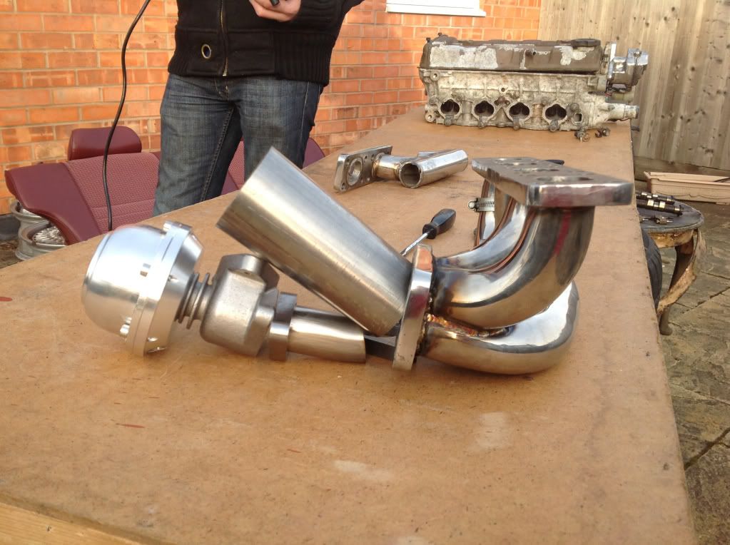

Finaly my wastegate:

Check that wastegate for leaks in the lower chamber, if there is significant you´ll have terrible boost control.

ok will do, have you had trouble with these before?

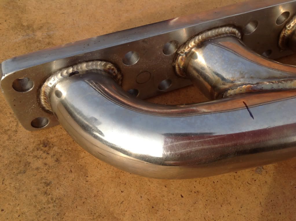

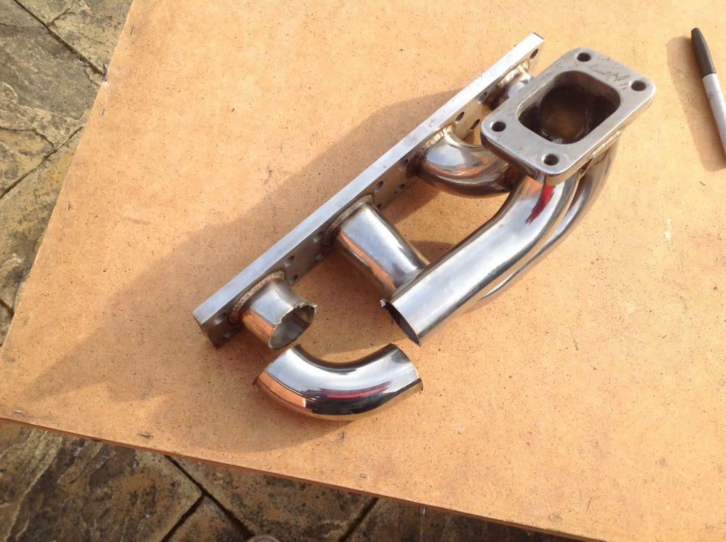

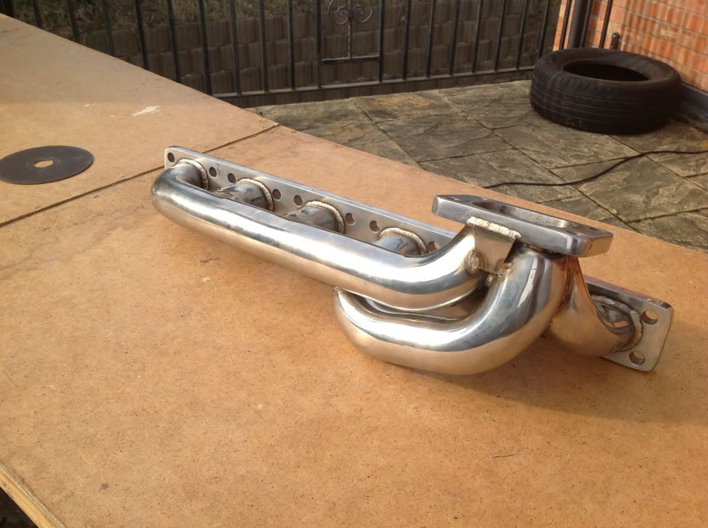

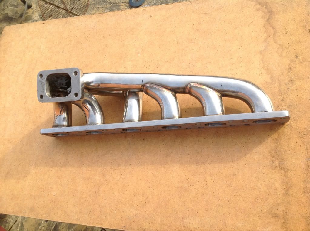

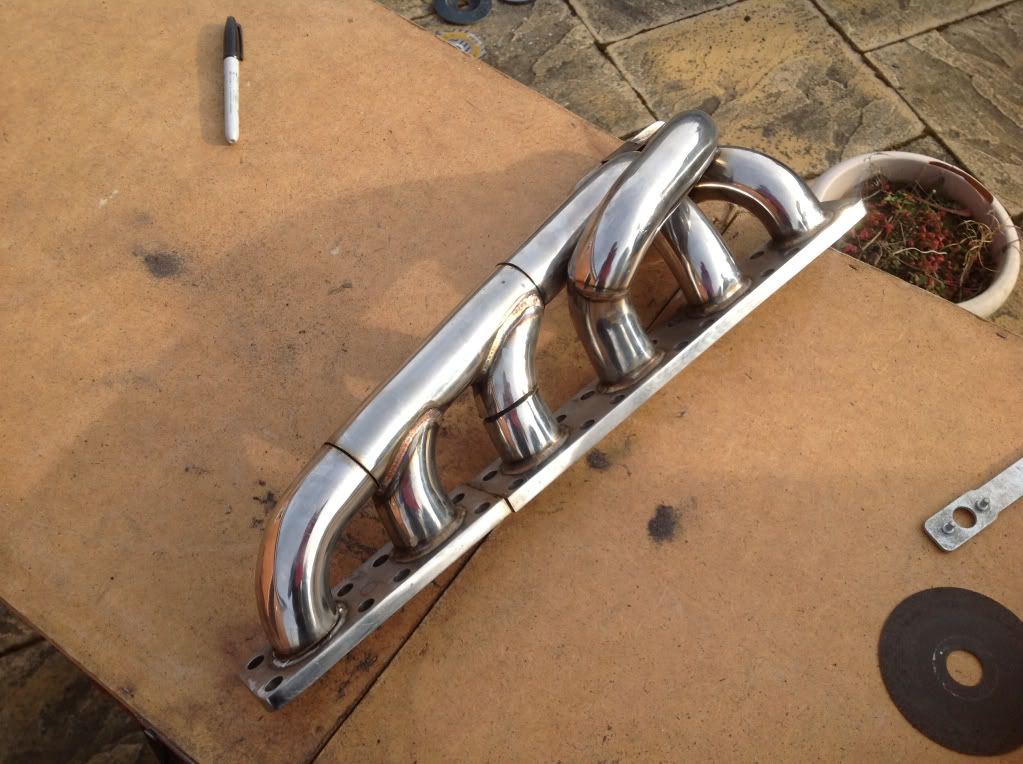

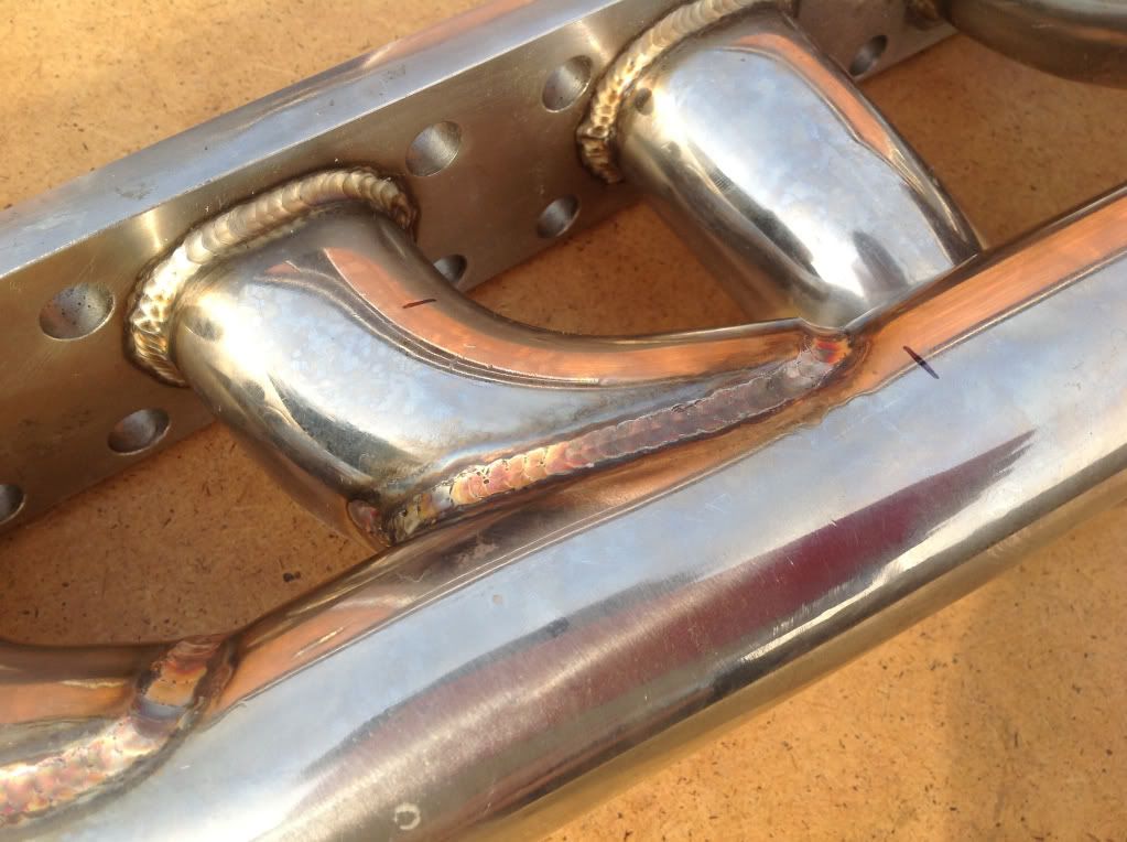

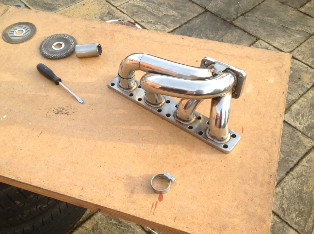

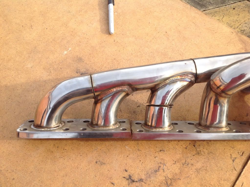

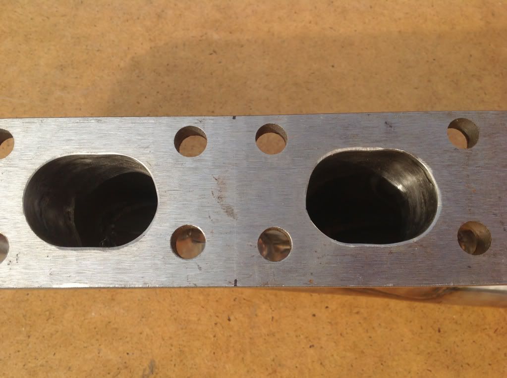

I have gathered few more items since my last post but not much has happened.
Been the weather has been nice I though I would get the grinder out and make a start on the turbo manifold, modifying it for a 4 cylinder and getting rid of the nasty joins.... The best way to show this is with pictures! So enjoy....

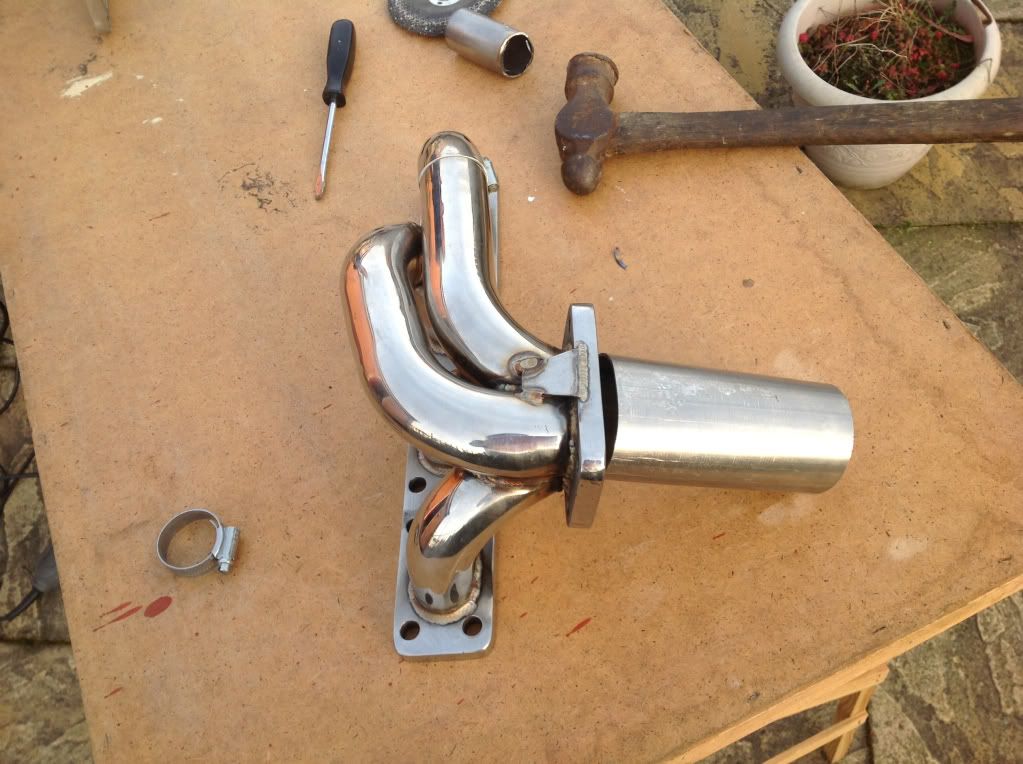

Next is to work out how much I need to extend the flange height and see where the waste gate is going to sit....
Little random mock up:

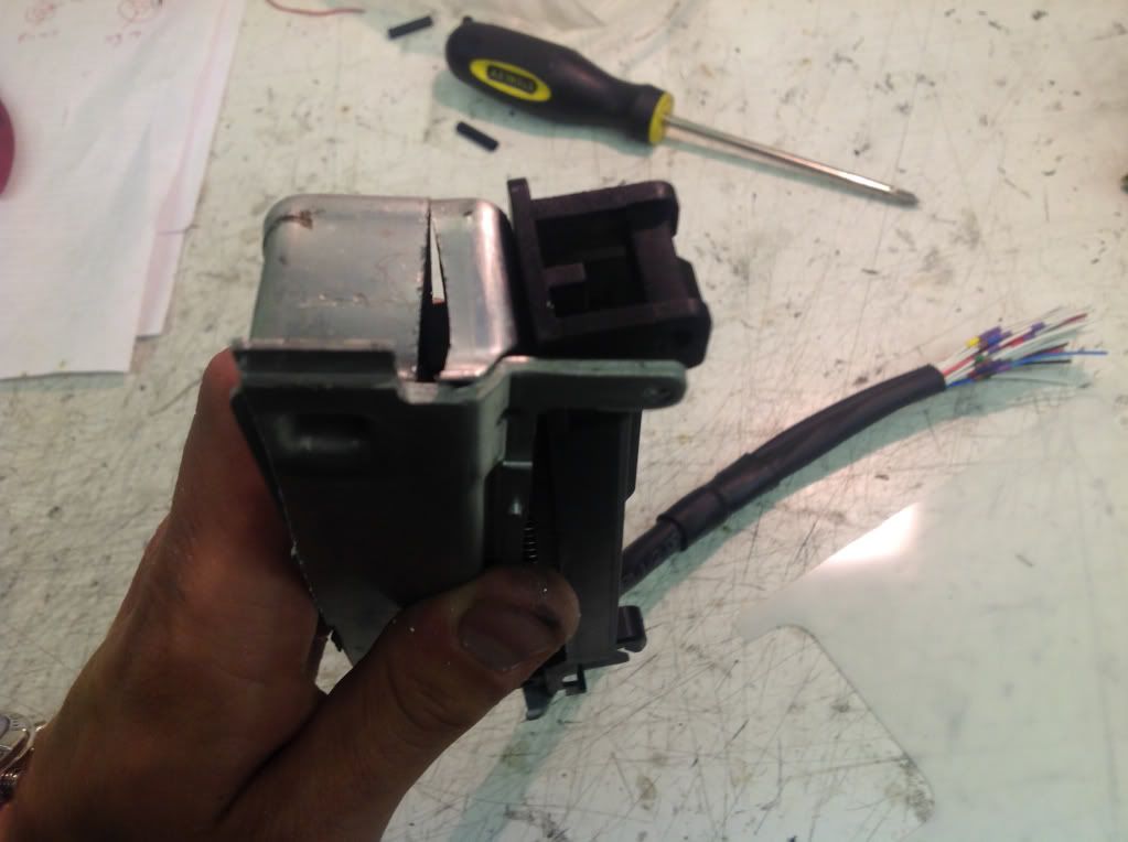

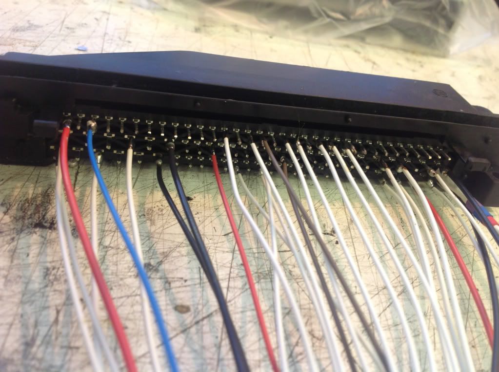

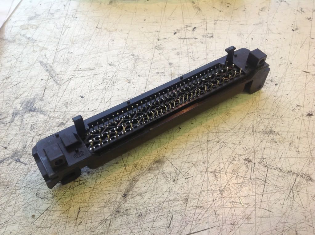

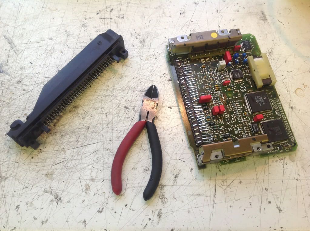

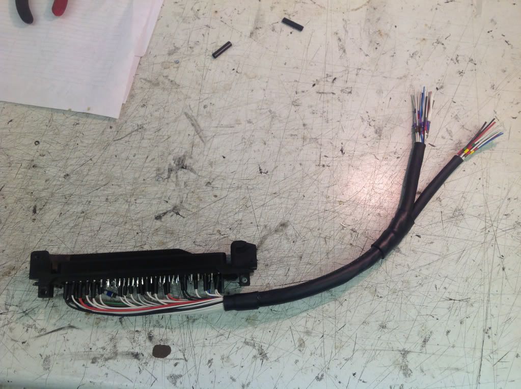

Started work on the ECU adapter today.
Cut the old ECU case
I couldn't hold it all and take a photo but you get the idea...

Sweet. Is the manifold all welded up now?
Minimayhem81
- Posts: 340
- Joined: Wed Apr 06, 2011 11:00 pm
- Location: Bedford
Not yet, my dad owns a tig welder but just haven't got round to doing it... With the racing I just never have time
