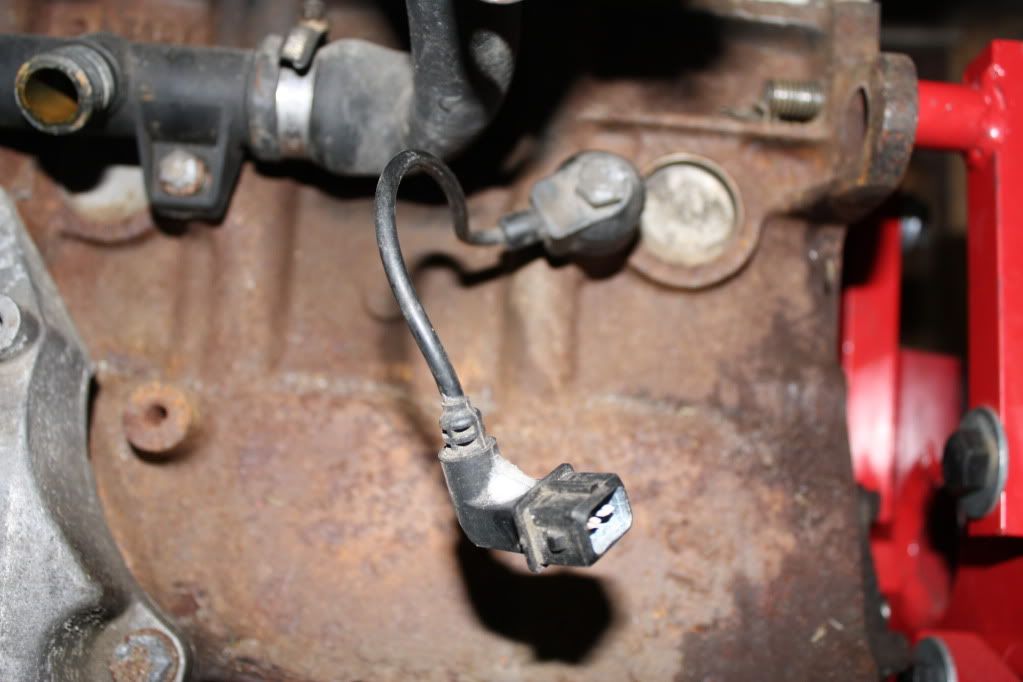

when i did my conversion i used a e36 is engine with the ecu and an e30 engine loom, e36 engine had knocksensors on it and the e30 engine loom doesnt have the provisions for these so i butchered the e36 engine loom to get the wires out and fit them to the e30 loom

Also, excuse my ignorance here but what part do the knock sensors play? Is it an extra cable on the loom that goes somewhere or what? Assume I have no idea what you are talking about...
Hi mate,
Other way round :) 1995 E36 M42 engine with E30 loom
Knock sensor detects whether the engine is 'knocking'. Knock is an 'explosion' in the engine when it shouldn't be, left over air/ fuel ignites after the spark and main explosion. the knock sensor detects this and and adjusts the ignition to stop it from doing so.
Is this the part you're refering to Zimmer?

thats the one!! although there's two of them one for cyl 1&2 and one for 3&4! could perhaps get away with not using them but thought I had better put them in to be safe!!

Hmm, that's the only one on mine but there was a plug in my loom for it.
