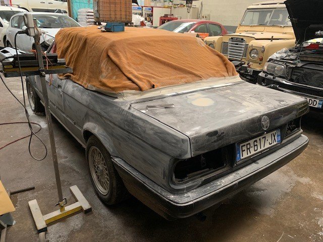

I searched a bit for a e30 m42 loom, but without succes. I guess i will rewire the x20 tot the c101 as illustrated here for the m5x swaps (altough everything is new to me, my previous project was e e21 318i, 15years ago, and i am a vet, not a mechanic :p
here is a pic, from an e30 back from the (near) death;

the car is running fine with its 'new' m42, but I'm already thinking about putting a m52b28 in. Nothing wrong with the m42, but maybe it is'nt a perfect match for the heavier convertible...
Right now the car is at the shop for its new paint job :)
