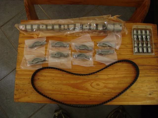

About two years ago I decided to tackle the noisy valve train in my M40, as I had a spray bar that was all gummed up and not spraying onto the cam and the cam had chewed itself up pretty badly.

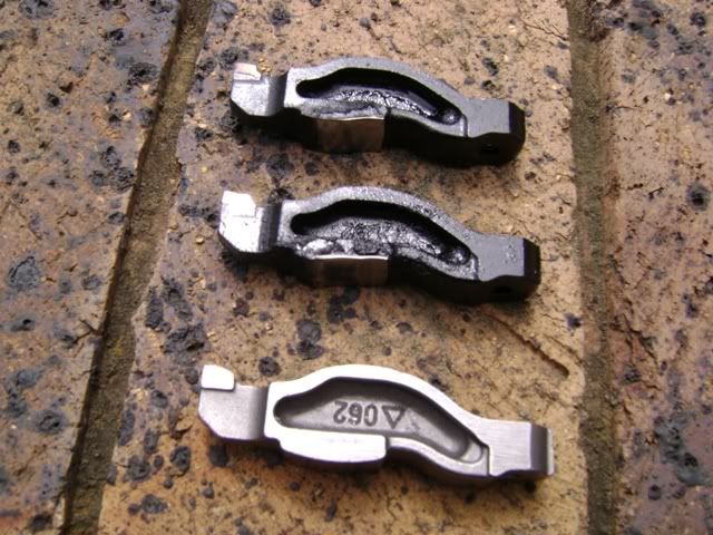

I had to replace the cam and rockers, so I decided to do the lifters as well, to make sure the entire valve train was new, no chances.
I also took a drill and opened up the holes in the spray bar a little bit, to give some extra oiling to the cam, and also to prevent the holes from clogging up as easily.
Bottom line...........................even with a complete new valve train, it still taps away, making a noise, however mine is not always there, it is intermittent, some times it taps away, other times it is as quite as can be.

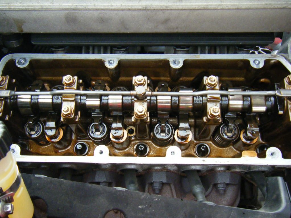

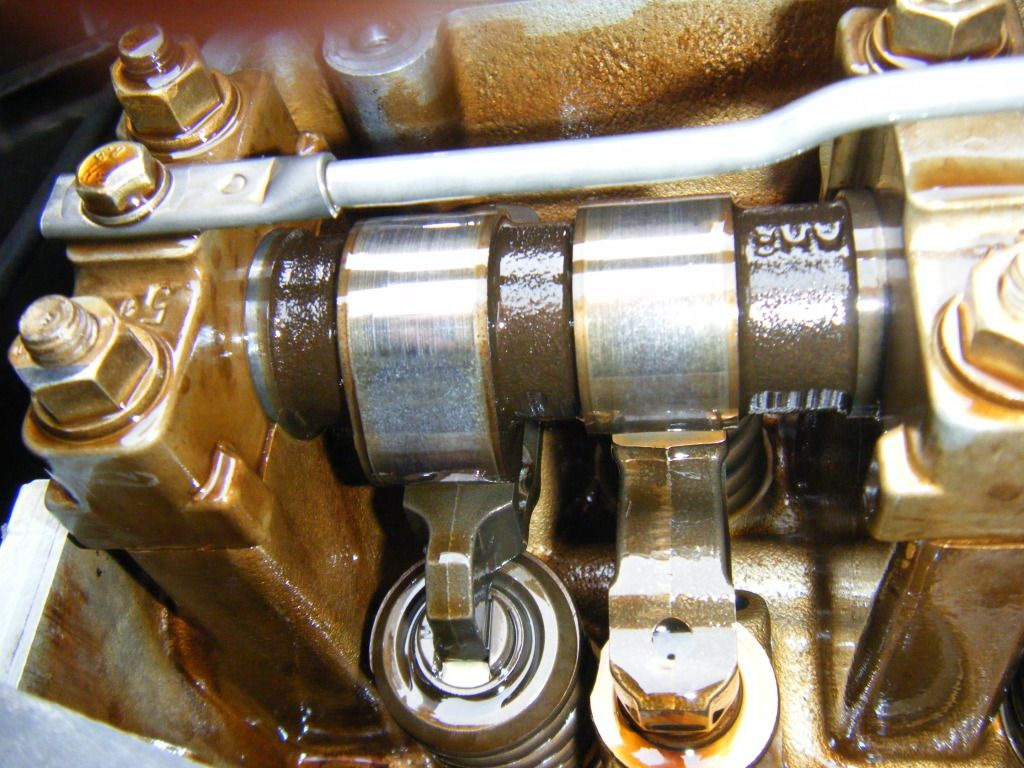

For those who have not seen the carnage created by a blocked spray bar.
Rockers, new and old...
Camshaft
Complete replacement Kit
Camshaft
Camshaft
not seen a worn M40 cam that bad b4
