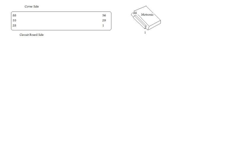

Has anyone got a diagram of what pin does what on an m42 ecu plug?
Anyone got a diagram for what pin does what on ecu plug?

Found it:
Motronic ECU M42 88pin plug
Function Color
Function Color
