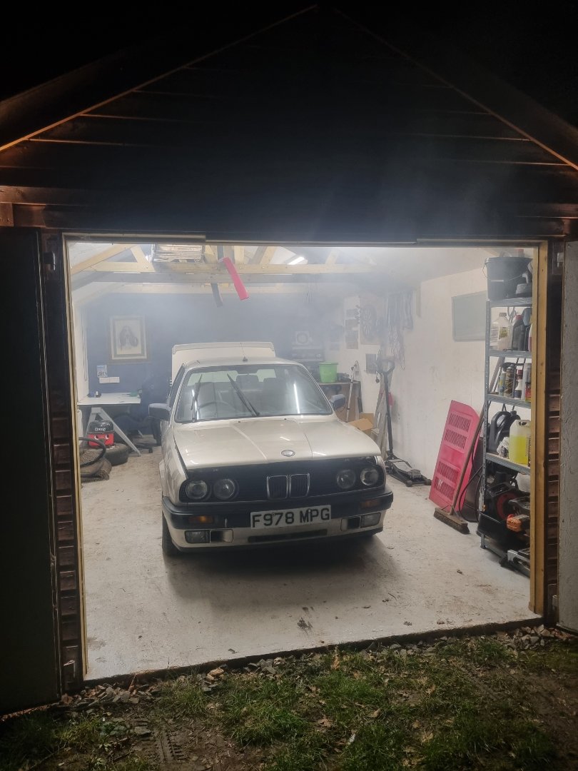

Did fire it up when I first got it, nearly died from fumes but it did sound epic
