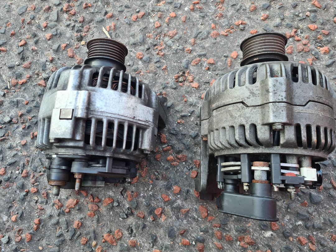

Been messing with it again, with ignition on and exciter wire disconnected from alt it shows 12v and same when running but if you reconnect it it drops back to 1.73.
My old alternator was a valeo but new one is bosch, old one charged ok but terminal was loose. I've just fitted new brush pack and voltage regulator in new one to see if that will sort it.

Thanks Dan, I think I've replaced a bad valeo alternator with a knackered bosch one, I replaced brush pack and regulator and ran 12v to d+ and alternator got hot really quick so think it's an internal fault and had 7v at d+ terminal.
I've got another valeo to try, failing that il buy a new one or get one refurbished.
If I take the d+ lead off the lights on dash go out , d+ lead is producing 12v batt voltage.

Managed to get hold of another valeo cheap and remove the part that was broken where the d+ attaches by heating up the solder and swap it for my broken part on my original one and it's working fine again. No idea why it didn't like bosch ones but there you go
