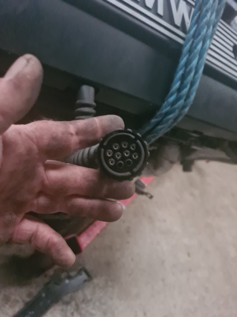

Either having a brain fart or missing something. Stick an engine loom to a e38 m52b28 that was removed from a m52b28 e36 lump that was fitted into an e30.
There isn't a plug on the loom to connect to the coil pack loom .(see pics . Can only assume the e38 coil pack loom is different from the e36?
Any help would be appreciated.

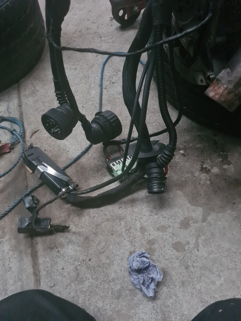

This is the engine loom I have
This is the plug on the engine
Sat Dec 19, 2020 3:22 pm
Bottom right of your first photo

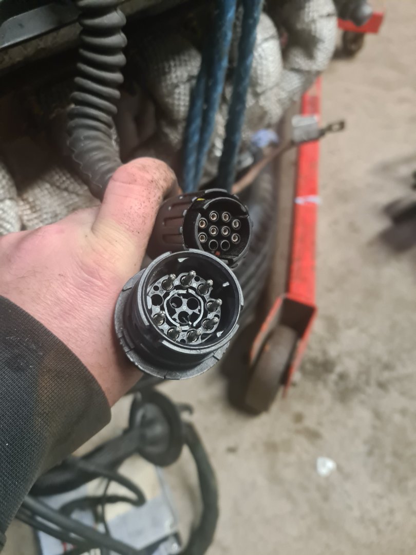

Here is a pic of both plugs Dan . The one on the left is on the engine loom (bottom right of first pic) and the other is coil packs from engine .
Wed Dec 23, 2020 6:33 pm
In that case you will need a coil pack loom from an early 95/96 car
shedrool83
Posts: 4395
Location: Dundee Scotland
Wed Dec 23, 2020 8:01 pm
Yeah got it sorted out and getting the coil pack loom from the engine the engine loom came from .
