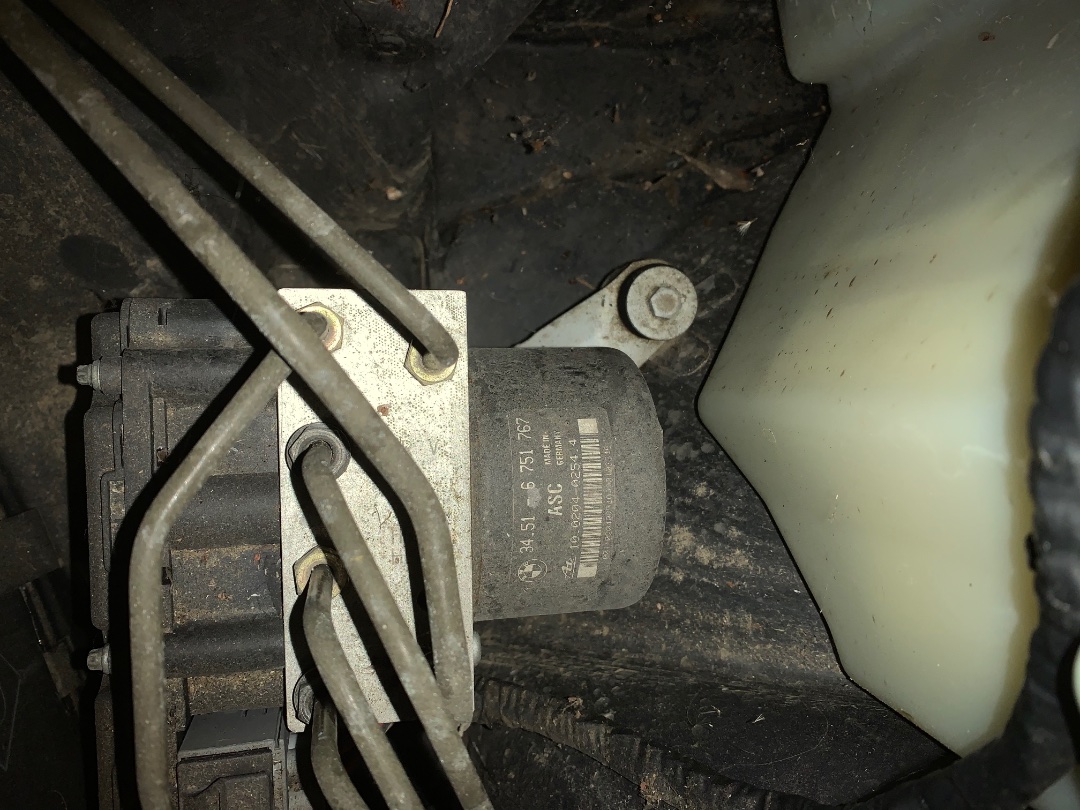

ABS unit

flybynite
Posts: 1693
Sat Jan 04, 2020 2:56 pm
Looks like a MK20 as suspected in a 328. Doesnt play as well as the MK60 in other cars. Still might be worth stripping out along with yaw sensors etc wiring and wheel speed sensors. You never know.
