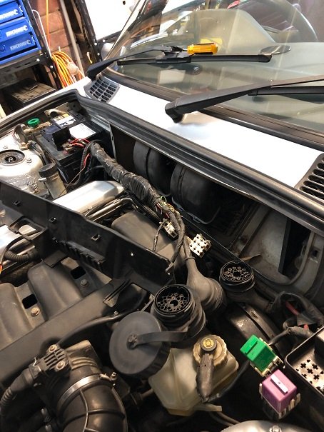

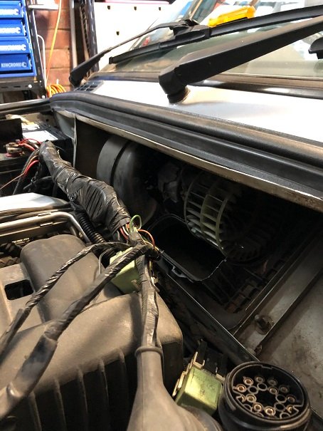

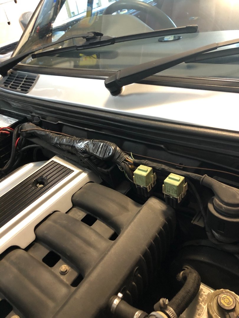

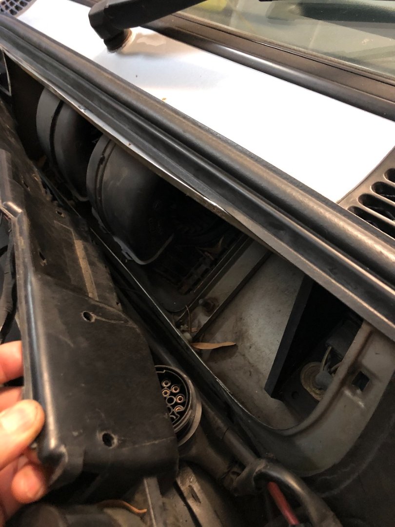

Think I'll hijack this thread to post some update, as there aren't many detail information about this job on the web. Common suggestion is to remove the intake manifold to access the fan motor. I just managed to remove the cover in the bulkhead, there may be enough space to pull the motor out.
ecsk
Posts: 19
Joined: Wed Nov 09, 2011 11:00 pm
Post Wed Oct 14, 2020 7:53 am

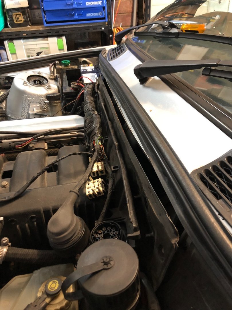

Move the wiring loom plastic holder aside, more space to work.
One cover is out

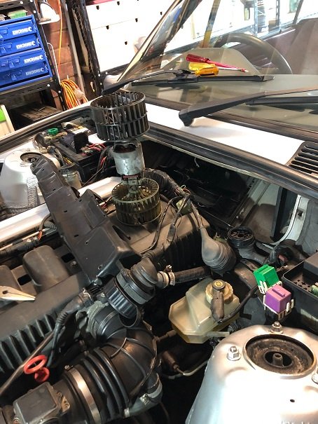

Motor is out :banana:
