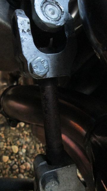

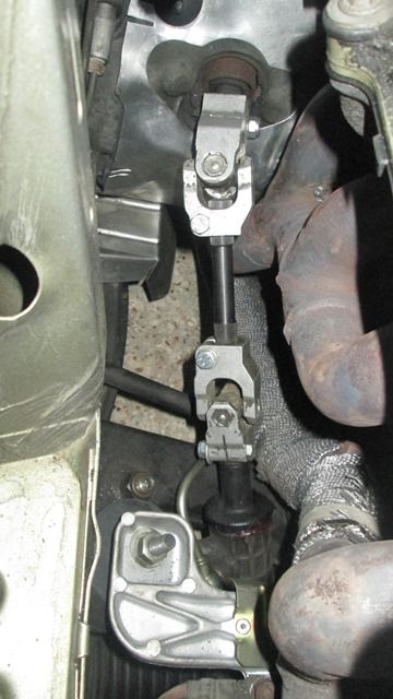

Now that the rack is installed and the whole conversion is completed, I think that the 2nd from top UJ touches the manifold sometime when turning. I feel a little crunch, enough to make me wonder if it will lock and make me crash.
Here is the setup:
Is a new better shaped manifold the only way ? I haven't install any of it so if its not good feel free to let me know
Here is the setup:

Any advise appreciated!

Any slimmer uj's I could use?

And I been told that e36 and e46 racks are same so I got e36 since it was cheapDuke137 wrote:Go E46 rack. If you can the '067' rack as it is a quicker rack. E36 stuff is inferior to E46 and the M3 rack is bad news (lock limiters, it is not 'quicker').

Does this mean the lower fork of the top UJ? If so, it's an easy job to move the steering column across a few mm where it comes through the bulkhead. It's just a clamp and plate fitted on the bottom of the column and a couple of studs through the bulkhead.JF008 wrote: I think that the 2nd from top UJ

Ive used corsa c linkage , 1x e34 uj , tig welded pas pipes e39 and e36 combination, e46 rack with 14mm spacers cut out from e46 wishbone bushing, cut and weld mainfold that broth it 15mm closer to engine. Corsa linkage got smaller diameter so it might give you 2 -3mm more clerance from thd motor

how much clearance do you have from the manifold, the manifold should have been modified to give enough clearance with the setup you have. either that or the engine mounts have too much flex
i have a danthe steering linkage, e46 067 rack and an m52, mine doesnt catch at all, on eurocar parts e28 mounts also

I'd do what Brian suggested and I'd also remove the UJ and round of the edges if it were me. Seems like the least hassle.

If you are gonna round off the edges of the ujs thats fine (i did it) but you will also need rock solid engine mounts as the engine moves when cornering 'spiritedly' and can lock the steering mid turn, trust me, it happened to me, not nice.
2 vibratechnics mk1-2 escort mounts from rally design, sorted

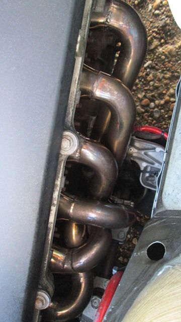

Hi guys thanks for the replies, I got frustrated and bought the whole fritz bits e30-m50 system as the exhaust setup i have is not great to begin with.
The manifolds on the pic are cut welded bought from a zoner which had no problem with it. e28 m5 mounts, e46 regular rack and danthe package.
I thought about rounding up the edges of the uj but I did not know the steering column could shift a few mm!! Neither did my now very expensive mechanic! bastard.
If the fritz bits manifold cause a problem I will know what to do, it was developed for the e36-z3 rack I was told but the fritz man was confident

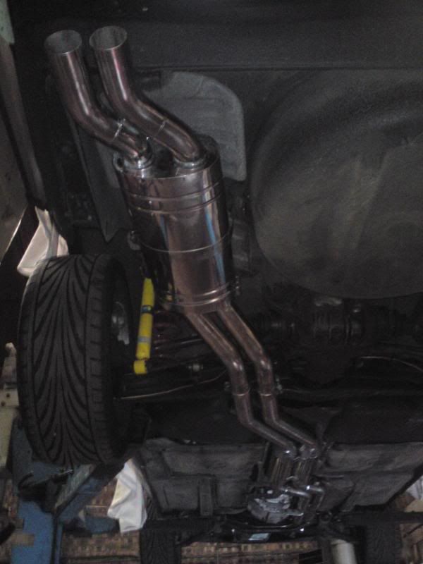

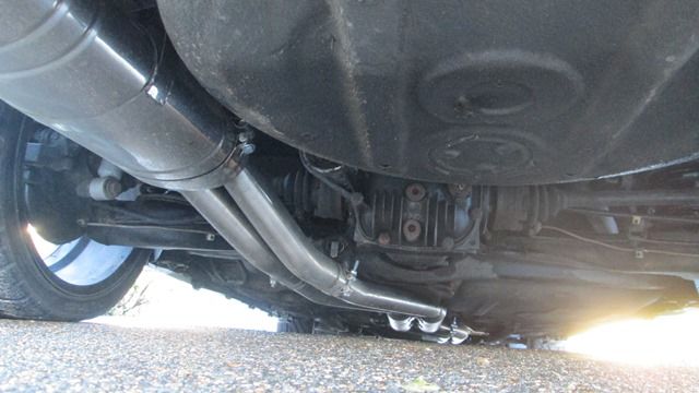

So the Fritz bits system is now installed, The manifolds sound good especially when on compression, fits good too and clears the e46 rack/linkage. The exhaust is boomy on idle and is glorious when doing a 0-60mph sprint!
I will have to buy a new and quieter one at some point, the bitz 'zaust could be hard to shift I expect as its unbranded and over sized. Its all good fun and I'm pleased with the manifolds.
I still need to round off the edges of the top UJ and it makes contact when cornering recklessly but ever so slightly tho, it use to rub hard with the old setup. 99 percent improvement! Hard to believe when you see how congested it is around the linkage compared to before.
As for hp gains I'm not sure, my car was dyno'd at 194 hp before remap, non vanos m50. Pretty good for a 120k miles engine. May have given 5-8 hp?

Looks great man. How does it sound? And is the back box small enough to tuck up inside the standards rear valance?
- Posts: 28649
- Location: Staffs
If I were you id keep the exhaust and swap the engine
They are really designed for larger cc engines, hence the oversize tube, must admit it sounds great on my car!
JF008
- Posts: 631
- Joined: Tue Jan 17, 2012 11:00 pm
- Location: Fort McMurray
Yeah it fits under the valance and has straight twin tail pipes, sounds loudSteSE wrote:Looks great man. How does it sound? And is the back box small enough to tuck up inside the standards rear valance?
Never mind the cut out I had the valance repaired and repainted but have no better pics at the moment.
- Posts: 28649
- Location: Staffs
Ste the fritz fits a chromie perfectly!
Might be some more pics in my thread but this is all I can find at the moment
It does sound different on a 2.8 to my Alpina 3.2 donkey, a bit on the loud side yes, but nevertheless its a great piece of work and IMO a bargain exhaust
