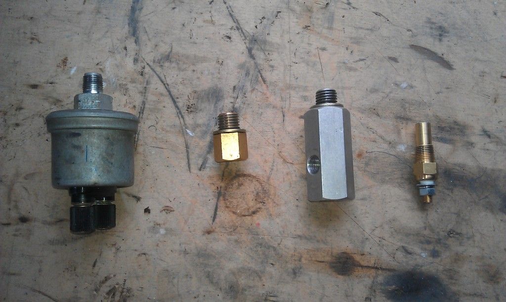

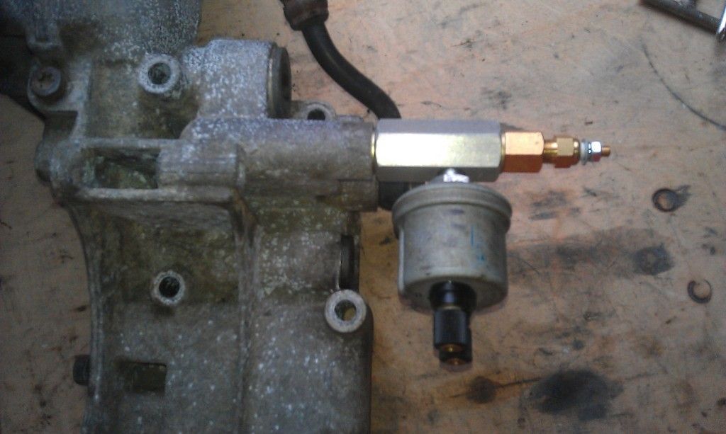

Hope this helps, if you got your gauges off eko then there the same as i have.
This is how ive set it out.
Mon Aug 27, 2012 4:31 pm
/\ thats the proper way to do it 8)

That's the shizzle im looking for...
Where did you get the bits from Mr M1K3

I got the T peice and brass adapter from my local motorfactors £19 and the temp sender £8 eBay and was given the pressure sender. :cool:
