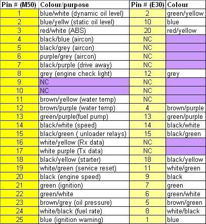

http://www.e30zone.net/e30zonewiki/index.php/M5x_Looms
the only wire i was unable to connect was pin 20 red yellow.

The red/yellow on pin 20 is the switched power feed to the cars ABS. If your car doesn't have ABS, or it's of the earlier type with a silver relay to the right of the ABS ECU, it will be irrelevant.
Green/purple on the M50 loom to green/purple on an E30 engine loom plug is correct, but the wire is purple/red in the E30 body socket.
