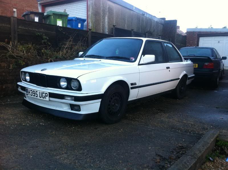

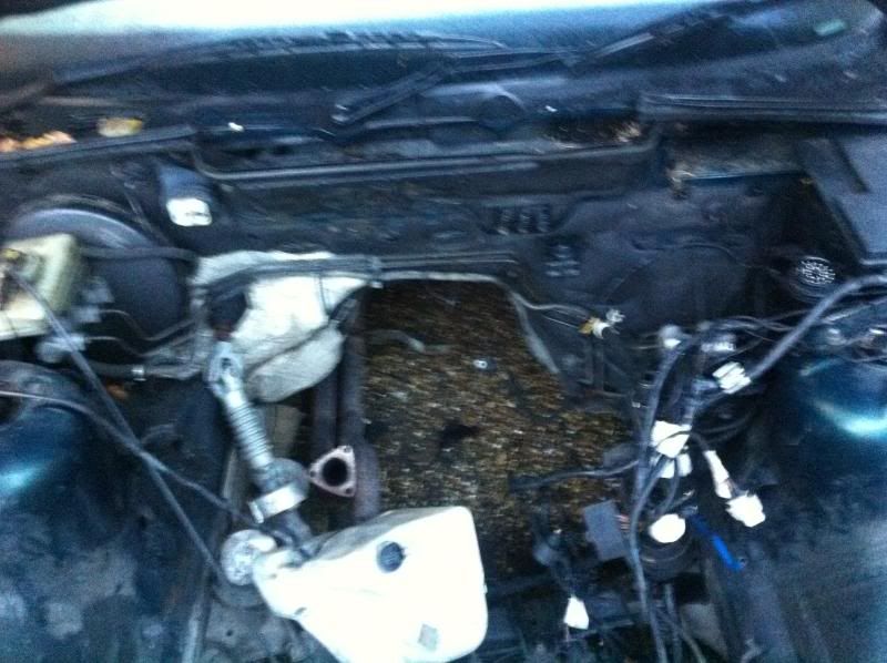

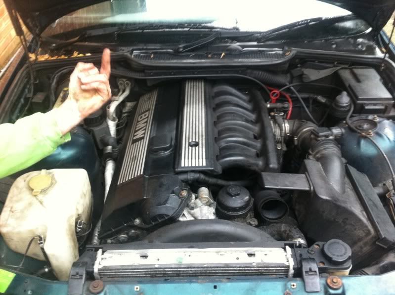

few pics as to how far ive got so far
m52 engine
witha rather helpfull friend lol
engine out after freezing my arse in the pissing rain
318is in need of some wheels.... and 6 cylinders lol

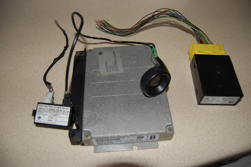

right been taking the ews out and quick question do i just litterally just cut the unit out or do i need to go through all the wires and seperate?
wanted- all parts for m52 conversion
Jozi
Posts: 3076
Location: Dublin, Ireland
Post Thu Dec 09, 2010 6:50 pm
There's 3 or 4 wires on the ews unit, cut them so that you have as much wire left on the unit as possible. Thats what i did anyway, the wires go all over the place behind the dash.
Post Thu Dec 09, 2010 7:23 pm
This is what you need to rape from the donor car dude

excellent cheers guys thats what i ended up with in the end after abit of head scratching
