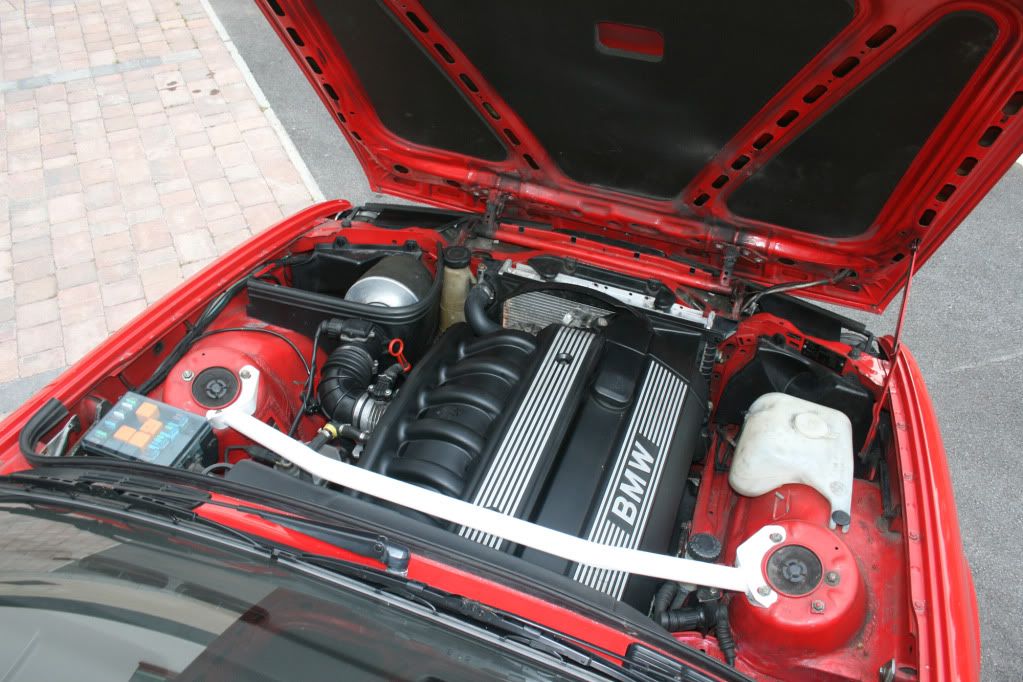

Im sort of being forced to use a cone filter but will be either making or buying (there was an epic looking one for sale) a heat sheild with a bonnet rubber seal on it.
You don't have a pic of yours do you cook?

Fri Oct 01, 2010 4:49 pm
ross_jsy wrote:You don't have a pic of yours do you cook?
