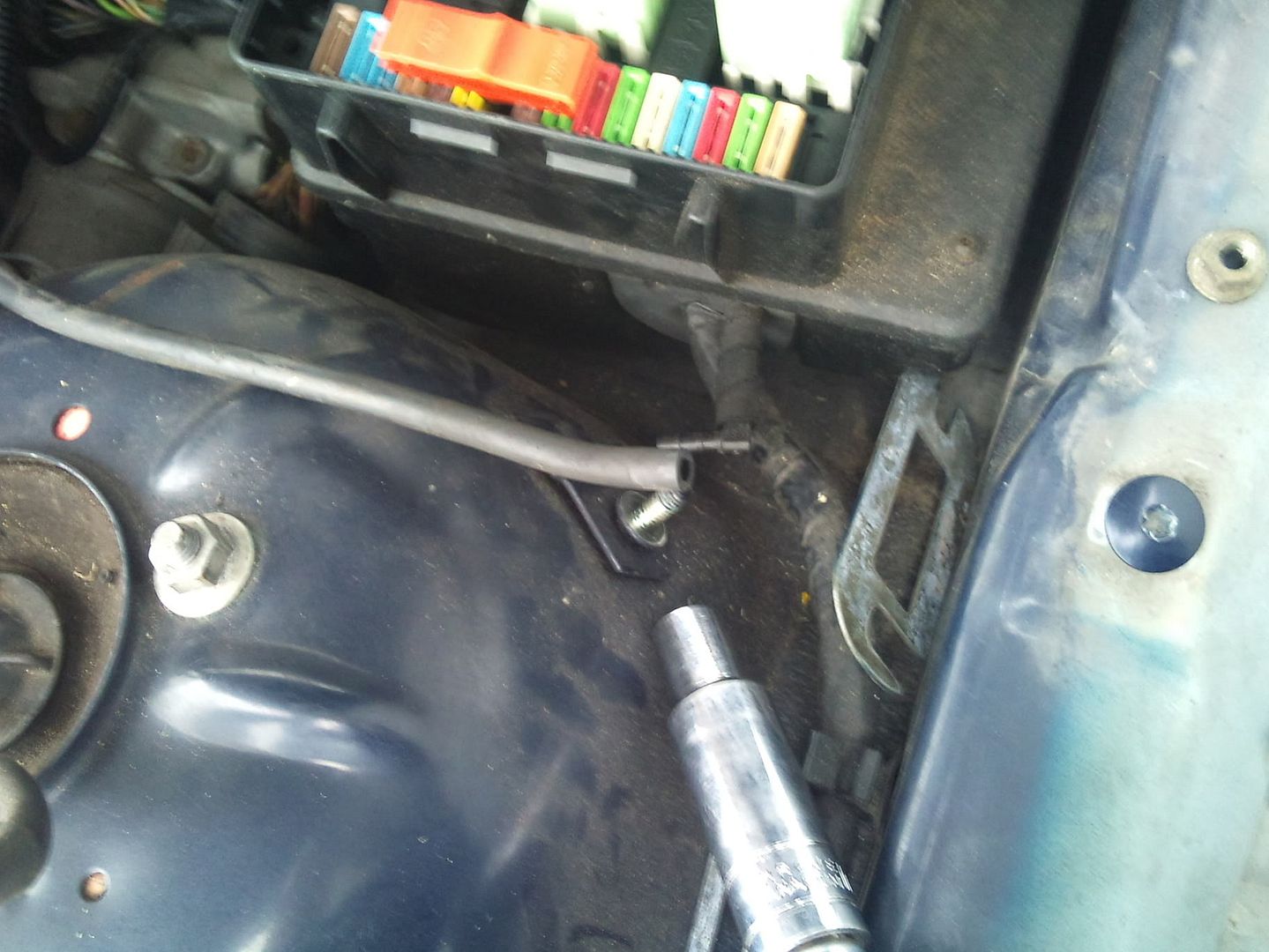

1. What is this vacuum pipe for? and where will it be connected on e30?
Also I see this on the top rhs of engine it has a cable running from it - is it needed? where do I mount it? & how do I wire it in?
I've got a 525 inlet and boot - so that should do away with it - no?DanThe wrote:Dont worry about the vacuum pipe, it probably wont be needed.
The motor is for the ASC secondary throttle which is not needed, just unbolt it from the throttle body and fit a standard boot
