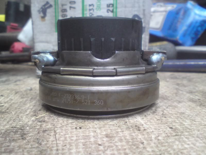

I have one running OK with the standard release bearing - built before I joined the zone. Probably some less than ideal angles in there, but it works.
Sat May 15, 2010 1:11 pm
Ive never had a problem with standard M20 bearings before either.
Here is a modded bearing I made yesterday, for a different gearbox
