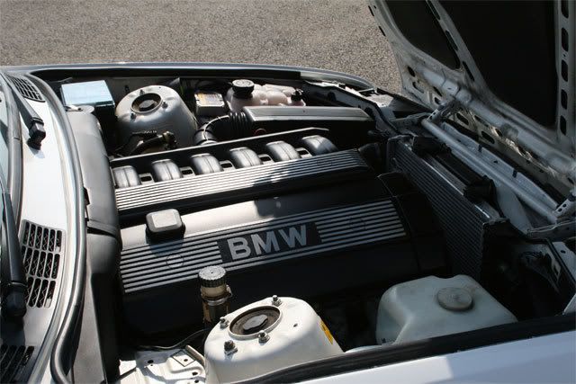

Some pics of my old setup

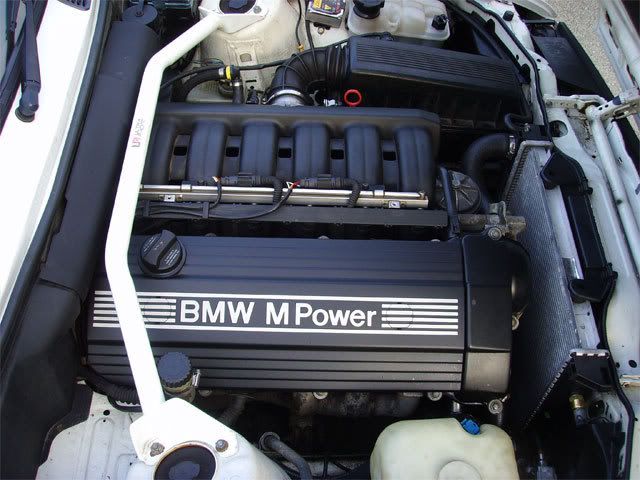

That looks really good. Can I do the same for the S50 air box? Or is there a better option?

hum , Dan that looks like it grew there

No, for both questions.RoadHazard wrote:That looks really good. Can I do the same for the S50 air box? Or is there a better option?
Ive got one here to try with the S50, but it just wont fit.
The only option at the moment is a decent cone filter and heat shield. You can use the S50 airbox, but its a lot of hard work moving the ABS pump etc.

E36 airbox is a much better way to go, the intake hole is much larger and in a better location for the E30 grills, on basic road testing I was getting up to 10° cooler intake temps than with the M30 box
Pics-
Pics-

is that actually from the e36 or have you modded part of it? I noticed that you need to cut part of it away or it catches on the headlights and you appear to have an e39 style one that doesnt have the "bar" pointing out of it if you understanda what i mean?
- Posts: 28649
- Location: Staffs
Its just an early E36 box, I think they started coming with the extra bit when the M52's came about
It is close to the headlamps but not touching
The E39 box is fooking huge, it doesnt look that big when in the bay but the underside of it goes off into the wing and all sorts

This is the air box im going to be using on mine when its done just got to talk nicely to Dan to make me a braket up for itDanThe wrote:E36 airbox is a much better way to go, the intake hole is much larger and in a better location for the E30 grills, on basic road testing I was getting up to 10° cooler intake temps than with the M30 box
Pics-

That is not an M3 air box is it?
