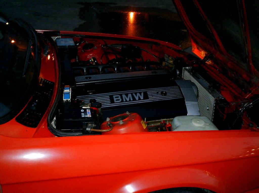

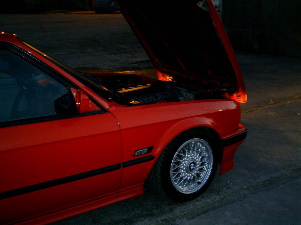

from what i remember you cut your pleneum for your s50 around the golf servo in the standard position.wat mastercylinder?and any pics,please thanks
as repayment here is some m50 pics lol
S50 is alive :-)

^^ Buster moved his servo over around half an inch and used the 25mm Audi master cylinder. All the information is in his thread here

Had to move it half an inch as Dameon said because i wanted to minumise the amount taken from the plenum chamber.
Im thinking of taking it off actually and re doing it.Maybe the same as Dameons,or servoless.
