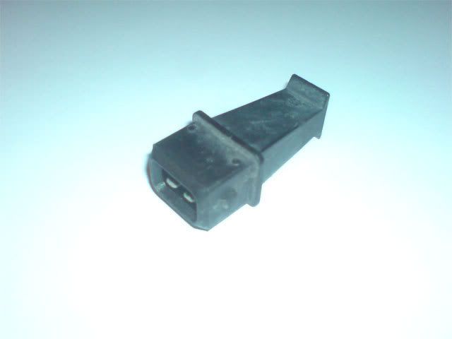

Yet more developments!
Whilst pulling a rather cheap LPG system from a J plate 325i coupe today winkeye
I noticed this little blighter in the plug that usually connects to the breather valve
It is a resistor used on early non-cat vehicles, its listed in realoem, No 8 here
As any M50 convertor with an engine warning light will know, not plugging the valve in throws up fault codes.
So if you want to avoid the fault codes/warning light and dont fancy soldering, this would be ideal 8)

Nice one, Dan! And only £3-50 or so.
Even gives the value of the resistor at 1000 ohms. Think I used 680!
Tue Sep 25, 2007 9:42 pm
I used a 68 8O
It works though :D

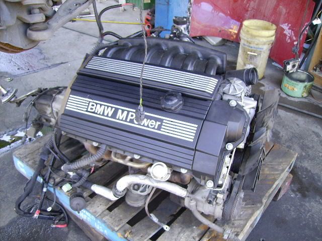

just wanted to know if an m 50 engine will fit into an
1987 e30 325e stick shift
i have read parts of the 28 pages
but im having a hard time figuring out all the things i would need to do the swap
something like a
1997 BMW M3 S52 3.2L OBD II Engine (complete with alternator, starter, power steering pump, exhaust manifold, intake manifold, and ac compressor) -
Transmission 5 speed manual. (came out of the same car)
ECU (bmw m3 e36 OBD II engine body computer/module)
Engine Wiring Harness
would that fit?
i could purchase this for around 3500 us dollars
is this a good price for all the things listed above?
here is a picture
http://i49.photobucket.com/albums/f252/ ... INE002.jpg
so i would need that engine a servo not sure what that is but i believe its the brake booster here and a new radiator or an intercooler and an oil sump and engine mounts and transmission mounts
once im done buying all the things and have the car running with the new engine how much do you think the cost would.
if any one can point me in the right direction with links or just information i would really appreciate it

^ The S52 engine is a US designation motor. Although it is based on the M50 it should fit in the same way an M50 or S50 does. Yes it would fit in your 1987 Manual.
Assuming you are in the US, your obviously talking LHD here so there will be challenges to face that may be different to ours here with RHD vehicles. I would like to think that the manifolds would be easier in a LHD for sure.
Have you tried http://www.e30tech.com/ that looks to be a little more US biased.

The engine and box will fit in relatively easily. The problems arise when you try to fit the manifolds, etc., as the spaces for these are partly occupied by bits of E30.
There are many and varied solutions for these problems which are debated at length in this thread, but since your steering wheel appears to be on the wrong side of the car, many of the problems, and their possible solutions, are different or not applicable.
