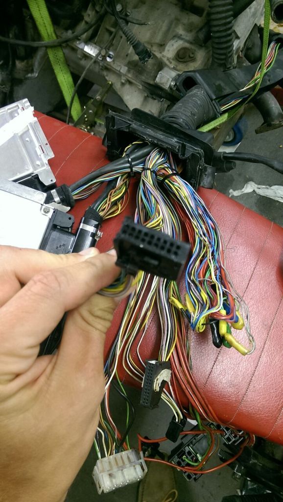

it was removed from a 728i Auto, which seems to have caused me some problem that i didn't foresee. i have been reading about this swap for about 2 months and thought i had it sorted but today i found the motor mounts are incorrect so i have had to buy e36 mounts. my main problem is that i cant find a x20 plug on the loom! it hasn't been cut only the plug for the auto box.
i will add some photos when my brother sends them over to me

<a href="http://s1214.photobucket.com/user/20027 ... 8.jpg.html" target="_blank"><img src="http://i1214.photobucket.com/albums/cc4 ... 52b288.jpg" border="0" alt=" photo m52b288.jpg"/></a>[/img]

Posts: 28646
Tue Jul 07, 2015 12:37 pm
E38 doesn't have an X20

ok thanks for the reply, what should i be looking for, im struggling to find any information on it.
the e38 728i wiring diagram isn't on 'wedophones' is there a manual i can buy like haynes but with good wiring diagrams?

Wed Jul 08, 2015 11:57 am
These are the 4 plugs i cant figure out which to connect to the c101 plug?

Posts: 28646
Thu Jul 09, 2015 1:27 pm
schofield wrote: is the m52b20/b25/b28 engine loom all the same?
No, some are some are not, there are also at least 3 different loom versions for M52 so check everything before you commit to a loom
