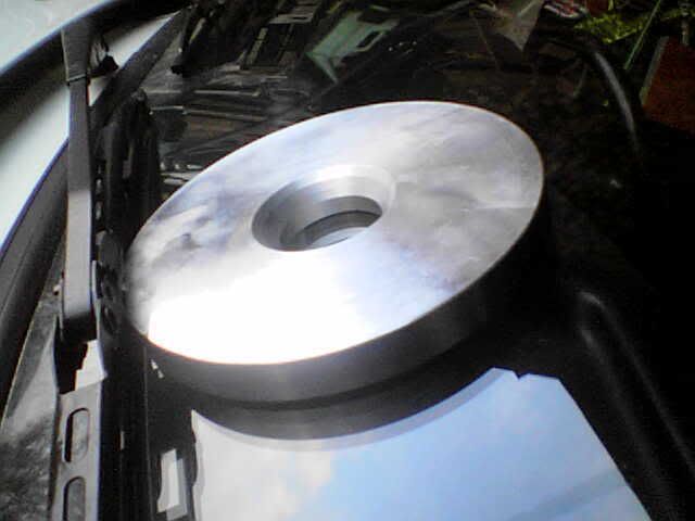

Wed May 05, 2010 8:31 am
Then pack the rear up
I used these

Cook318IS wrote:I guess you got them made up and that you can't buy them? I presume that they sit on the bottom of the spring? I like the idea though :D
Just looking into it properly and the only 50mm springs are for the 325iX - there shouldnt be any difference though between them and normal 6 pot springs should there?
Anybody with a lathe can make them, those are 20mm, you can get the rubber pads up to 10mm

I feel a job coming on for the first year apprentices at work :D Have you got any dimensions handy?
Wed May 05, 2010 10:23 pm
I just took a trailing arm in and said make plates that fit this :)
