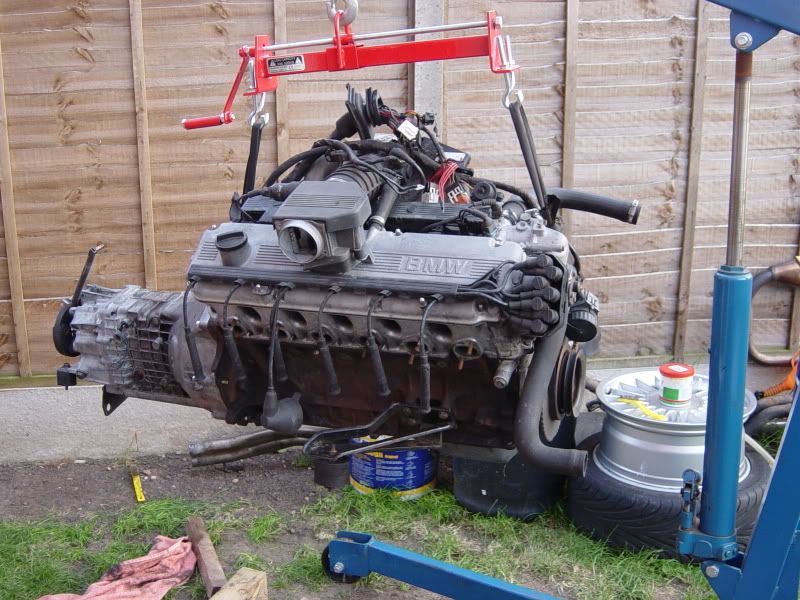

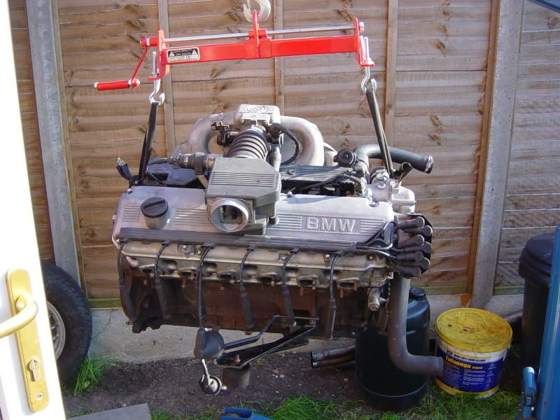

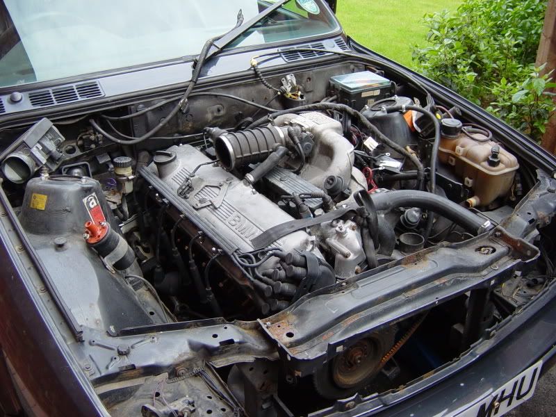

Finally got under way (now the weather is good) with my conversion, I'm one of the unlucky ones without a garage only a driveway..
Engine out
Auto box removed
Manual fitted
M30 in place, unfortunatley I had to lift it back out to alter the bulkhead to allow it to sit right back. My mounts are copies of the e30.de ones and I thought the holes were P2 and P3, they weren't and I reckon it's in about P2.5ish :D
I'm doing the whole project a bit backwards, I'm fitting it in my shed 325 so I can spend as much time as needed doing everything and once it's completed it will be removed and swapped over to my better 325

looks good! i didn't have a garage either (though i do now!!!!!) :D i did mine partly on a mates grandads farm and partly on my dads driveway.
how easily did the engine go in from above? i put mine in from below. having a balance bar would have been handy though...

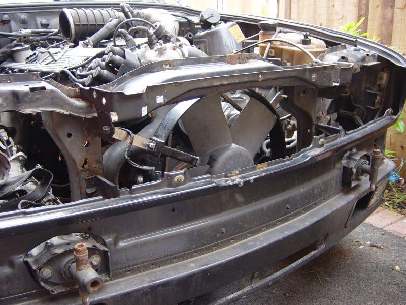

Does the radiator fit ok now ?

I plan to have it finished by the end of this month, it's very dependant on the weather though :?
Very easily took about 45 to 1 hour on my own and yes the bar did help a lot. It was just a pity that I had to take it back out to alter the bulkhead. I had the engine in and out three times that afternoon and now the screw thread on the balance bar is knackered :evil: It will be going back, I thought buying a branded one, it would last.
Plenty of room although I have a feeling the engine is sitting a little high for the bonnet to close, I'm using new M20 rubbers, this is correct isn't it??
Yeah, M20 rubbers, they always look a bit high, i guess the highest thing on yours will be the AFM ?

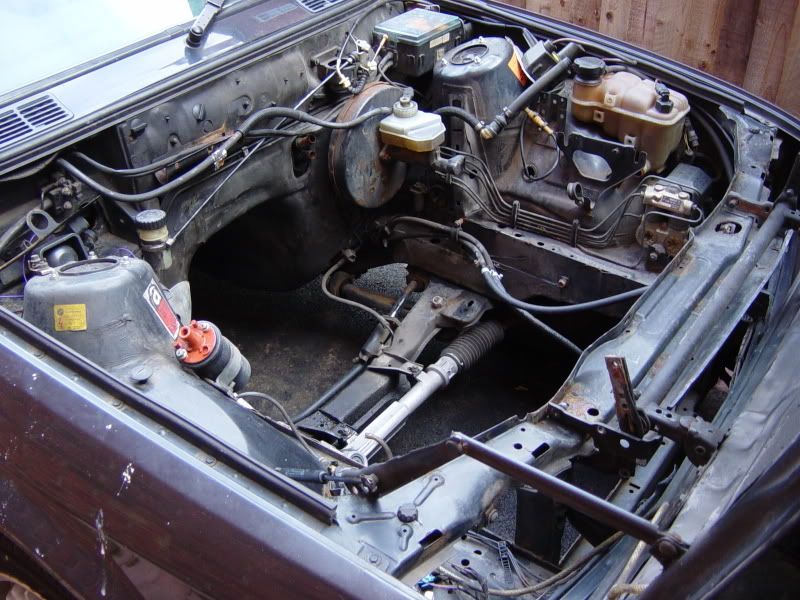

i'm just about to start doing mine once i've cleaned the new engine up, how much of the bulkhead needs tobe cut out so the engine sits right and does the m30 head sit in the same place as an m20 head does,if so i can mark the bulkhead before i take the old engine out!!!! saves putting the engine in two/three times.

It won't need cutting, it might a tap or two with the hammer but it depends what position the engine is in and how you fit the engine i.e. gear box and engine bolted together or separately.
You also might have to loose some sound insulation

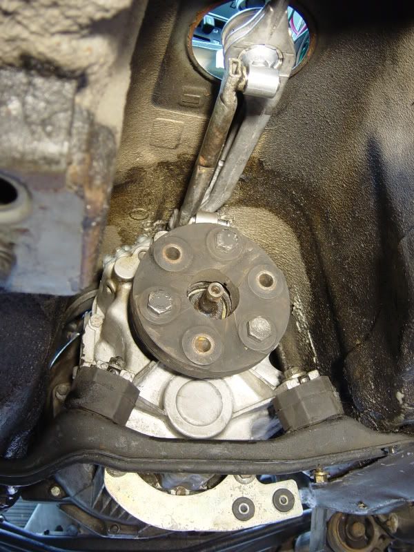

mine didn't need ANY bashing at all. it is very tight though, the bellhousing bolt heads are pushed into the sound deadening! the front is very tight too. 5mm further back would be ideal.
as i fitted mine from below and it took half a day to get it in (with 2 people), i thought it would be fine where it was!
regarding height, i used E30.de mounts, redrilled for P2.5 and with new OEM mounting rubbers. loosening the mount / block bolts allows a fair bit of fine tuning (5mm in each direction maybe?). my sump sits 3mm off the rack and the TPS rubs the underside of the bonnet. this is an auto TPS so maybe it's a bit larger?
if you're lucky like me and get it in at the first attemt, make sure you move the brake pipes a bit first as they're very close to the rear of the head. pulling the rocker cover off and trimming the 4mm x 15mm (ish) lug off will give valuable clearance.
once mine is back on the road, we'll have to have a 335i meet somewhere! :cool:

Thanks for the tips mate, the holes in my mounts are really tight - no room for any adjustment so I'm thinking I could open up the holes a little. My engine still has the auto TPS on and does look like it's the highest point of the engine.
When I fitted the engine I did wonder about grinding off that tab on the back of the head.
A 335 meet would be most excellent :cool:
I found a link in your thread to your 72 conversion photo's, looking at your mounts I'm definetly in P3, I just hope I don't have to much of a problem with my M3 prop...
BMW F31 335d xdrive
gareth
Posts: 11005
Post Tue Jun 13, 2006 12:48 pm
the prop should be fine mate. i could probably move mine back 20 - 30 mm with the M3 one.

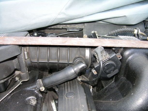

My tps isnt that high its a manual one.

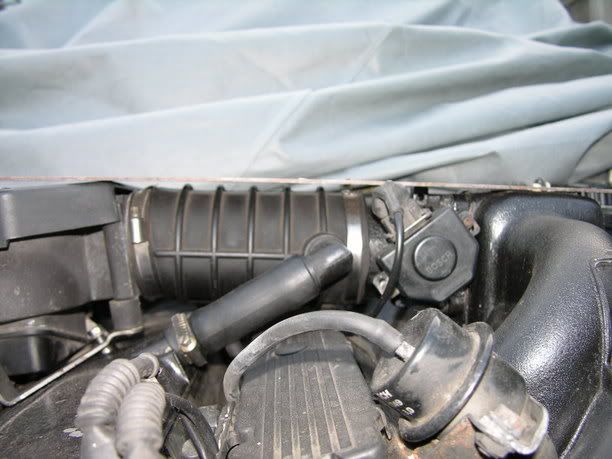

The highest point on my engine is the bloody TPS and it touches the sound insulation
By much ?
Might be OK ?

mine has rubbed through the sound deadening! if you close the bonnet and then push on the area around the TPS, you should be able to feel how much clearance there is. mine is about 2mm!

I'm going to remove the auto TPS and fit the manual one kindly donated by Andy.. cheers mate :thumb:
I reckon with this one fitted it will just about touch the sound deadening stuff, there is actually quite a big difference between the two. I'm just going to have to try and work out the wires, on the auto there's about 5 or 6 8O

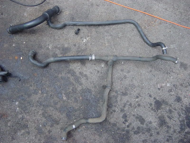

Little update: all the wiring is done :D and the ECU is where it should be although it is backwards. I've fitted my electric fan and have sorted the coolant hoses, I used the E34 top rad/ heater hose, E28 bottom rad hose and a combination of E30 and E34 thermostat/heater hose. Tomorrow I'll fit them along with the rad :D and have a play with the shifter linkage, fuel pipes and brake servo vac tube.
Then all that is left will be prop/LSD and exhaust :cool: oh and actually getting it started.. probably take longer than it has to fit it all knowing my luck :?

charlE30 wrote:have sorted the coolant hoses, I used the E34 top rad/ heater hose, E28 bottom rad hose and a combination of E30 and E34 thermostat/heater hose.
make sure you connect them the right way round. this means cutting both hoses iirc. if you have a funny tapping noise when you drive that sounds like an insane relay near the glovebox, then it's backwards!

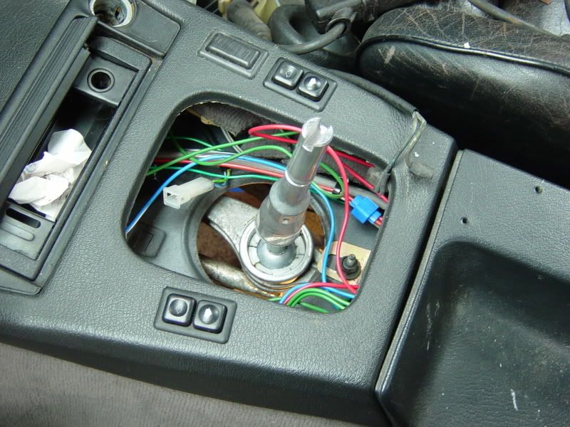

charlE30 wrote:and have a play with the shifter linkage
try the M20 linkages before cutting anything, mine went straight in!

Post Sun Jun 18, 2006 10:19 am
gareth wrote:make sure you connect them the right way round. this means cutting both hoses iirc. if you have a funny tapping noise when you drive that sounds like an insane relay near the glovebox, then it's backwards!
Does this look about right for the hoses, top (matrix) hose to thermostat and header tank(lower hose in photo), bottom (matrix) hose to rad/thermostat (upper hose in photo)

the hoses are different to how mine work... on mine, the top port on the heater matrix goes the thermostat housing, the bottom port goes to the header tank and rad top hose.
so essentially, if you connect the fat top rad hose to the bottom por on the heater matrix is should work. your header tank takeoff will then come from the 'other' side of the heater hoses to mine
this is how andy did his: (hope you don't mind andy...)
i think mine is the 'wrong' way round but seemed the easiest way to get the coolant flowing the right way through the matrix. i had already cut one of the hoses (like in your bottom pic) so cut the rad top hose feed at the same point and swapped them over. you'll probably find the hoses fit better the wong way too!
i'll email over the drawings and supplier i used...

Looking at Andy's photo my hoses will be plumbed correctly and will have the T piece hidden away under the manifold like the M20 :D
Rad is now fitted as is fuel lines, brake servo, water hoses and shifter :woohoo:
I haven't cut the linkage although idealy I should as it's a little out:
I have checked that all gears can be selected and it works perfectly without fouling anything. It makes me laugh when you read on various sites about having to use a custom or M3 gearbox hanger, the E30 is perfect :D as is the downpipe bracket..
