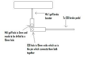

abit of a update on the MK1 golf brake booster. to who ever is changing to one of these, there is no need to mod the pin, you can bore out the mk1 golf plate to a 10mm hole instead of making a thinner pin which rattles about the E30 rod.
ill take some pictures later to show what i mean

here we go abit of handy work with paint
